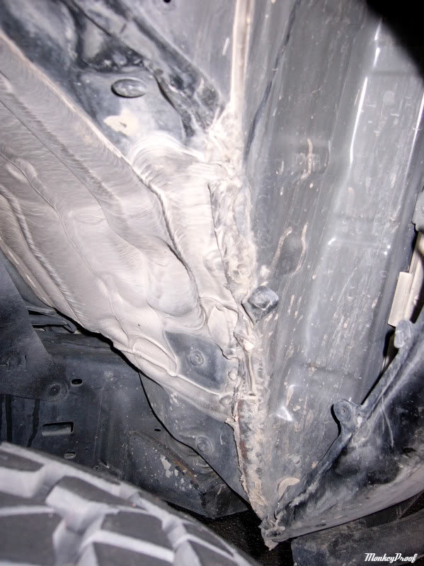

    this mod is necessary to clear 33" tires when the wheel is at full stuff and the steering is at full lock.
    it's an easy enough mod that can be done on the trail haha, just ask dtrujillo63!
    here's what mine looks like..i used an air hammer and a BFH..
    easy to do, start from either end (top or bottom) and work your way to the other side using a BFH. once you get the pinchweld to fold over it's easy, the bottom portion of the pinchweld is more beefier then the top so it will take a bit more effort.
