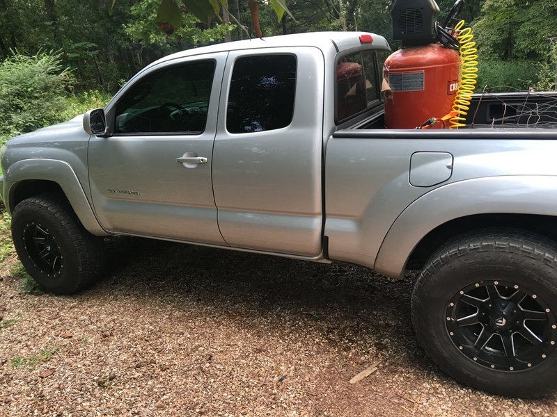

    So I recently purchased a 2008 Tacoma ext. cab TRD Sport, about a week ago and already have bought some 17x10 fuel Mavericks and a set of 295/70R17 Nitto Terra Grapplers. I was curious if anyone ran a set up similar to mine, and what amount of trimming I would have to do to get them to fit on stock suspension. I have a 2" leveling kit ready to put on but I would rather fit it as is, even if it requires trimming. Rims have -24 offset, any help is appreciated, sorry if I pissed anyone off with my ignorance.

    You'll have major trimming to do. Cab mount chop, fenders and flares, fender liners, remove mud flaps, pound the pinch weld, etc.

    Did a test fit, it looks so good. Definitely too much trimming to do though, so the leveling kit is going on Monday. Hopefully will solve my clearance issues.

    Finally got the new wheels on, have to say I'm pretty happy

    Oh, sorry lol. Yes it had some issues with rubbing. Trimmed the wheel wells, and grinded down the cab mount. No more rub. I'll still probably do the cab mount chop just to be on the safe side.
