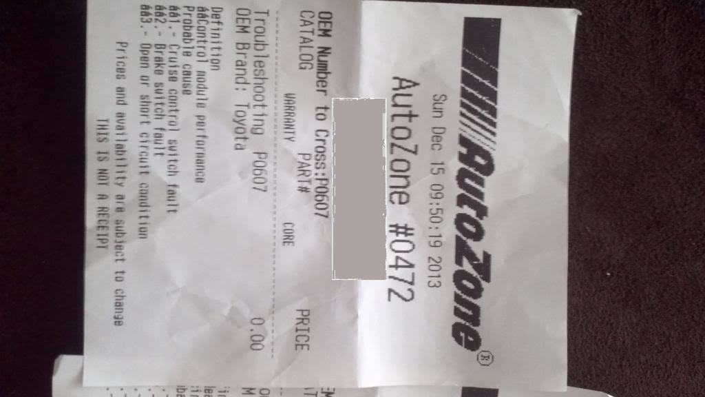

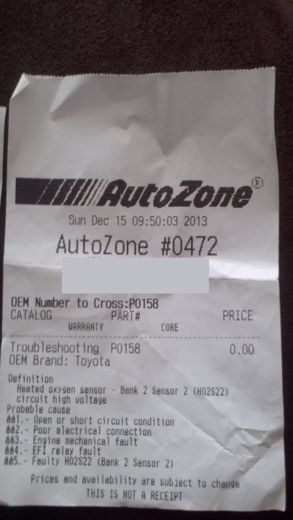

    P0158 / P0607 Check Engine and Trac Off
    Howdy Tacoma World here was this months issue, so a little back ground on my truck I have installed doug thorleys, I changed out the stock y pipe with a custom exhaust, Oh and a scanguage II is on my truck as well. I was actually pushing my truck hard through the RPMs and all of a sudden my my engine light came on with my trac off light. I reset the computer with no results. I got the code read and if you don't have a code reader auto zone will read it for you for free.
    The codes are P0158 and P0607 they indicate that the 02 Sensor (H02S22) circuit had high voltage.
    P0158
    -Open or short circuit
    -poor electrical connection
    -engine mechanical fault
    -EFI relay fault
    -Faulty H02s22 (bank 2 sensor)
    P0607
    -Control module performance
    -cruise control
    -brake switch fault
    -open or short circuit condition
    Now if you get these codes I have seen these before when I first installed my doug thorleys and had to install 02 simulators the same code will appear. Now since its been a year since I installed the doug thorelys I thought the 02 sensors would be bad. Gadget from URD indicates its normal for 02 sensors to go bad after an install.

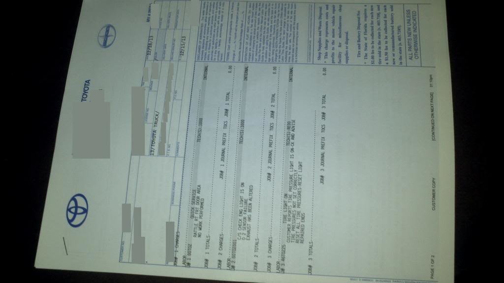

    The beggining: So I went to the dealership to get two 02 sensors. As well as fix my tire pressure gauge as I had damaged one. Heres where things get out of hand the dealership says they can't cover the work since I have modified the truck. Further more they read the codes and the technician which is not a mechanic since all he this guy does is read codes and fix a truck that way says that part of the main ECU is "fried due to my exhaust" they state the flow is abnormal and the ECU can't handle it. They price for this fix is 1,600 plus tax. I said hell no the truck is fine so the problems I had on the truck when it went in included:
    - P0158 / P0607 02 Sensor codes which set off trac off and engine code
    - Tire pressure gauge got hit through the tire
    Dealership over did it: I only wanted the tire pressure gauge fixed and 02 sensor ordered. They read the codes and told me there are major isssues after hearing the ECU being bad I was surprised to say the least. Heres the best part... The dealership says the ECU has been modified I reply with hell no and we get into what the service manager kept calling a "debate" but he was clearly arguing with me. I stated the ECU has never been touched and the only one that has touched it was the dealership itself to get re-flashed. Then it gets ridiculous!
    Scangauge OBII Super computer? If you have a Scangauge II then you might want to TAKE IT OFF your truck or prepare to "debate" because they think that the devices that connect to the OBII port ARE ECU UPGRADES!!! this is MADNESS! (not sparta) I was slight disturbed. Furthermore the service director says the exhaust work and doug thorleys allowing no cats provide to much flow which the 02 sensor can't handle which fried the exhaust portion of the ECU. He further more states that the ECU has been remapping/re-tuning to the heavy flow till it burnt out. While it an excellent theory it not the case which I will explain later.
    Note: I have been to other dealerships and they don't seem to mind the Scangauge or other readers as long as you take them out of the OBII port but it was still new to me to hear that its a ECU upgrade! HAHA
    Warranty: One thing I will always stand my ground on is if you get a lift on your truck or any other work unless they can prove it was your modification that broke that part the company and dealership have to honor their warranty. Get a lawyer if you need to because I didn't pay anything because we are right when we ask them to honor the warranty.
    The solution: So if you think the ECU needed to be changed this is not the case. Once you replace the 02 sensors you just need the code reset and everything is fixed! The 02 sensor code "P0158' sets off the "limp mode" so your traction control, cruise control, etc... will shutdown. But change out the 02 sensors get the code overridden and your in the clear. Why is this the case? Well the code "P0158" sets off a false reading that the ECU is fried but its actually fine its just the way the code is read. If you look online plenty of tacomas have had this code and changed out the whole ECU! out of there pocket in some cases. But these codes create a false reading and dealerships have read it and changed out perfectly good ECUs I couldn't believe all the forums I have read.
    The Damage: I will not name the dealership because I was very polite and while we had some stern issues I am not trying to ruin their reputation. Furthermore I called everyday since they could'nt get me an update everyday I had to call once everyday. One of my biggest complaints is the truck did not get any work done on it over the tire pressure gauge and a secondary issue of a lose metal bracket in my passenger door on Tuesday and Sunday. Why is this? Well because the maintenance team was off those days and if their going to be off those days why not have another team work on it? because I did not have a truck for 6 days due to this madness.
    Totals days in the shop: 5 days
    Total bill: zero dollars, bucks, monies, (euros?)
    Total damage to the truck after repairs: Zero (all good under the hood)
