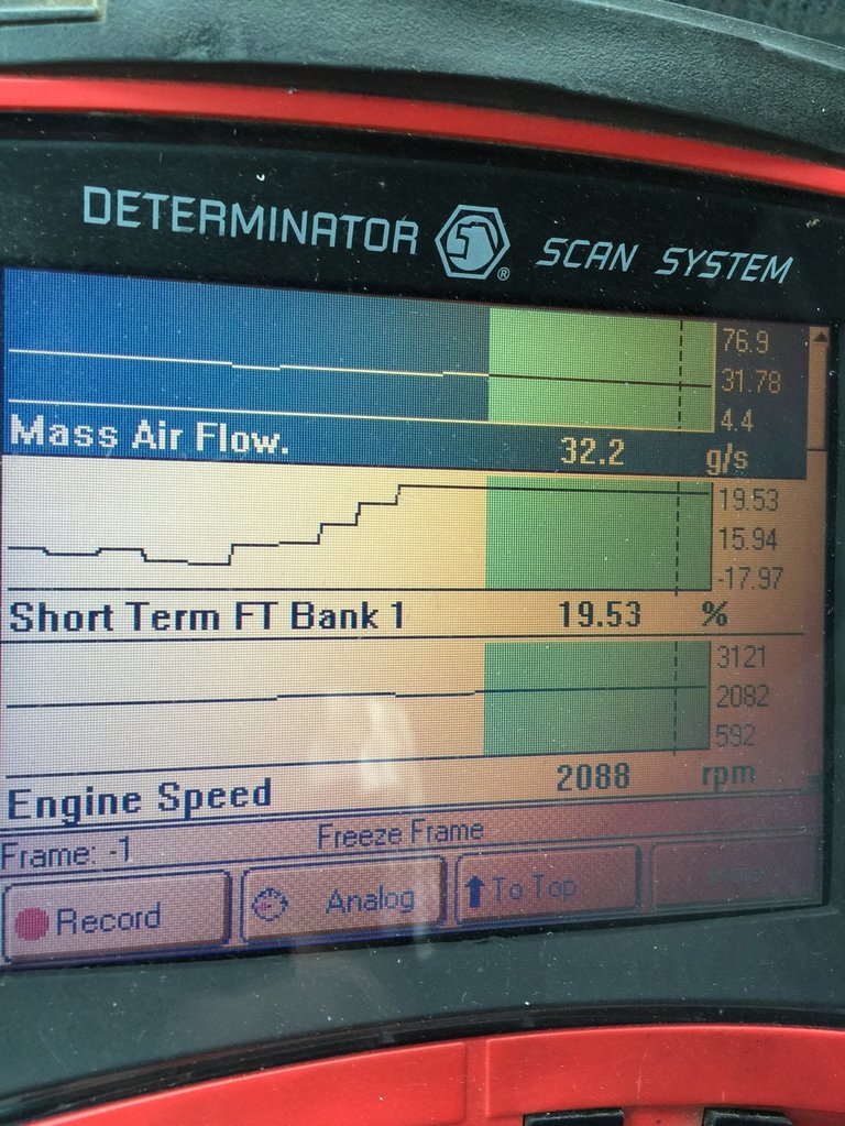

    Subject- 1999 SR5 4WD Standard tranny 3.4 with 180K on the clock.
    Problem- Code 171 almost every morning
    Whats new or been done- New cat to clear that CEL, fairly new front O2 sensor. cleaned MAF, replaced valve cover gaskets and inspected all hoses or replaced a few, new PCV, new fuel filter.
    How it runs- perfect, no shake or stall and idles smooth as can be. Fuel mileage is at 19+ with plenty of power. Couldn't ask for a better running motor.
    What's happening is a code for Bank 1 lean will set and clear every day or two. I have watched the STFT - TP - MAF data and the STFT will spike (which sets the code) when I get to about 50+ MPH and hold a steady throttle. Fuel trim works at correct numbers until it heads north to +19.5 which is the limit of the graph. When over an overpass and the engine load going up did NOT see the STFT go back to correct range but when it started down hill, the trim came down to working in the correct range. MAF was 32g/s and TP was at 18% and stayed there before and after the trim #'s spiked. Was watching data and slowed to go through a small town. STFT was spiked until I kicked off the cruise. Data was normal until about a mile after I resumed speed when it spiked again. Again, even when this is happening, the truck runs great. WHAT IS IT?

    I did that and go about 90 g/s. I read where the MAF should read .8 X horsepower. I guess that might be worth a try. I'm just trying to understand the part where the STFT changes suddenly and the MAF is unchanged. Almost like something is loosing connection on a regular basis.

    Pulled the air filter after the MAF didn't help, went out for a drive yesterday and noticed the trim went to - 20. (NEG 20) What?
    I have the intake boot off and the filter box out now. I snapped the MAF housing loose from the filter box and have JB weld setting up on it over night. I see some stress cracks in the boot but none look like they go through. Going to do a propane test today.

    Update..........
    Went to a friends shop that has a smoke machine and hooked her up. No smoke = no leaks. No smoke. As a last straw I picked up a new up-stream O2 sensor and changed it out. Old one was changed just before I bought the truck. Anyway....... it seems to have done the trick. It has a lot more response and swing than the old. Test drive shows the STFT #'s are staying + or - 4, which is great. No spikes.
    Goes to show you that if you throw enough money at a problem you can fix it.
