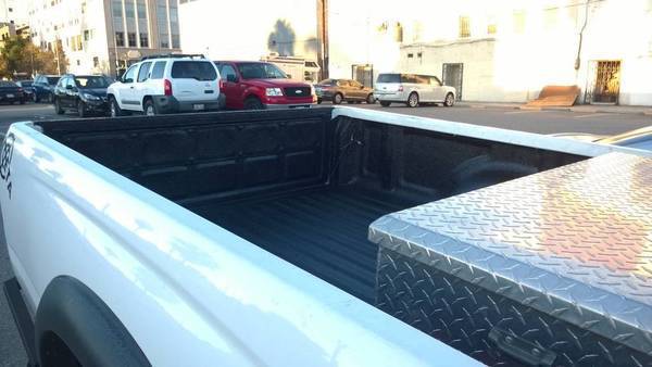

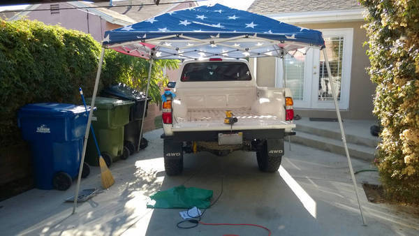

    Prepping:
    After 1st coat:
    Next coat coming as soon as this one dries.

    I'm using Herculiner
    It's pretty cool. Took the most time prepping the bed, sanded and cleaned, then did a final clean with acetone. I'm doing one last layer tonight in the bed, then might do my fenders & front chrome bumper lip tomorrow. There is a ton in the can, I'm tempted to lay it on super thick everywhere.

    The Herculiner was easy to use, and the masking tape did a good job holding the lines and not bleeding. I used the 6ft bed kit, and it was the perfect amount.
    My badges on the tailgate were getting dilapidated and looked like sh*t, so I wrapped over the tailgate to give them the embossed look. The bedliner feels solid, and I'm stoked.
    I left the top rails on the cab side & sides of the truck painted for a better h2O seal with my topper that i'm installing on Thursday.
    I'm stoked on how it looks, can't wait to get that camping shell on!

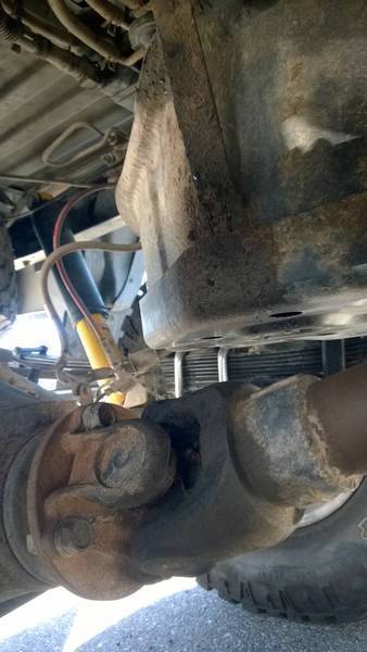

  6. Sep 23, 2014 at 11:06 PM
    #266
    Trowbocop
    Trowbocop [OP] Adventurer
    Apr 3, 2012
    #76190
    1,777
    Nashville, TN
    03 Tacoma SR5 4x4

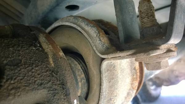

    Tire balance didn't take care of the driveline vibes at all. They occur from 30-55mph, only in gear, while pressing the gas. They don't happen in neutral, even if I rev it. I think the carrier bearing still looks pretty good. There is just a bit of play in it, not too much though.
    I'm thinking of putting on little spacers on my carrier bearing to drop it 1/4", hoping that takes care of it. If it doesn't, I'll take them out and try something else.
    I'll get a picture tomorrow of the drive shaft. I think it's just a few degrees "out of phase" Might try to remove it and align it if the cb drop spacer doesn't do the trick.
    Carrier Bearing:
    If I drop the bracket a bit, I think it'll center the drive shaft in the bearing? It might also just stay at the bottom.. There are so many different things on the forums to do. The shop said they didn't notice any vibes...they're full of shit. They said they would only replace the whole driveshaft and all the components for near $1800. Talked with Toyota dealership, carrier bearing will be $221 if I go that route to replace that myself.
    Any input, anyone?

    Dropping it helps and yea you can just use washers. But making something that rotates the bearing a touch is a better way to go to make it more inline.
    Check your U joints as well. What my vibe turned out to be. Started making noise later

    Just threw the truck in neutral and tried to move the u joints. No play at all, good news. Earlier I had the truck in gear when I tested the carrier bearing for play, it had just a bit. Just now, not in gear, it had quite a bit of play. I think that's my culprit! Going to call around dealerships tomorrow to get the best price I can. Or, I might try this route: link

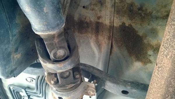

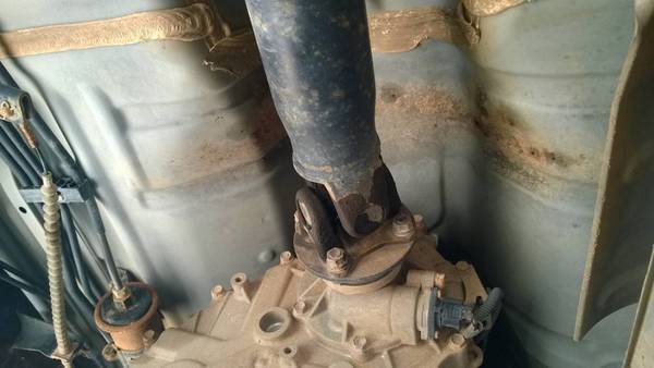

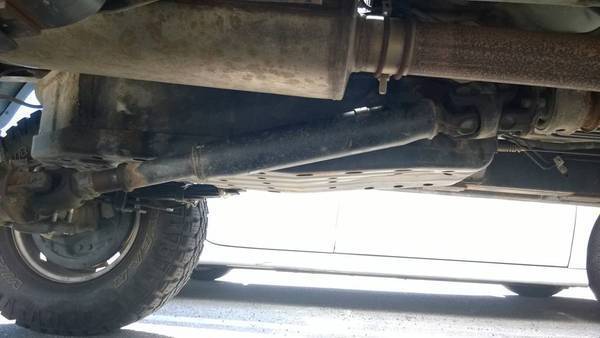

  15. Sep 24, 2014 at 4:55 PM
    #275
    Trowbocop
    Apr 3, 2012
    #76190
    1,777
    Nashville, TN
    03 Tacoma SR5 4x4
    $55/ u joint is what the dealer told me. Also, a mechanic is going to hang around until I get there today after work to verify what's going on. Hopefully it's what we think, then I'll order parts tomorrow, install next week after work on Monday. This trip to see my Grandpa & family in NM is poorly planned, wish I had this weekend to work on the truck!
    I took pics of the u joints today. Any thoughts?
    Rear:
    Center:
    Front:
    Driveshaft:

    Just got back into town, and was trying to get my drive shaft to move. Trying to wiggle the u joints around, but there is absolutely no play in them. Just my carrier bearing is the only point of movement. Feels like it has almost a half-inch to wiggle around in there. I'm going to try and convince a dude at the dealership to lift my truck up and check it out for a minute with me this week. Trip is coming up soon!

    After further inspection at the dealership, it's my rear u joint that needs to be replaced. Best case scenario! The u joint ran me $75, and I get it in on Wednesday. Going to home depot to get supplies to make curtains for the shell tonight :woot:
