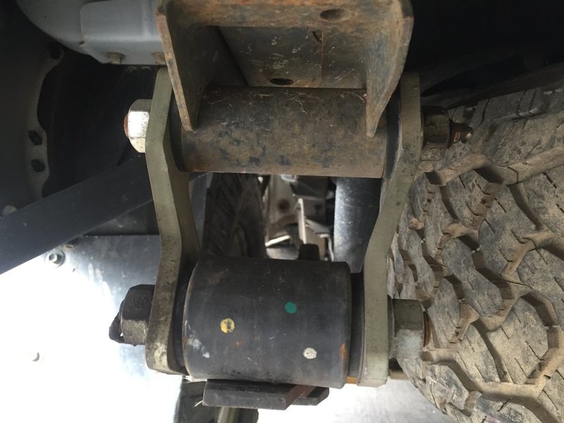

    Noticed today one of my shackle zerks went missing. Oozing a little bit of grease. It's gone from the lower part on the outside. Will call wheelers when I get a chance.

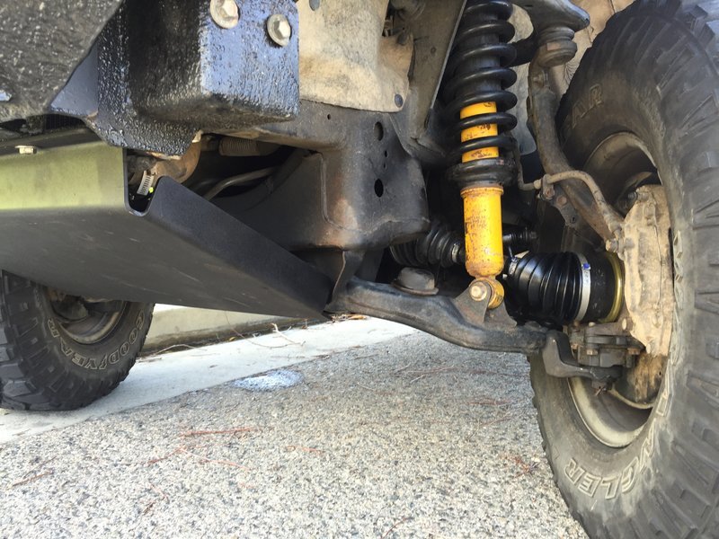

  16. May 4, 2016 at 10:27 PM
    #336
    Trowbocop
    Trowbocop [OP] Adventurer
    Apr 3, 2012
    #76190
    1,787
    Nashville, TN
    03 Tacoma SR5 4x4

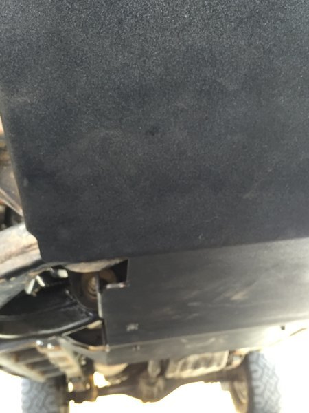

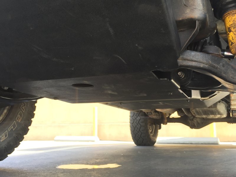

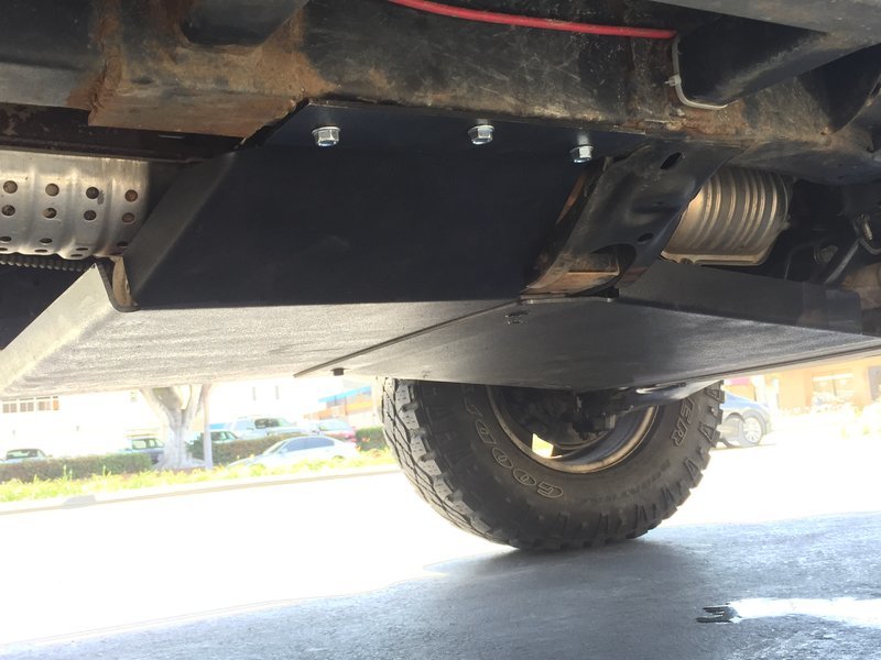

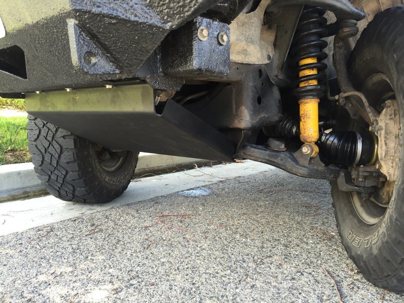

    Finally got around to replacing my cvs with remans last Saturday. That solved a lot of noise from the front- but I've still got a noise that's driving me crazy- and I'm looking into.
    It happens at slow speeds when I turn: if I turn left, the body rolls to the right, and I hear the clunk. The same happens the other way, if I turn right, body rolls to the left clunking out of right. If I make several turns in the same direction, it only clunks the first time, not every time, like it's stuck on that side? Going to try all of the things I've read this weekend if I can get a chance to get the truck off the ground.
    Things I want to go over: Sway bar links, lcas, ucas, shock mounts, ball joints, alignment cams, steering rack, & leaf spring bushings.
    I've got to make sure every bolt I see is tight. Ended up putting on my RAT skids on last weekend, so I'm not stoked on taking those off to investigate and add gear oil for what I lost while changing my cvs.
    Anyways, new skids and cvs are pretty cool.

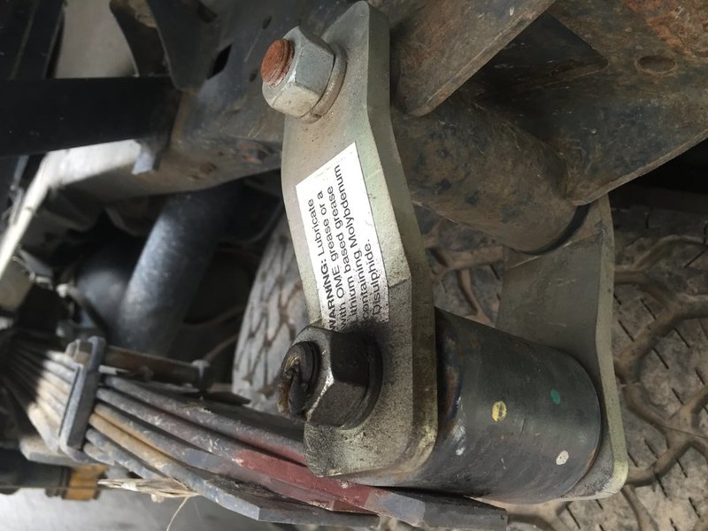

    After further research and listening while driving, I think it's the front driver leaf spring bolt & bushing. It seems the leaf is sliding back and forth sideways in the bucket?
    I've already got a new bolt/nut from the stealership, because I had to angle grind my stock one off- it was seized in the stock leaf. So I just threw in a random grade 8 bolt that has thread almost all the way up- so it chewed up the bushing (I think). I just haven't gotten around to switching to the correct one yet. The correct one has a nice smooth area before the thread starts, so I'm hoping this takes care of some of the squeaking I've got too- that's where it seems it's coming from.

    My knock is pretty much gone as of now- not sure what it was. But I did get in new Daystar greasable main eye bolts and bushings that I'll put on when I get a chance, hoping that takes care of some of the squeaks and the clunk.
