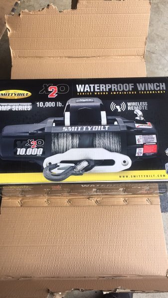

    When you plan on installing. I got the same one. Planning on replacing the grease?

    Probably in two weekends from now- this weekend going surf camping for my birthday! I haven't heard anything about having to replace the grease... What's the story with that?

    I've just heard it isn't the best and does not allow for easy spooling. I plan on replacing mine just for some peace of mind.

    It's got shining reviews on Amazon, one even says it spools very easily. The ratio of good to bad reviews is easily acceptable to me. Not planning on using it more than once a year- I'm stoked on it. Can you provide a link about the grease replacement? I can search when I get home from work if you don't have it handy.

    Had to check it out- here is a link for the xrc winch- will look tonight to see if it applies to the x20 winch too

    @Delta00 Let me know how it goes, I plan on just running mine as is- if it turns into a problem, then I'll replace the grease.

    Got my winch installed, but I can't spool it all the way in- the stupid hood latch support is in the way. I've still got about 20' of rope left. Is this something I can do without? I'd like to just cut it at the top below the bottom of the latch bracket and undo the bottom bolt.

    I ended up cutting that piece out. Fits like a glove now!
