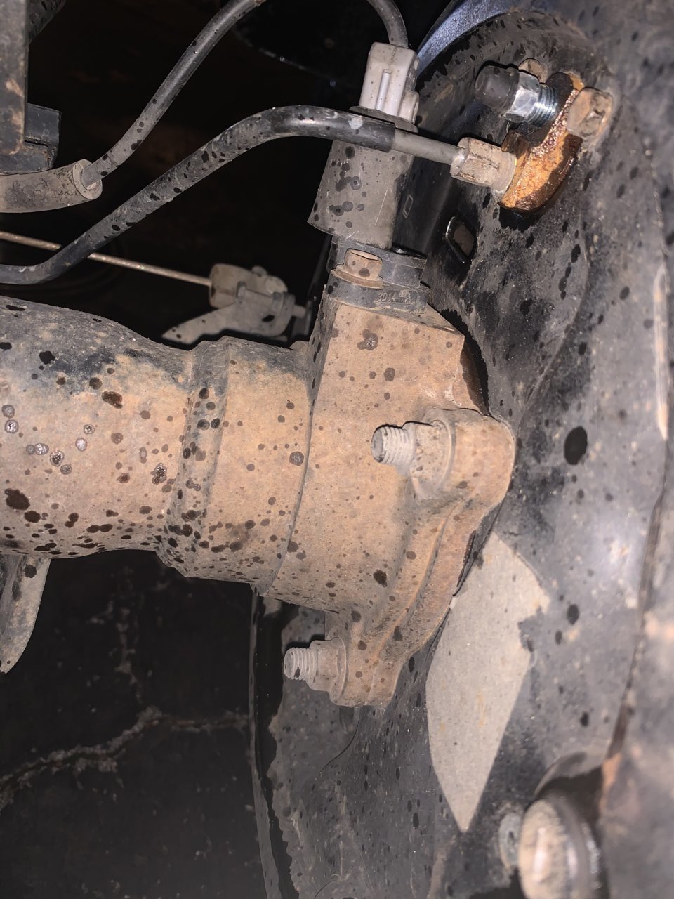

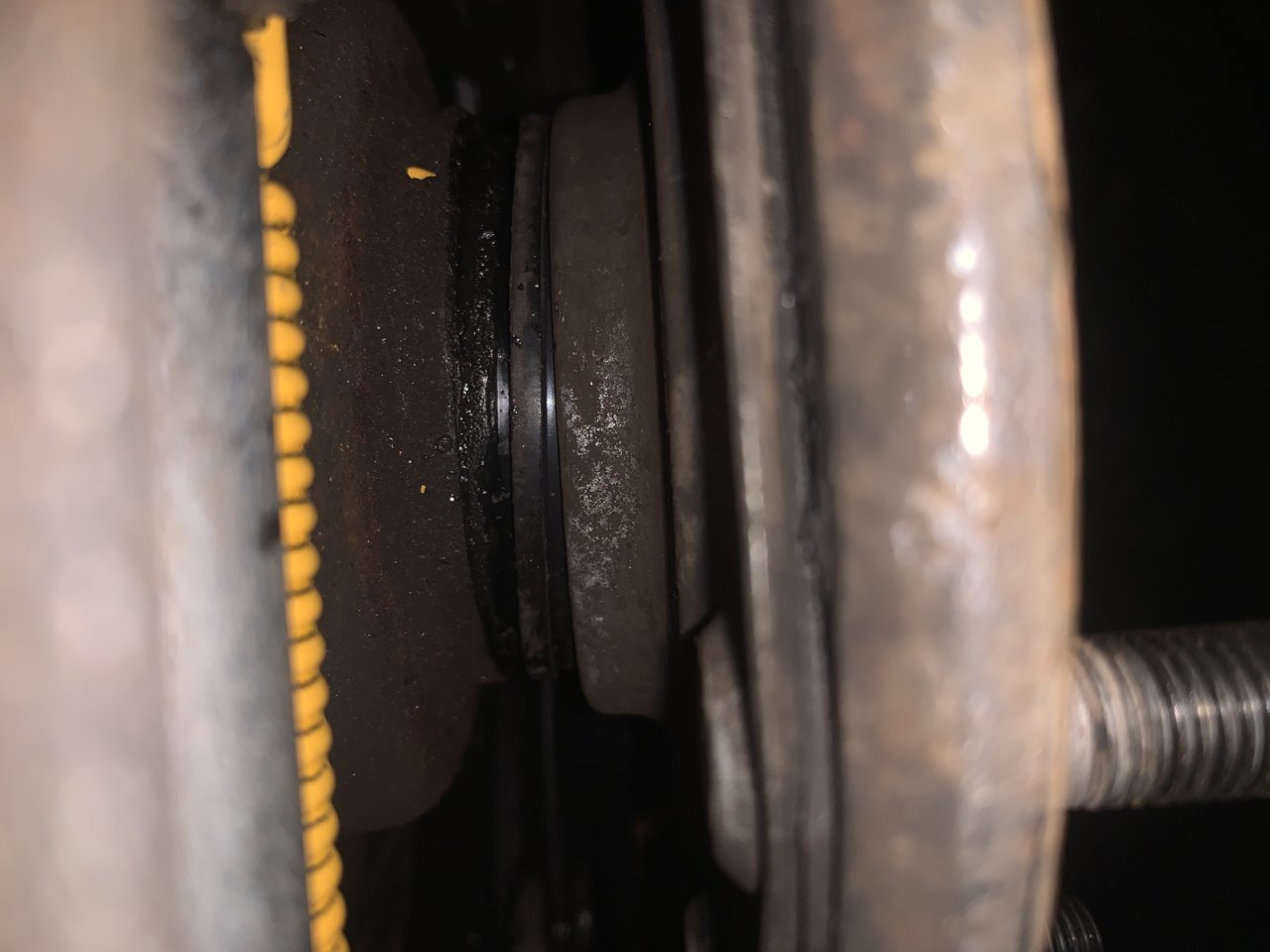

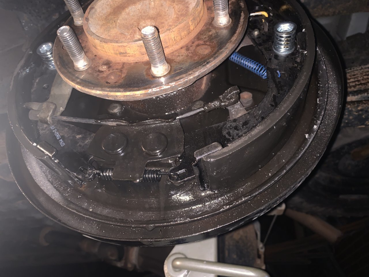

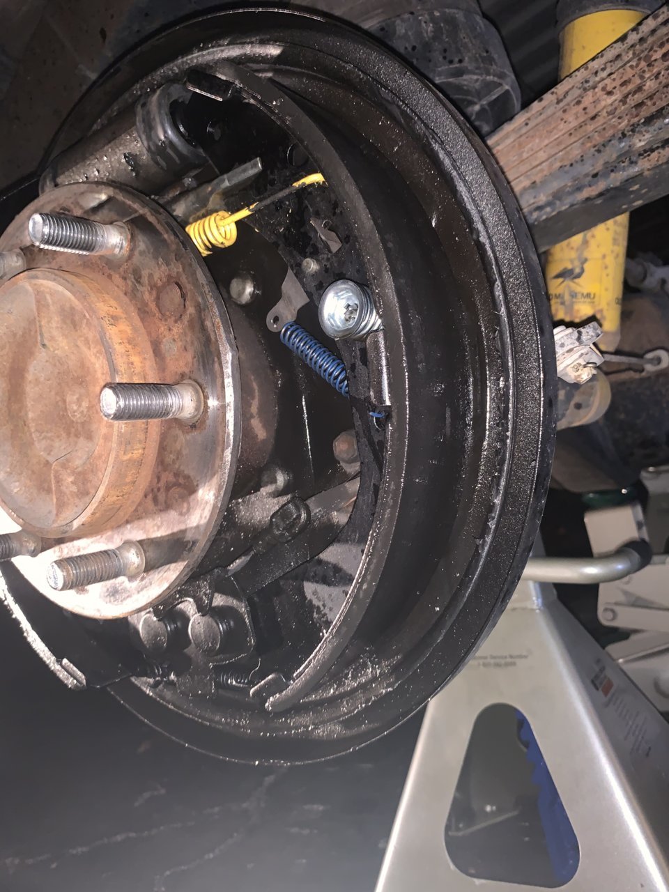

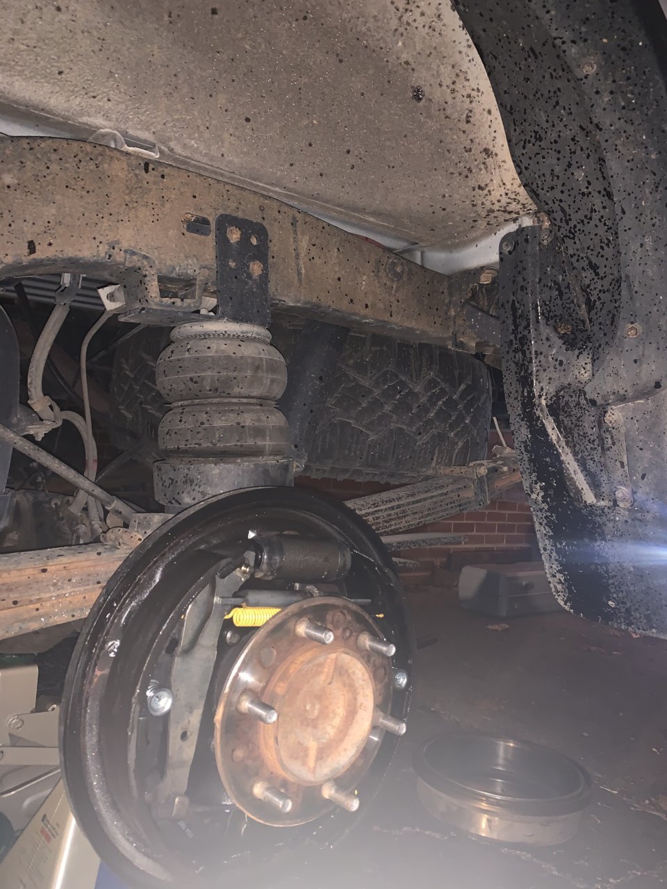

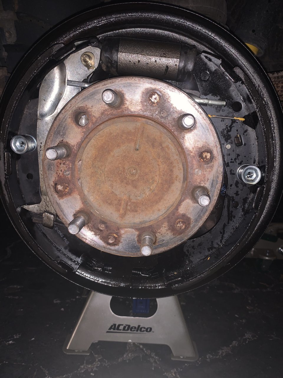

    Fun fact when gear oil gets into the brake drum it can catch on fire (thankfully I caught this before it did)
    Driver side axle seal is now leaking & you can visibly see the seal unseated. I pulled off the road last night cause I heard a rotational friction- thought maybe I over-tightened the shoe inside the drum. Got out & the brake drum was SMOKING, gear oil dripping everywhere. I waited for it to cool down (thankfully didn't actually catch on fire) and I loosened the adjuster inside the drum a bunch. Drove another 100yds & could hear something still scraping around, loosened it again, another 100yds same sound. So I'm thinking the bearing is shot & I need new inner & outer seals.
    I'm getting pretty frustrated at this point at my failed attempts. Looking into getting a new (to me) locking rear (which I've been wanting) as I'm open/open 4x4 right now. Trouble with getting a used one- is it may need the seals/bearings done too.

    It's been one thing after the other this past month I've lost 2 axle seals (replaced passenger, driver just failed) I've replaced all brakes (will need to do rears again once these damn axle seals are redone).
    I bet the rear bearings are toast- both have been exposed to gear oil and at least the driver one is growling at me.
    I've replaced Rear Diff, Transmission & Transfer Case fluids, LBJs, Transmission Mount, greased the driveshaft & u joints in an effort to track down the clunking I've got going on.
