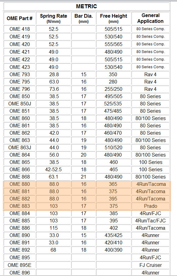

    881's are the the same height as the 883's. FYI so they wouldn't give you more lift. Might handle more weight better but no more lift.

    881s still merit about 2'' of lift on a truck with nothing up front. But 883s will give closer to 3'' on a truck with nothing up front.
    883s are the way to go granted if you going to add anything later.

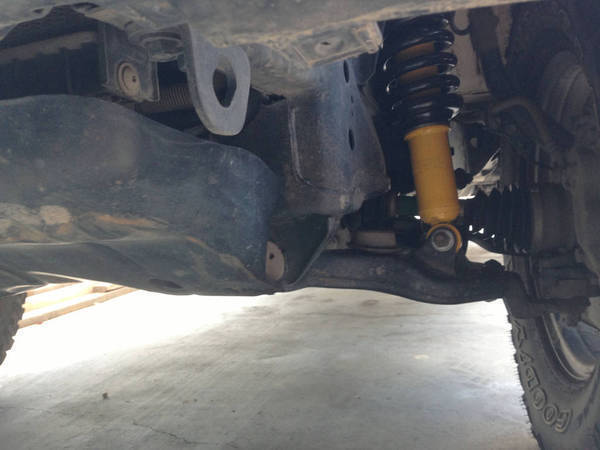

    Rides so nice, I'm not upset. I didn't want to get new reinforced cv's yet, or have to worry about their angles too bad. I'll try to get some shots of it today, including cv angles. Diff drop is going in on saturday no matter what though.

    Well technically the 883s would give you more lift, because they don't sag to the lower level that the 881s will...:stirthepot:
    Since they are stiffer, they stay higher- might not settle as low as the 881s, and handle weight better and not settle as low. Hence- moar lift :D

    Not trying to tell you 883 are the wrong choice. Just pointing out the specs. Without question if you plan on adding a bunch of weight to the front of the truck the 883 are the way to go. Personally I prefer similar lift height but a softer ride so I went with the 882s which IS the only way to go.:stirthepot:

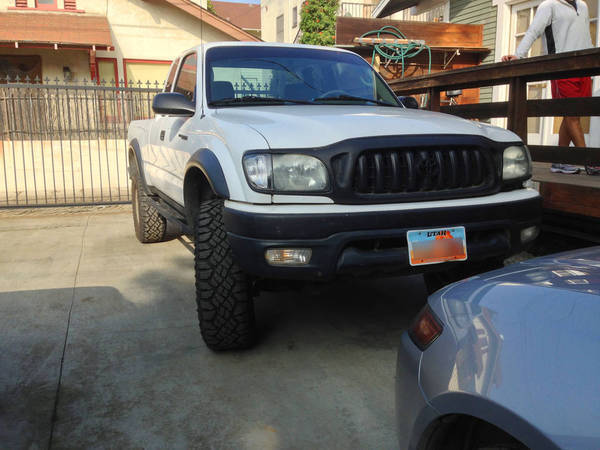

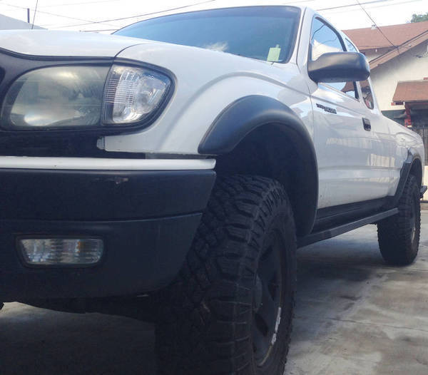

    Wow, the new iPhone does horrible in lower light conditions. All my previous photos before lift were taken with my droid x2, and they weren't this bad....sorry, dont have a sick dslr

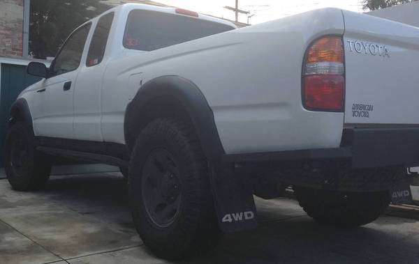

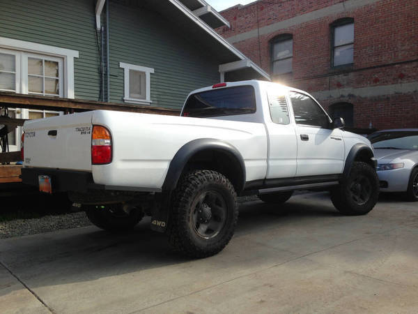

  11. Dec 8, 2012 at 3:23 PM
    #171
    Trowbocop
    Trowbocop [OP] Adventurer
    Apr 3, 2012
    #76190
    1,779
    Nashville, TN
    03 Tacoma SR5 4x4

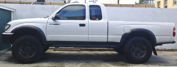

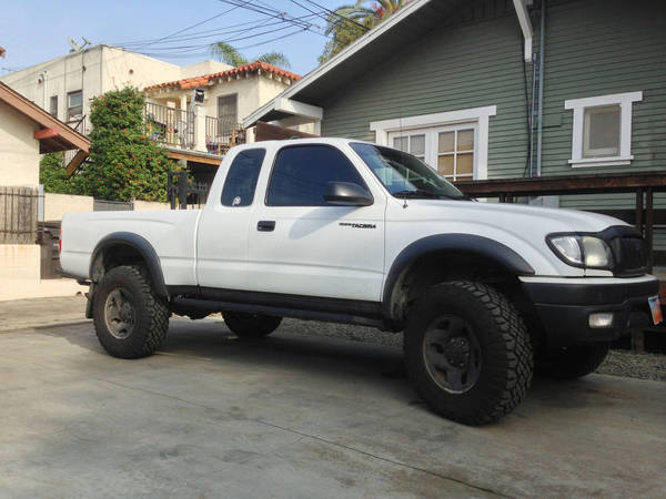

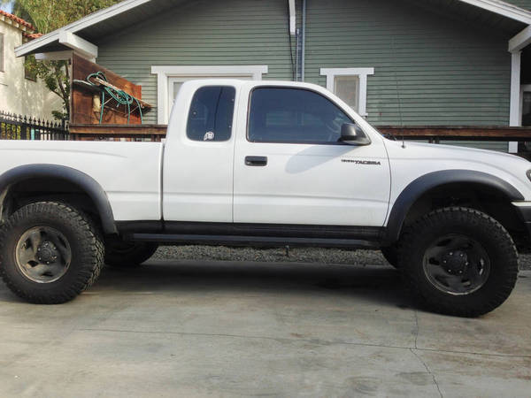

    Lost that so cal bro lean haha
    Before
    After
    Final measurements gained:
    Front: +2.25
    Rear: +.5 from stock shocks and leafs, +2 from OME shocks and stock leafs to OME shocks and leafs +aal
    Rides very nice, and I'm loving the stance
  12. Dec 8, 2012 at 7:00 PM
