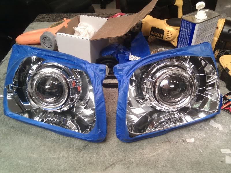

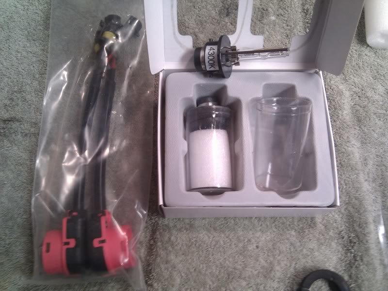

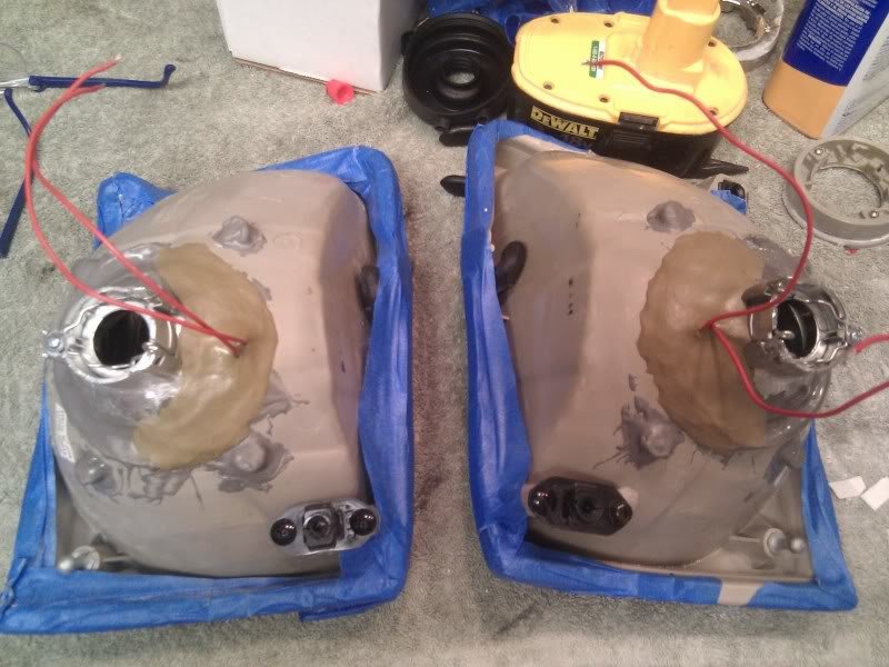

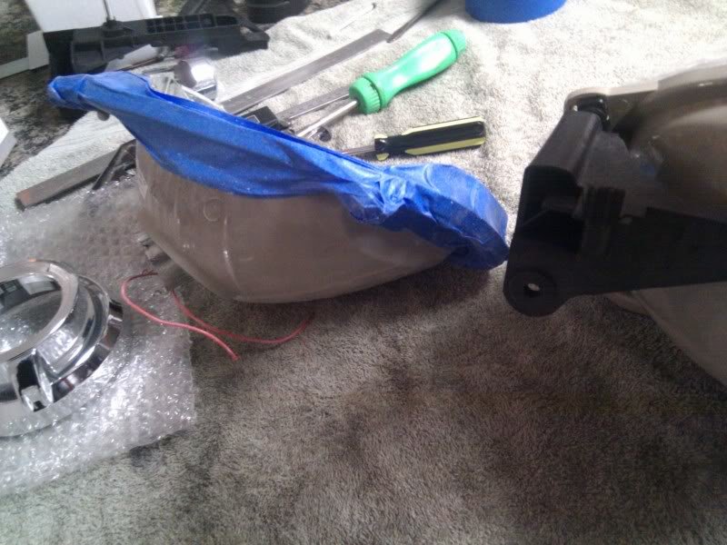

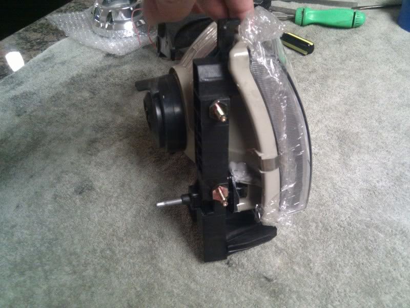

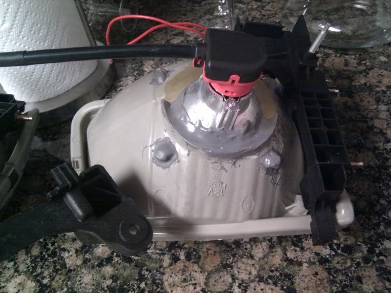

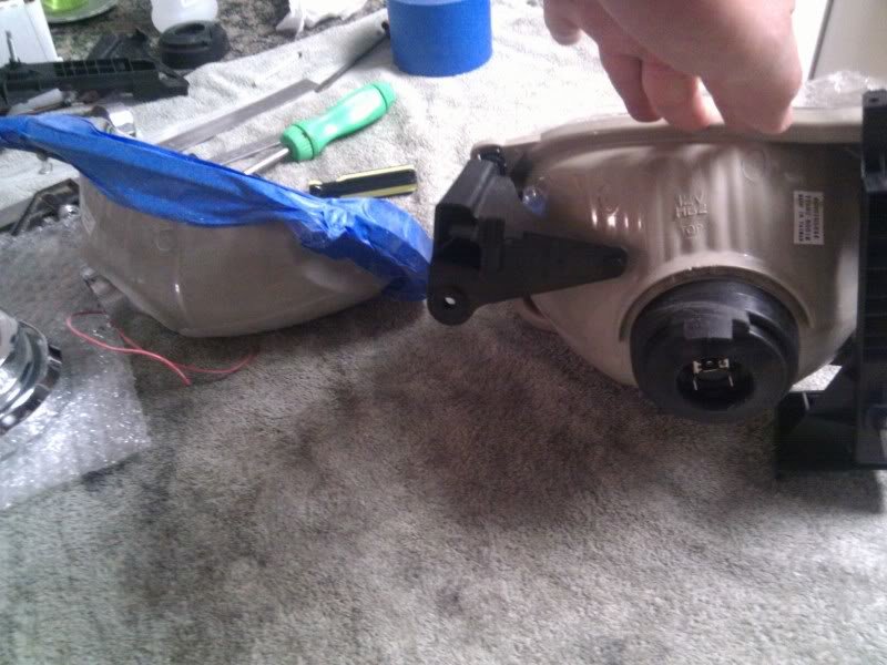

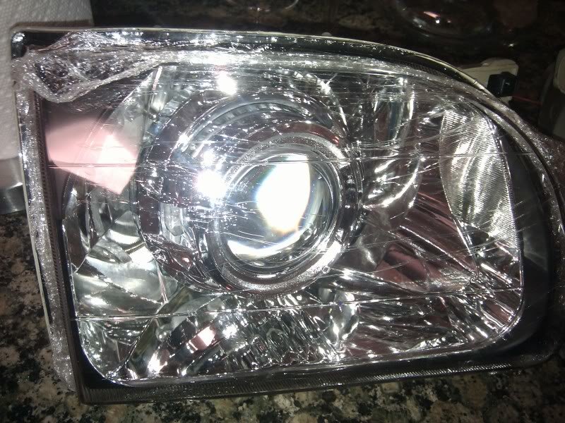

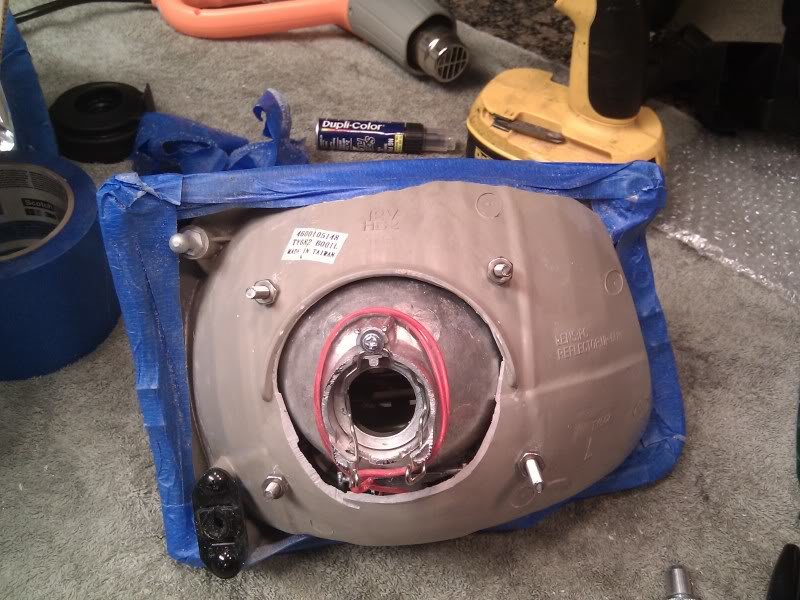

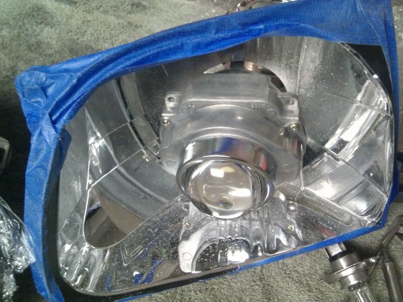

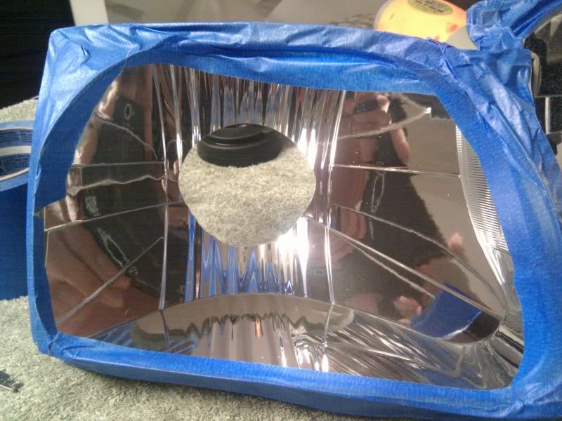

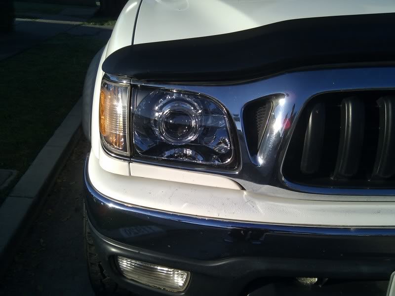

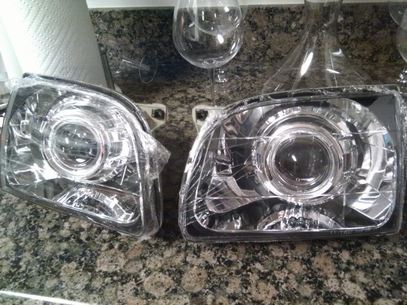

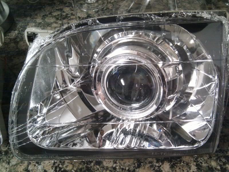

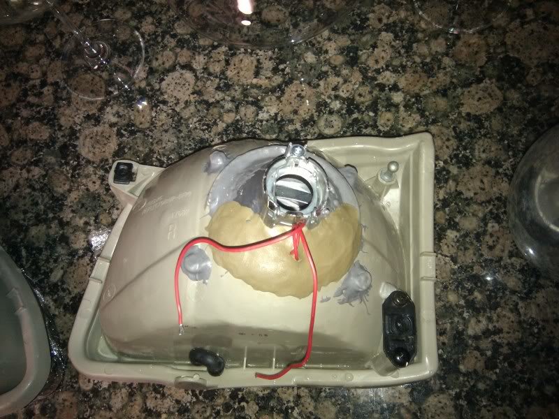

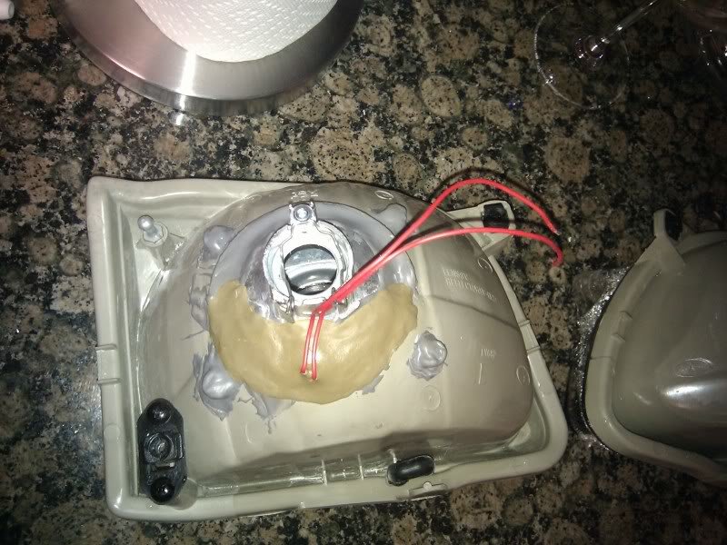

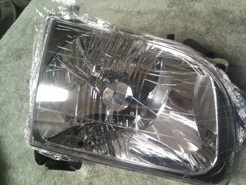

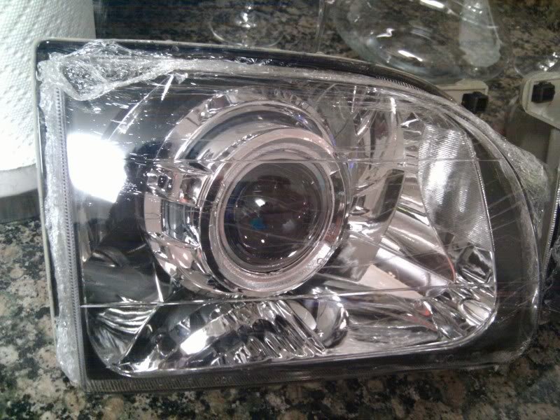

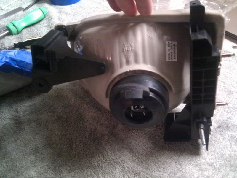

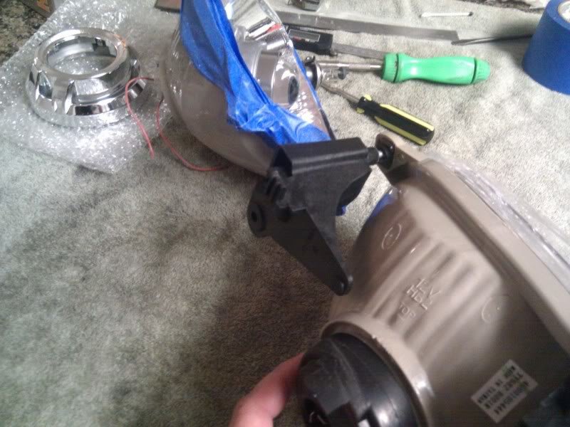

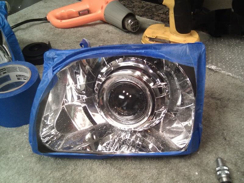

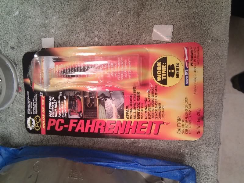

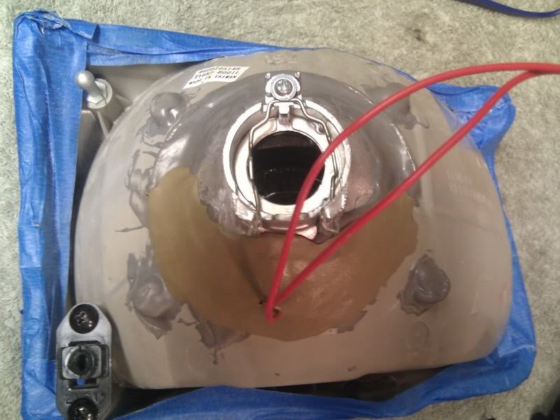

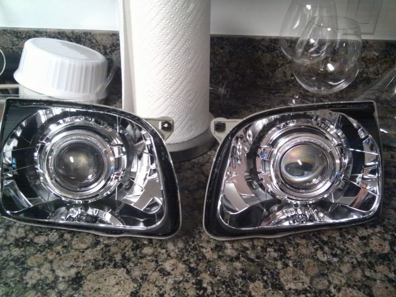

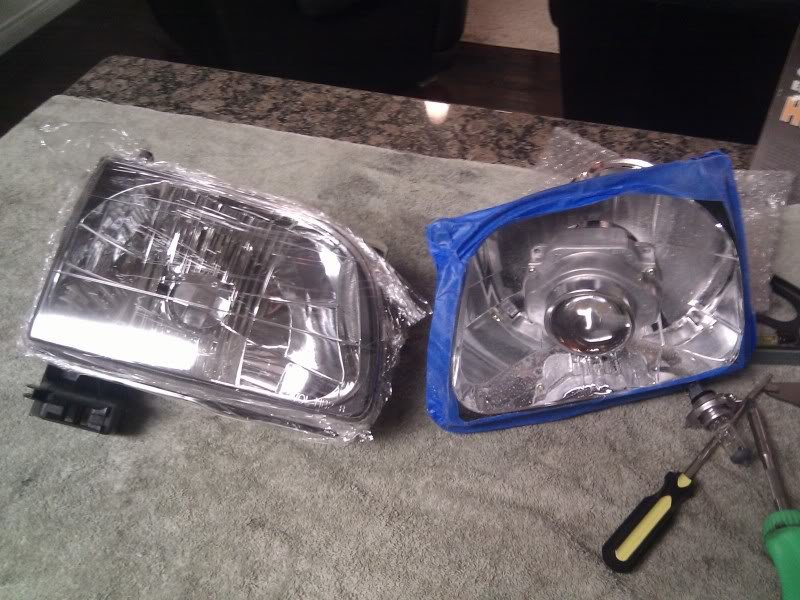

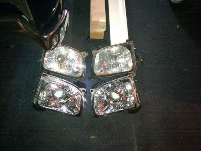

    I've been getting many PMs so here are the pics for everyone.. Knock yourselves out!
    Comments:
    * I hate working with JB Weld. It was my first time using the stuff. That crap gets all over the place and makes your work look totally Mickey Mouse. I found better stuff that is more like a putty and dries hard as a rock and is high heat resistant. I'm going to dip/coat the back housing in silicone so it's not ugly as sin.
    * Total hours 6-8hrs for someone competent enough with basic tools and common sense not to heat the plastic too hot. It would take me 4hrs to do it again and I would have made the holes smaller (you can tell from this pic that I kind of f'ed up and made the hole about 5mm too big). Air tools or a dremel is totally necessary
    * FYI THIS IS NOT THE OEM Toyota housings but instead OEM replica replacements
    * Pics are not in order. You'll have to figure it out :D

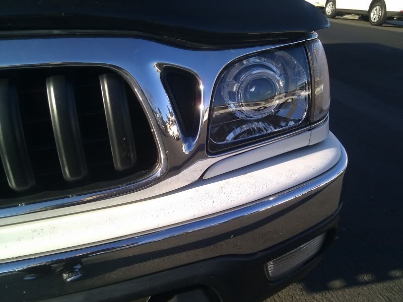

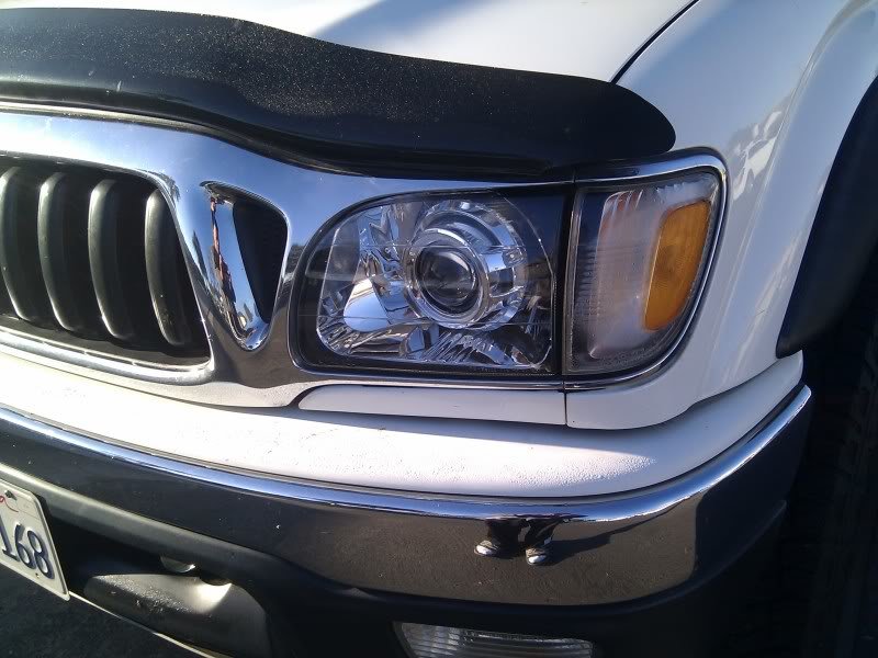

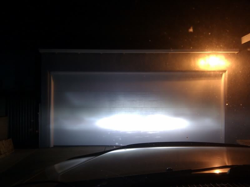

    Now on to some more pictures!
    Comments:
    * I must say.. these turned out much much better than I ever expected. They really do look OEM in my opinion.
    * The light output is simply amazing. I was driving on one of LAs abundant 7-8 lane freeways and, I kid you not, all 8 lanes had more than ample illumination and the "hot spot" was evenly dispersed.
    * I've owned many cars with projectors and the FX-Rs are outstanding.
    Here is the HID 55W bulb in the stock OEM housing. You can see that even though I had them aimed down considerably they still had a lot of "dirty" light everywhere. This was a nightmare when driving thru fog, snow, and even rain.
    This is the new and improved beam pattern. Simply an amazing difference.
    Here are some more less important pics on the truck for you "bling" type folks :)
