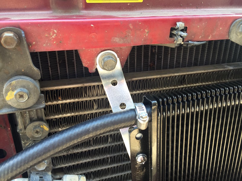

    Installed this in my '04. It comes "complete" but you'll be buying some extra hose and it'll be 3/8" because despite a few local places advertising 11/32" on their sites, no one near me stocked it. The OEM hose clamp will work with 11/32" because it's a little smaller outer diameter than the stock trans hoses are, but you need to use a worm gear clamp for 3/8" hose.
    I did buy a package of "universal clamps" that included a size for 3/8" hose, but the metal was so weak that just opening it up to slide over the hose deformed it, and it wouldn't hold tight. Glad I discovered that prior to turning the key!

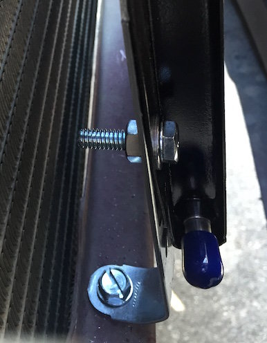

    I also used several spare bolts, nuts, washers due to where I mounted the cooler. This is model 4454 from Tru-Cool.
    I bypassed the radiator's cooler, not because I'm worried about strawberry milkshake but because I just wanted a simpler install with fewer hoses and connections, and because the LPD design of the cooler means it won't "overcool" anyway.

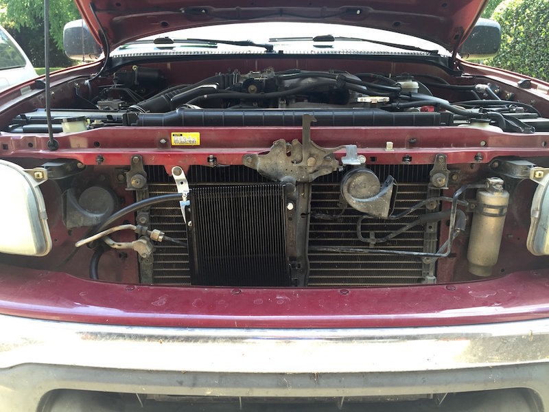

    On the right side of the cooler as seen here, I used existing holes in the center support and had to get creative with shortening one of the included brackets from the kit. Did a different kind of "J" shape on the lower left mount. So the one horn got remounted and wire lengthened/tucked back under the main support and zip tied in several places using existing holes.

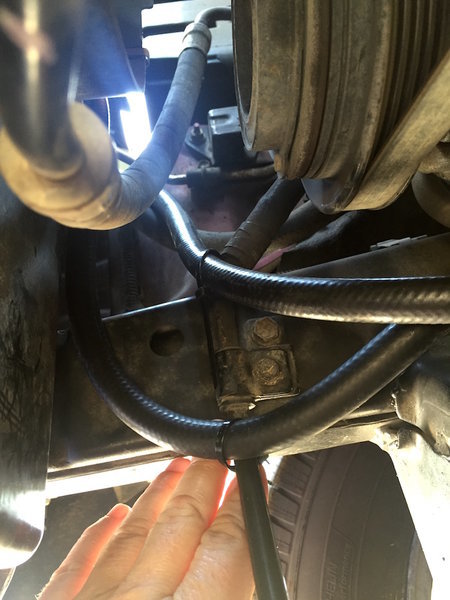

    The only thing I don't like about running the hoses through that large A/C access hole, is that the one A/C tube (the larger diameter one) gets really hot, too hot to touch. Can't imagine that's going to be good for the trans hose that touches it, although I did reuse the original rubber "outer hose" sections from the old trans hoses.

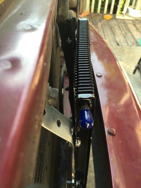

    profile shot,
