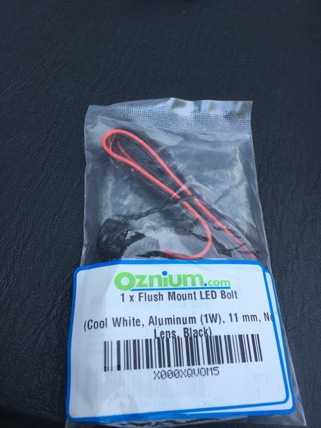

    If you want a quality bed light kit, I can put one together and theyre flush mounted through the bed. Check my Build thread. Theyre great. turns on when the tailgate opens or on a regular switch. Just put together a kit for @LivinLoud 's christmas pressent. would cost probably around $80ish. but would be a very high quality light kit. I use only Ozium lights. Drilling is required. Nothing too crazy though.

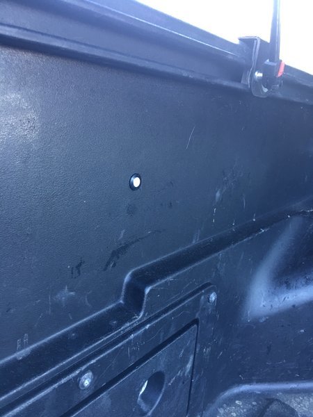

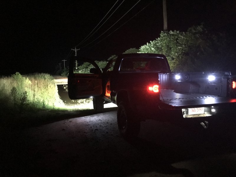

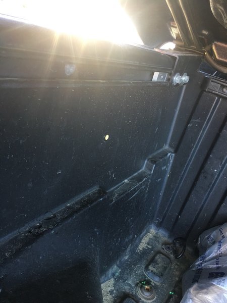

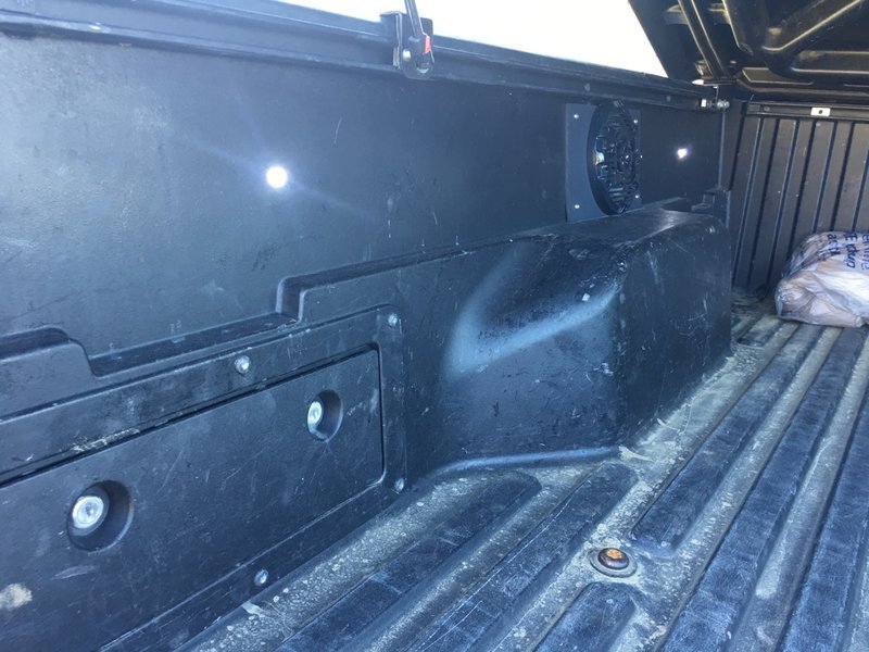

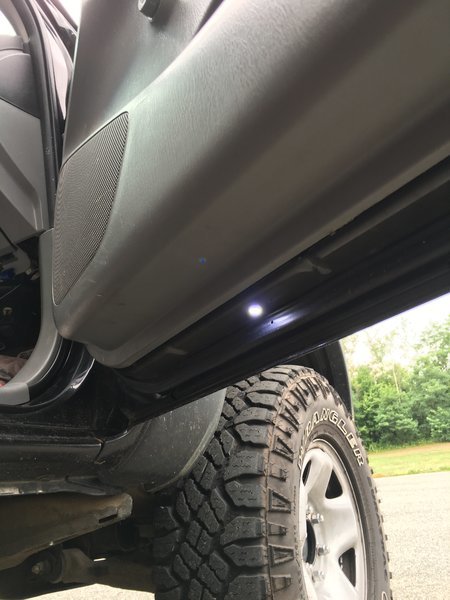

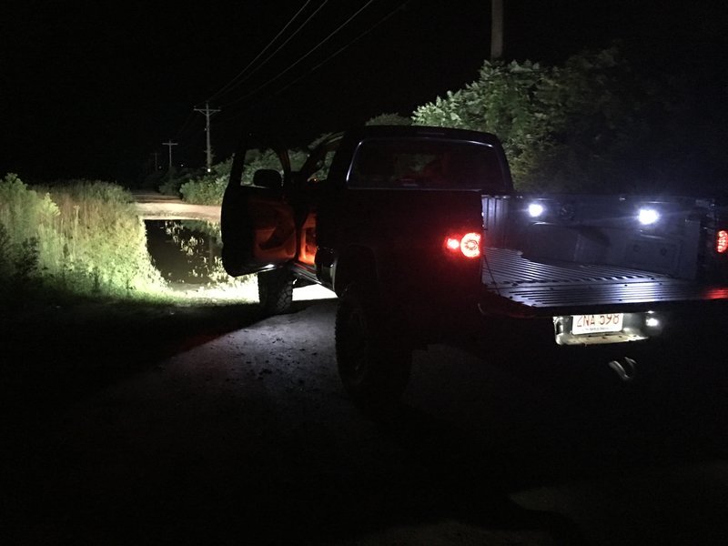

    They are extreamly bright. I love them myself, I'm thinking about making kits and selling them if people would be interested. Theyre flush mount led bolts. water proof and super rugged, also very small. I dont like stick on lights because over time they will fail and wont be stuck on very well in the long run. These will never come out unless you get under there and unbolt them.
