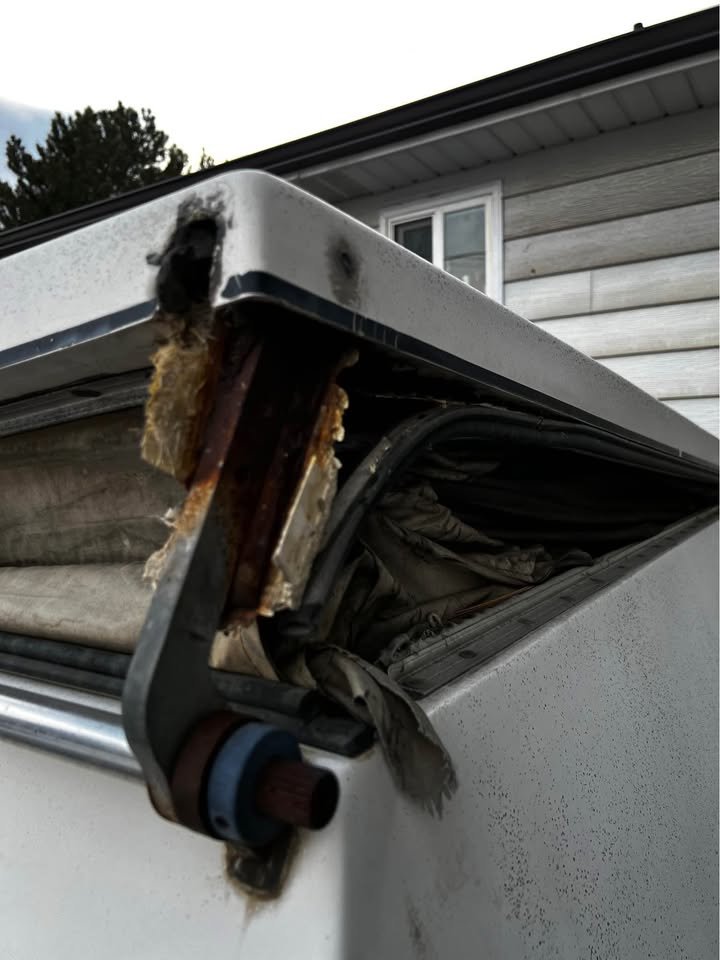

    Flippac's suffer from the "sardine tin can opener" disease when not taken care of. Water gets in, the mild-steel hinges rust and then the bolts into the untreated wood rots and the torsion bar rips things apart.
