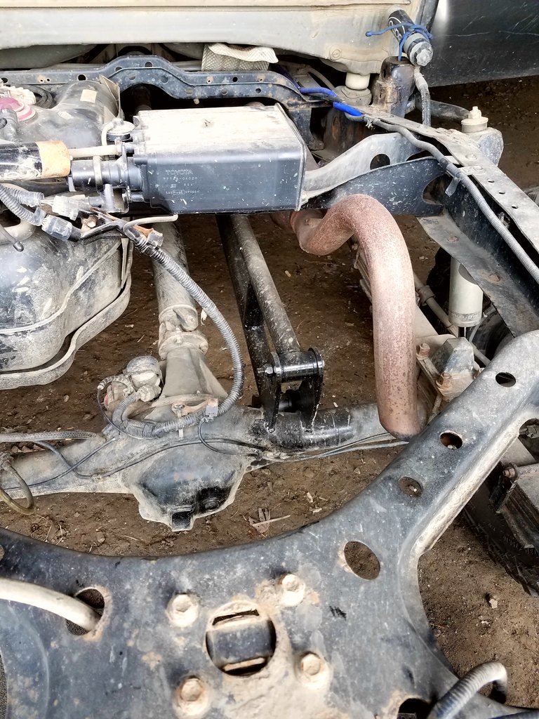

    Finally figured out the p0101 code/ truck running dangerously lean. So I ripped the bed off to gain access ( that's a pain in the ass too) Popped the top and low and behold my high pressure fuel line off the pump was barely attached. Secured that down with all stainless hose clamp. Put it all back together and now the truck is running really rich! Will take some time to adjust back to normal I'm sure but seems like I've cured the issue. Didn't take any photos of it, only one I took was with the bed off to get a top shot of my homemade traction bar. Guess we can chalk the p0101 code up as solved again. :thumbsup:20170722_084932.jpg

    Fuel pump hose..... What a relief that you found it!

    @memario1214 had the same issue with his fuel hose. He can add specifics to how his lacked in operation.
    Me personally, 4 different pumps, and never an issue. Just to add an opposite side of the story.

    Haven't had issue with it and installed over a year ago. Glad I got it fixed though. Racetronix wants 30$ minimim order. IIRC summit racing has the corrugated tubing and you can find it on eBay too

    Ha I had TWO different fuel hose issues. First one was this exact same deal. The high pressure line on the top of the tank came off katty-wompus as I was slow pulling a hill and the truck was getting intermittent power as you can imagine. Could smell gasoline once I had pulled over to the side of the road, but reaching up there could not identify the issue until the tank was dropped again.
    My second issue that occurred about 1000 miles of driving later was that when I had installed the high pressure line onto my new fuel pump I apparently tightented the clamp on too tight and what ended up happening was that the high pressure line split right at the nipple on the pump. This made some weird symptoms as the truck would still run at barely above idle (at first), but then eventually was no dice. Whilst laying on the side of the road one of the diagnostic measures was to disconnect the line from the external fuel pump to see if there was pressure when cranking. Sure there was. Turns out it was only pushing 7 psi...

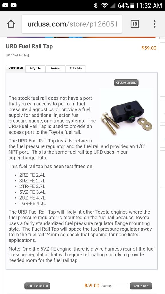

    For this reason, is why I feel having a fuel pressure gauge, at least in the engine bay, tapped into the adapter, is a very good troubleshooting tool.

    I can monitor AFR with the torque app. For this reason, if or when I get gauges- it will be the fuel pressure and boost. Thanks again for helping me trouble shoot.
