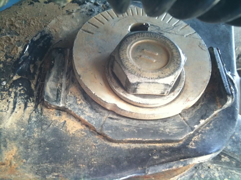

    Get out and inspect your tie rod to see if it looks bent. Look at the knuckle to make sure it looks like the opposite side. Look at the alignment cam tabs front and rears at the LCA.
    Here are some tabs getting gusseted and the factory ones getting cut out.
    This is what you DON'T want.
    attid0-1_1e6058635f1834a575e8b1d6c60fbc47ec1e7581.jpg Look and see if in general everything (UCA down to the LCA) looks like the opposite side and looks "normal". Look for cracks in the welds.
    Look at the bushings on the steering rack while you have someone turn the wheel. You don't want excessive play, if it looks like they're shot, probably need to have replaced.
    You may have just knocked it out of adjustment but check for damage.
