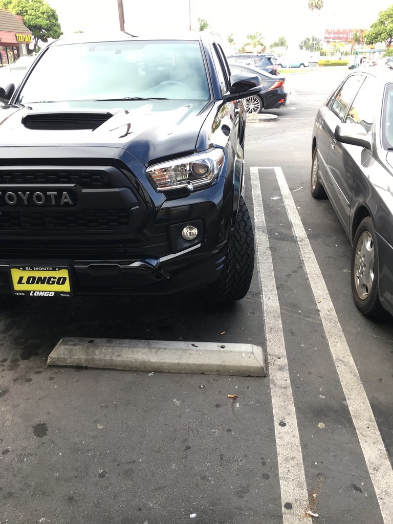

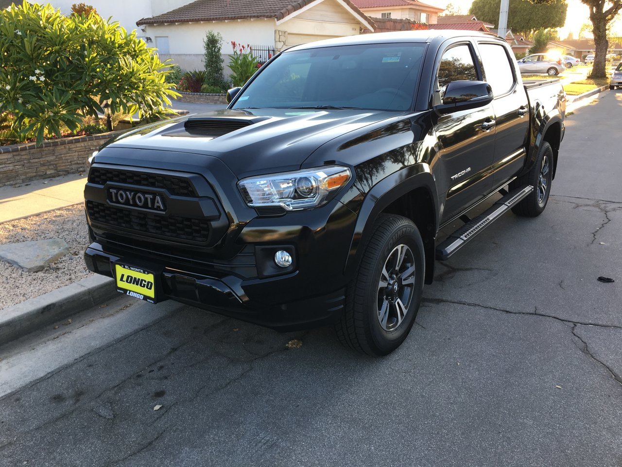

    Good looking truck, welcome to TW!

    Nice looking truck, the PRO grill looks awesome with the black.

    Nice Tacoma and Welcome to TW :wave:

    Longo Toyota is still there in El Monte huh? I remember looking at a new 1979 Corrolla when I lived in Victorville.

    Longo is the highest volume Toyota dealership in the world... Well at least that's what the salesman told me. The dealership is like a college campus now.
