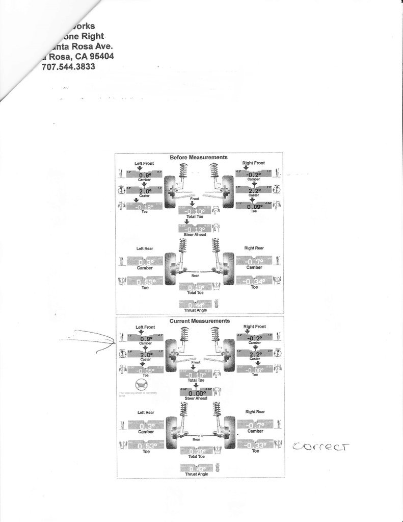

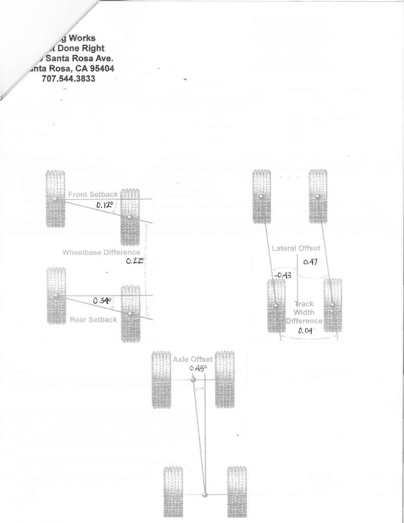

    Was going to start my own thread but this looks perfect... Same issue, brand new, no 4 wheeling, curbs or bumps yet to throw anything off. Caveat is that I just got new wheels and tires (I was at 800 or so miles). Pull right wasn't noticeable on stock setup (might have been mild). After new setup, truck pulled right. Obviously new tires, right? Doesn't appear that way... America's Tire has been good so far. Swapped front to back and side to side to see if it's the tires. No change, slight improvement on pull, but still pulling right after side to side switch. Ready to order new tires for free if alignment is the issue. Suggested I take it to an alignment shop. They look at it today and tell me there's issues with the front and rear, but don't make any changes b/c they say it should be a warranty issue and Toyota should take care of it. Take specs to Toyota and request an alignment, and they are balking at covering it. Waiting on a call from the "warranty guy".
    Pics of alignment shop data is attached... I have no idea how abnormal these numbers are, although I do understand the basics of alignment.
    My theory, and that of the alignment shop is that my truck came off the boat not quite right, toyota or third party made adjustments to make it go down the road straight on the stock tires to sell it. Now that new tires are on it, the issues are presenting themselves. Any alignment experts out there that can help with what I have?? Thanks in advance!

    So Toyota called back and told me I'll have to pay for the alignment since I have new wheels and tires. I'm beyond pissed. Anyone out there have any info I can use to go back at them? Someone above said one alignment is covered... Where can I find that in writing to show them?
    I'm about to head back to america's tire to get the stock wheels n tires put back on and then take it to toyota just out of spite...

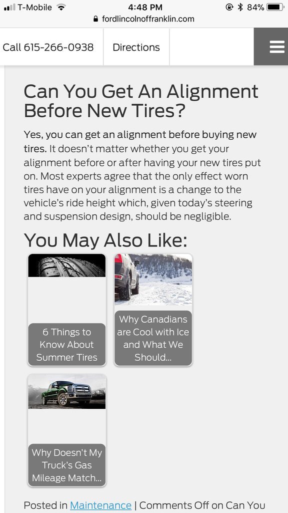

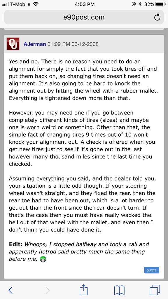

    That wasn’t what I was told if you only change the tires. Yes, it’s recommended but not required, you need alignment checked if you hit something hard or your old tires are really crappy that would slightly affect the alignment, and my tires were 1 weeks old I didn’t actually drive it much before changing to the new set. I have friends that works at and owns autoshops that’s what they told me, not trying to bring in an argument just wanted to confirm. We might heard different from other sources, but I did take your opinion and did some researches again, and found these.
    Thank you for your suggestions.
    https://www.fordlincolnoffranklin.com/blogs/730/can-you-get-an-alignment-before-new-tires/
