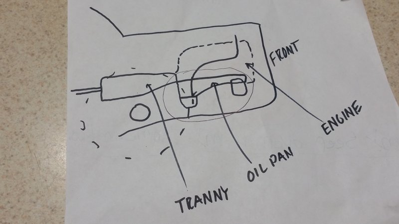

    Kinda looks like this shit picture I drew as a whole....

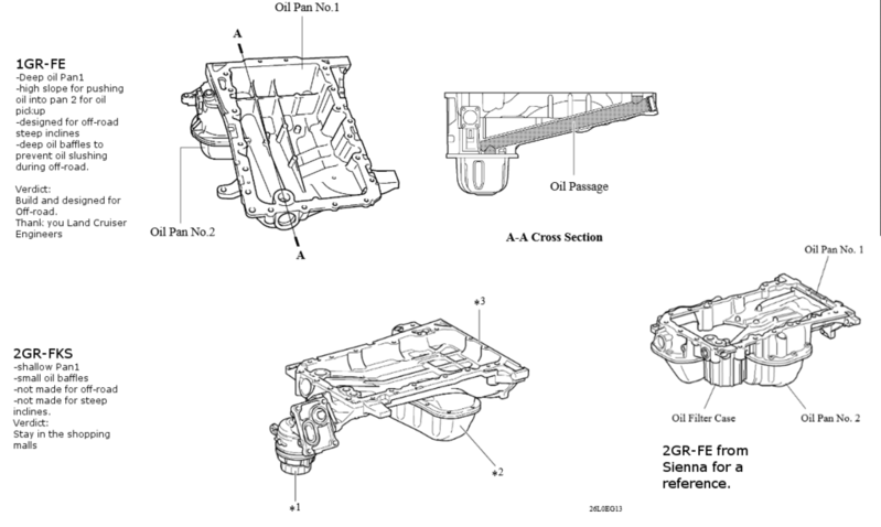

    It looks like the top right picture excluding the cartridge oil filter housing. Cant tell from the bottom left picture did not see it at this angle. Does not resemble the bottom right in any way. Confirmed by physically crawling under the truck and looking at it...

    My 14 Subie Outback came with an oil level sensor. It turns on when it is one (1) quart low, meaning >4 qts left in the pan (or at the lower dot on the dipstick). Many people have said that it will flash going around sharp corners at relatively high speeds. This does not indicate that the oil pressure is at all close to being detrimentally low. I would venture to guess that the new Taco is similar, and that the low oil level light has nothing to do with oil pressure. At one quart low (or when the oil level is lower than the sensor) the engine is likely nowhere near starved of oil.

    My bad. I didn't see those pan pics.....

    So @05Moose posted this in another thread. Looks like new engine failure. No details except leaky head, but leaky head do happens when you run with out oil or with low oil pressure.
    Do tell the details.. Is that your truck ? Is that due to low oil pressure ?
    Based on this document (same I took photo of oil pan) this indeed appears to be 2016 Tacoma with V6 (recognize dual VVTi , coolant lines). Congrats to very lucky guy to be the first one to get his engine appart.
