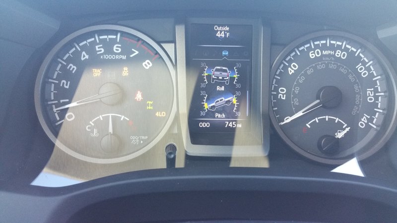

    On just about any modern engine, the oil pressure lights will come on if the engine stalls. Voltage light usually will too. So the lights likely came on because you stalled, not the other way around.
    I could be something as simple as the fuel going away from the pickup in the tank and you lost fuel pressure. If you had a somewhat low fuel level, this would be a pretty likely scenario.

    I can confirm this as I just stalled mine and took pics (ya ya, can't drive drive stick):
    Those were the warnings that came up and stayed up after I stalled.

    Wow 24 pages!! Half of which is non sense...
    A Low pressure light is going to come on after a stall. That's normal. The ecu hasn't been reset because the ignition hasn't been cycled. There for it displays low pressure because the engine has stalled but the ignition is on. Doesn't seem to be any design flaw in the oil pan either. I could prob go on our lot and put 4 at 30 degrees and not one would "blow up". There are a bunch of things that can stall a motor. Why don't you look at those before you assume it's a design flaw of an oil pan
