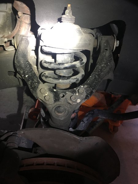

    Frizzman,
    These are the lower/upper control arms

    UPDATE: I FOUND WHERE THE SHIMS GO, against the upper control arm pivot shaft and the frame.
    I found the one the dealership put in on the bolt on the driver side, closest to the firewall, took it out, I can hold the steering wheel straight without the truck pulling right, it seems to drift a bit but it could be due to roadcrown.

    Can you take a picture of the cam bolts? I find it hard to believe they are not adjustable.
    Are they telling you they are not adjustable because they are froze? Pretty common for Toyota Tacoma's. I know, I've had to cut out several over the years because the alignment was not achievable because the bolts were froze.
    The description of pulling to one way or the other is a symptom of frozen cam bolt(s).

    Koditten: they're telling me the cam bolts aren't adjustable because they simply do not exist on the 2wd base model, unlike the 4wd models, or even prerunners, I know that for a fact
