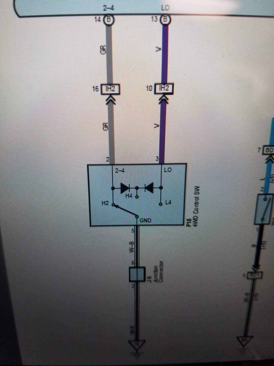

    And if this is true, then an electrical issue seems even more likely. Hell even a dash switch failure seems significantly plausible. (Service manual even has a section for just dash switch troubleshooting.)

    I'm actually thinking that there is a good chance that the problem is actually between the 2-4-L switch and the 4wd ECU under the dash.
    Any beeping? Is the 4x4 or 4L light BLINKING ever (such as when it is switched to 4H or 2)?
    Example: When the switch was in 2, and transfer case in 4L... if the 4L light was on solid (not blinking), then that proves that there is a problem between the switch and ECU.
    BigWhiteTRD likes this.

    Yeah it seems very plausible.
    And would explain why the truck was trying to go into 4Lo as soon as he started...
    That said, The electrical design of the switch would make inadvertent 4Lo less likely and 4Hi more likely, but I have no idea of the mechanical design of the switch inside.
    The switch electrical status is visible thru techstream, besides physically testing it, and the service manual procedure for testing it...

    I don't necessarily mean that the switch itself is bad. Although that could be conceivable, just depends on the mechanical design (you can see that @BigWhiteTRD posted the schematics of it above), and it may also depend on how it handles undefined states, such as NEITHER 2-4 nor 4L being pulled low. Its also possible that the 4wd ECU itself has failed, in which case the state of the switch may be misreported, misinterpreted, or mishandled.
    The danger from things like "techstream" is that if it reports that sensor X or switch Y is doing something unexpected, it may not actually mean that. It could also mean that the component that READS sensor X or switch Y has failed, or that a wire between them has failed. In other words, IF techstream reported (in this case) that the switch was set to 4L, then the next step would be to test the switch and the wires with a multimeter. If they check out with a multimeter, then probably the ECU has failed.
    tonered likes this.
