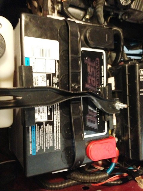

    2007 Optima Red Top took a dump and replaced it with this...fired right up:

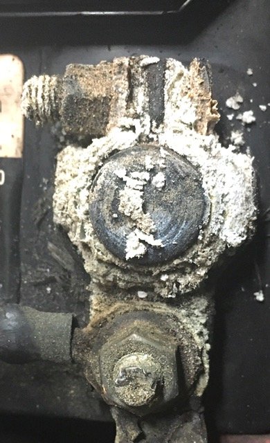

    Bringing up old stuff again, but I tried to start the truck up and all I heard was the starter clicking. Oddly enough, this happened right after I finished replacing my fuel injectors, so I thought I really botched something up somehow because of the timing but...
    Lifted up the positive boot cover.
    Gave her a bath and started right up.
    I am pushing almost 6 years on the battery, but I'll drain all the juice I can out of it.

    The corrosion on the battery post and lugs form a high resistive barrier that prevents the high current to activate the starter motor and the alternator from properly recharging the battery. The battery, alternator, and starter are all codependent on each other and need to be healthy for engine starts. I would recommend fully recharging the battery to get rid of any sulfation build up and have the alternator voltage tested and battery conductance tested, so you will not get stuck someplace requiring an expensive tow.
