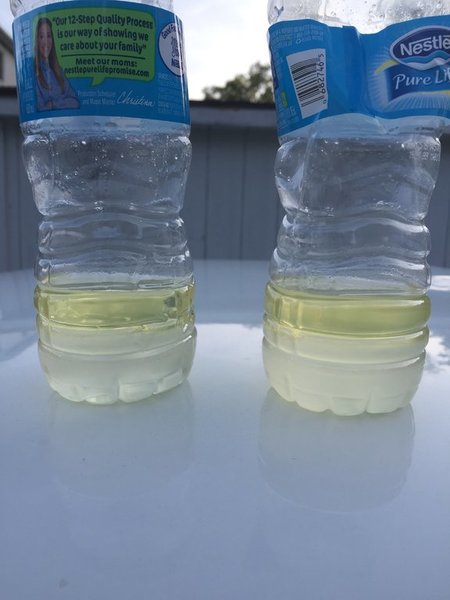

    Well I had some time to mess around with the truck this afternoon. Kind of flabbergasted with what I found. I unhooked the line to the fuel filter above the driverside wheel well and cranked the truck to see if I was getting pressure and I sure was. This is what came out though. I can't figure how to load a picture from my phone.

    Would people have access to your truck if they wanted to put something in your fuel?
    Is that pretty fresh gas or has it been sitting for a while?

    I filled the truck on June 1st and drove it home and it was sitting since then. I have the statement on my online banking and luckily I have an app that keeps track of all my fill ups and maintenance. But the truck has the locking gas door and it's not broken or anything so I don't see how it could have been sabotaged. And I only have 1 key and its on my ring on me all the time

    That's a lot of water. Did you get all of it out. Once you get it running, it will be fine. Gonna run like crap until the water is gone.

    No I only got what you see in the picture as I was just trying to check for pressure and not have it spray on the engine so I was catching it in the water bottles. I just don't understand how this could have happened. What is my best bet for getting it all out. I was hoping to be able to do it some how with out having to drop the tank one because it is full two because I live in the wonderful rust belt ny. And I don't want to open a can of worms where everything will start braking as I take it apart. I had my bed off before winter so maybe that will be easier then dropping the tank?

    Get some more hose and run it to an empty gas can. Pump it out like you just did. Water sits at the bottom. Seeing how you are getting some gas with the water, much of the water is already out. It may actually start without doing the above. It will run rough.

    Drained my entire tank today. Pulled the starter relay and just used the fuel pump to pump it out. Took about 20 min. Then put another 5 gal. In and drained it again. Brought it to the gas station and refilled it and put dry gas in. Seems to be running better now.

    Did it rain the week before the problem started? I'm just wondering if it's possible you have a hole in the top of the gas tank and somehow rain water was able to flow in. Or maybe you just had an accumulation of condensation over time and it finally reached a level where the fuel pump was sucking it in.
