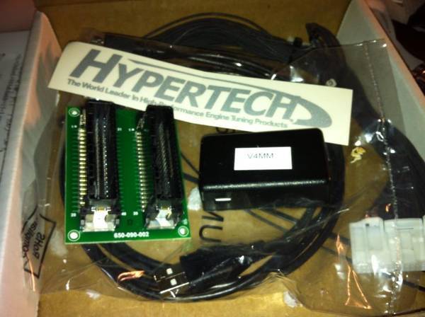

    Or you can get this:
    and not do math while you're driving :D

    What is this? Just curious :rolleyes:
