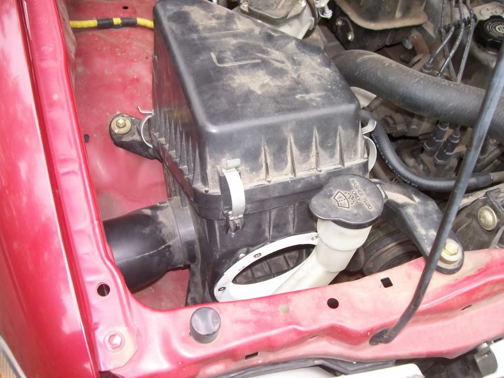

    I have a 2003 tacoma 2.7L 4x4 extanded cab 5 speed. My problem is the air box has no flat sides they are all sort of ribed. I have no place to install a deck plate. Any help or ideas would be great.

    mine was ribed too, just take ur deck accessary plate, & trace around it. then just cout along the trace that u made! u may have to do a lil more trimming on ur hole (circle), put ur deck plate in, drill ur holes, take it back out, put some sylicone around ur deck plate (i used rtv sylicone on mine), then put it in the hole in ur air box, put the screws in, & ur done!

    Ok thanks for the help just didnt want to cut a big hole in my air box if I couldn't seal it back up.

    Cut out hole so you can set the deckplate in. mark how far out it reaches by the ribs. Cut the ribs off up to the point you marked.

    Hey guys I finished my deck plate mod today after work total cost was $13 for the deck plate, $6 for the sensor safe silicone, and $4 for a package of screws. Everthing always cost a little more up here in canada. Ill know tomorrow if I feel any difference but I doubt I will as I still have a stock filter installed , k and n on order but is going to take a couple of weeks.
