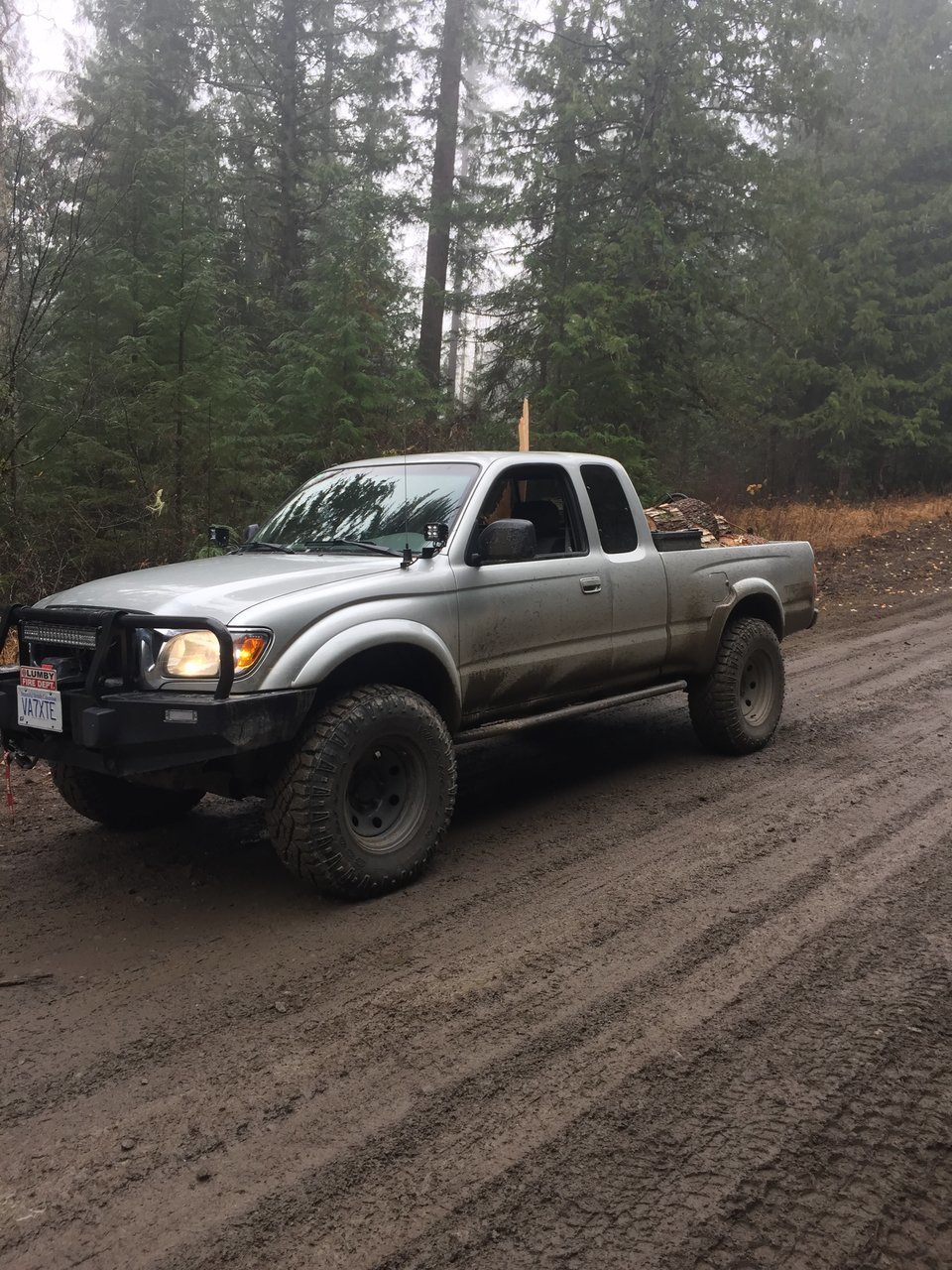

    Are the pro comps you bought D Windows? Just curious because the way they make the d window (the stamp process) leaves a lip that contacts the caliper. I had the same issue and purchased pro comp 98 series 16x8. They fit great. They do, however, have 3.75" bs, so a bit much for a 2nd gen.
    This is on my 1st gen running 285s

    Just one on my phone :oops:
