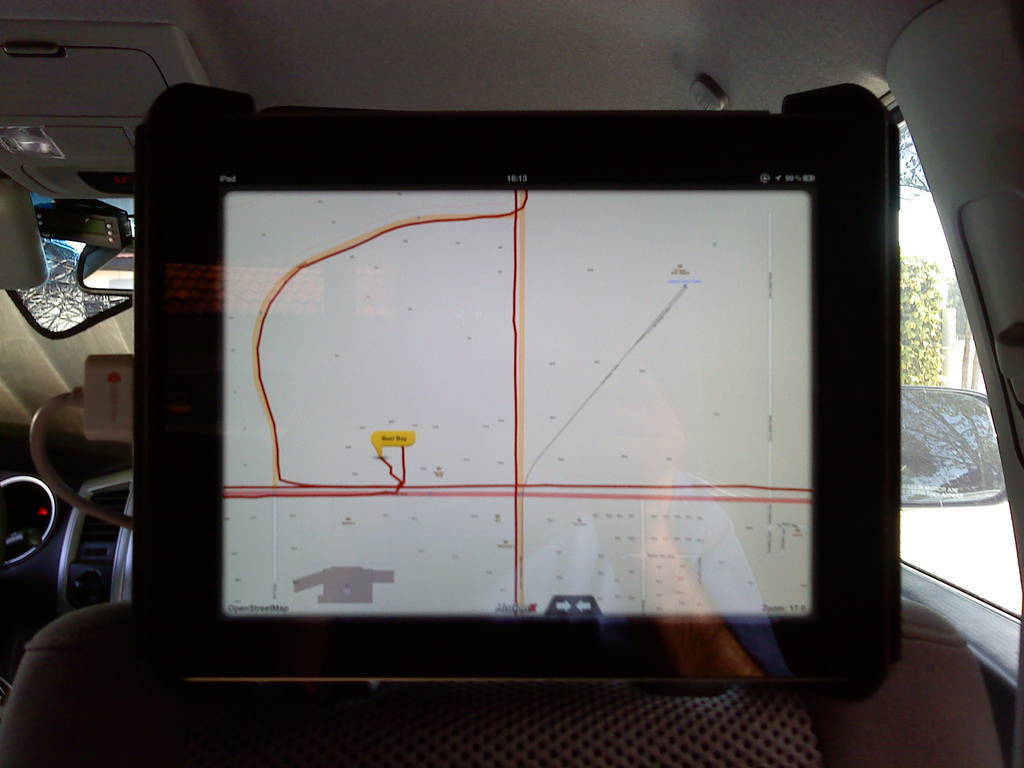

    I'm using this iPad for GPS + compass with the cellular, wifi and bluetooth OFF. I have preloaded FREE maps for offline viewing using MotionX GPS HD. VERY slick!
    When the iPad is in the rear seat area my son uses headphones/earbuds. When I want to listen to the audio out of the iPad or my iPod Touch 4g over the stereo AUX, I use and highly recommend the SendStation Pocket Dock with Line Out & Mini USB.

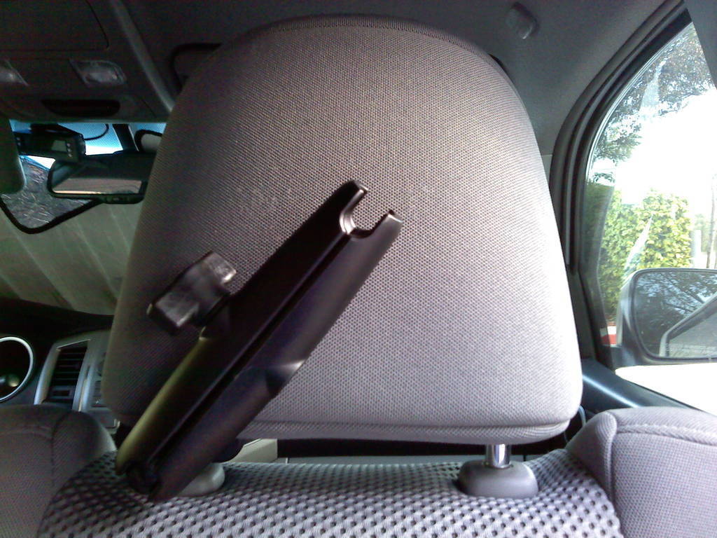

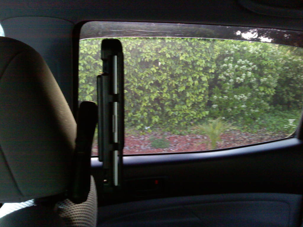

    This is my rear seat mounting solution using RAM hardware:
    1" ball mounted on the headrest
    Long arm mounted on the 1" ball
    Side shot
    SCOSCHE reVOLT pro Dual 10 watt (2.1A) USB Car Charger compatible with new 3rd gen iPad
    http://www.amazon.com/gp/product/B0077PM3KG/
    3M USB-to-Dock Cable 9.8' Heavy-duty 16-gauge conductors to handle 10W charging for 3rd gen iPad
    http://www.amazon.com/gp/product/B003T5JJVY/
    RAM-HOL-TAB3U Universal Tablet Mount Tab-Tite Cradle, works with case (mine hasn't arrived) or the smart cover (as pictured above -folded behind iPad)
    https://www.gpscity.com/ram-mount-universal-tablet-mount-tab-tite-cradle-ipad-ram-hol-tab3u.html
    RAM-B-238U Aluminum Diamond mini Plate with 1 inch Ball
    https://www.gpscity.com/ram-mount-diamond-plate-with-1-inch-ball-ram-b-238u.html
    RAM-B-231LU Stainless Steel 0.75 to 1.25 inches U-Bolt Base with 1 inch Ball
    I used the small u-bolt and shortened the threaded ends with a dremel
    https://www.gpscity.com/ram-mount-large-stainless-steel-rail-u-bolt-base-with-1-inch-ball.html
    RAM-B-201U-C Aluminum 5.25 inch Long Length Dual 1.0 inch Socket Arm
    https://www.gpscity.com/ram-mount-long-arm-b-socket-ram-b-201u-c.html
    I went this route because it can be removed easily with no trace and the RAM hardware can be used to mount ANYTHING. Tonight I stuck the iPad + cradle onto a long arm and a 1" ball suction cup mount stuck to my kitchen table. Helps prevent neck strain and it works slick with a USB keyboard. :)
