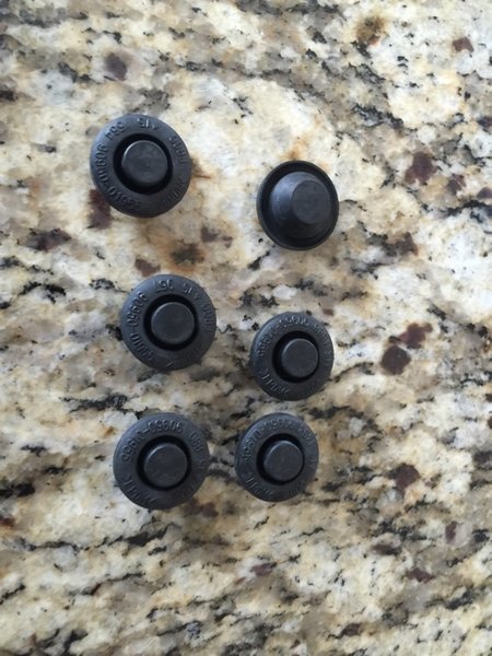

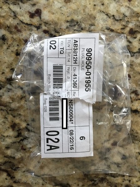

    Picked up my plugs to fix this issue, haven't driven it yet since install which took 15 seconds per side.
    Here are pics of the plugs. Dealer/Service just ordered them in for me when I had the transmission TSB done and let me just pick them up (right or wrong). I think they captured it on my transmission ticket so Toyota paid for it. Someone always has to pay for it...
