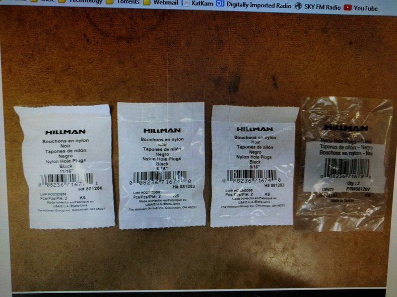

    You could prob measure the diameter of the hole and go to the hardware section and find something.
    Looking at the plugs I bought from Toyota, they're not that special.

    Here are the plugs I used from Lowes. Screen capture is from a TW member. There's 2 in each pack so you'll need 1 pack of 11/16 and 2 packs of 9/16. I bought the 3/4 plugs as well, but none of the holes in my LCA were big enough so I didn't use them.

    IMG_1981.jpg Not dealing with the service department if I don't absolutely have to. I ordered the plugs from the Toyota dealer listed in the TSB using that part number they were $3.30 each and they are softer and rubber compared to hard plastic plugs at Lowe's.
