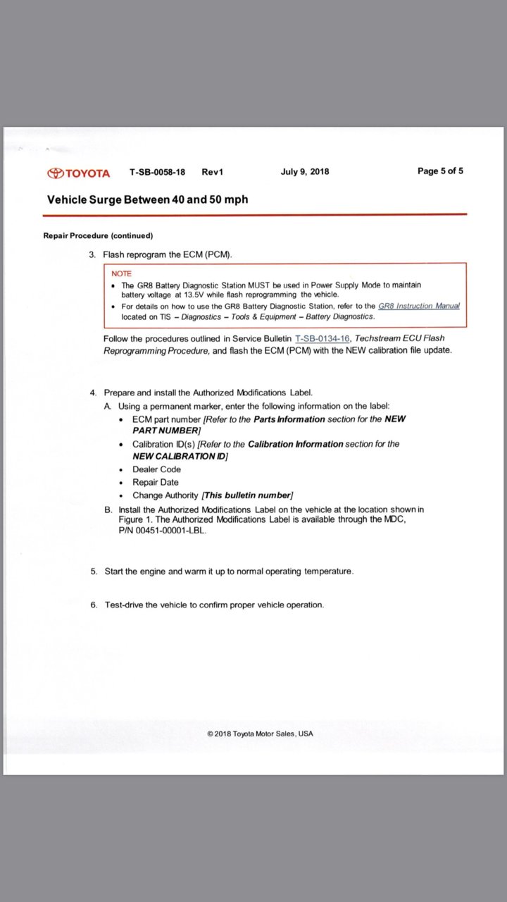

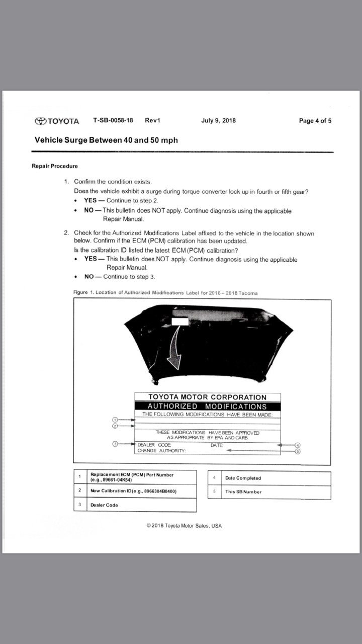

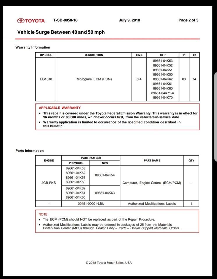

    Went to Dealer today to have the tsb-0062-18 applied. On the pdf file it says 18’s are applicable. Even asked if other members with 18’s had it done and several confirmed. Dealer applied tsb-0058-18 wich according to the pdf in this thread does not list 18’ models applicable.Waiting to hear back from dealer.

    They are the same. You can only apply the latest update available on TechStream.

    So the 0058-18 and the 0062-18 are the same? The pdf showed here doesn’t say applicable to ‘18s but the pdf my dealer showed me for the 0058-18 says ‘18s. Going back and forth with them now so want to make sure my facts are straight as I used this forum as reference.

    2018 QUICKSAND TRD OFF-ROAD DCLB
    So this is the same tsb number in this thread and it’s the copy my dealer gave me... why does this one have the ‘18 models and the one originally posted doesn’t. Going back and forth with dealer. Just want to get this resolved and have some piece of mind.
  11. Aug 6, 2018 at 2:07 PM
    EdgeCrusher
    EdgeCrusher Well-Known Member
    Feb 14, 2017
    #210532
    1,009
    Chicagoland
    '16 OR DCSB Fully Loaded
    Cause it clearly says Rev 1 in which they made a revision to this original from July 9 on July 31st to include the MY18. Relax bud, you're good.
    I see that now. Feel stupid I over looked it. Thanks for all the info

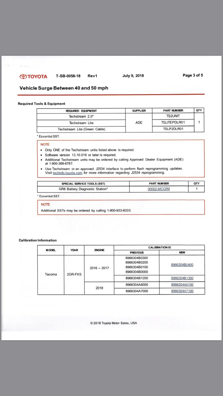

    U can check and see if they did it with a obd2 scan tool. I had my 18 done last week. It showed both calibrations when I picked it up. One shows ecu engine update for 62 and 58 shows trans update.

    Found this in the TSB-0062-18 thread
