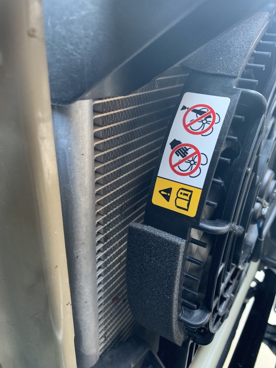

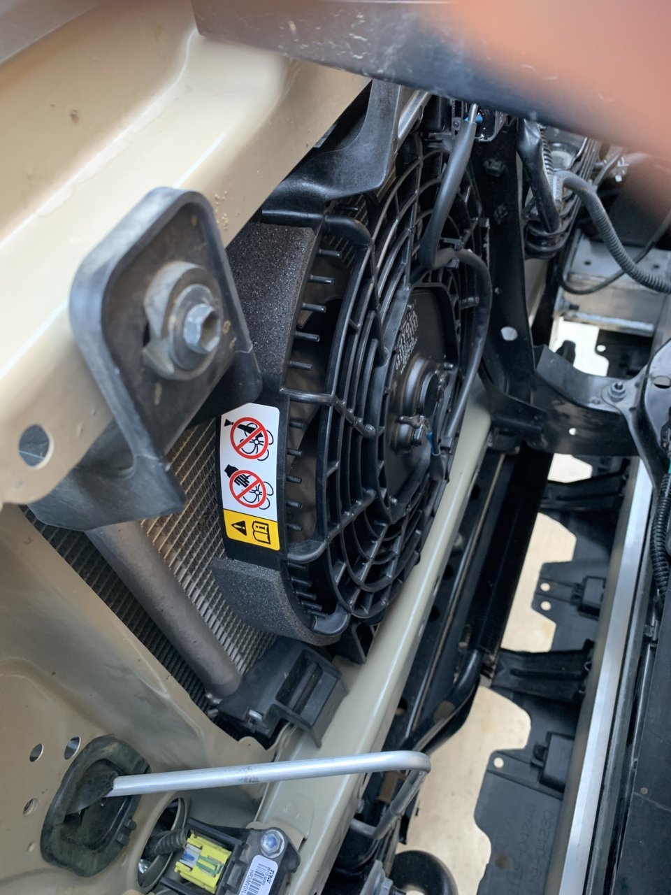

    DIY. Not mine, just figured i would share. From other threads on TW. Probably will do this with my 2nd gen
