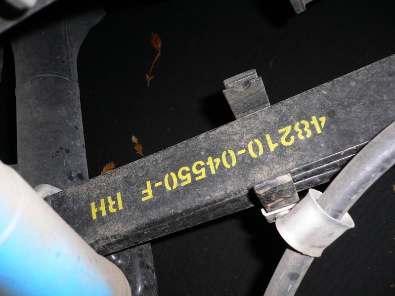

    yea i checked mine out and i didnt see a g on there i think it was an F but it was kinda dark when i was looking ill take a look again
    whats the 1800 number ill just call that first haha

    The best way to see the numbers on the leaf springs is to get a small dig camera and just shoot it over the tire towards the ground. make sure the flash goes off and then look at the dig image after you take the pic and see if you need to move the camera a bit to get a better shot.
