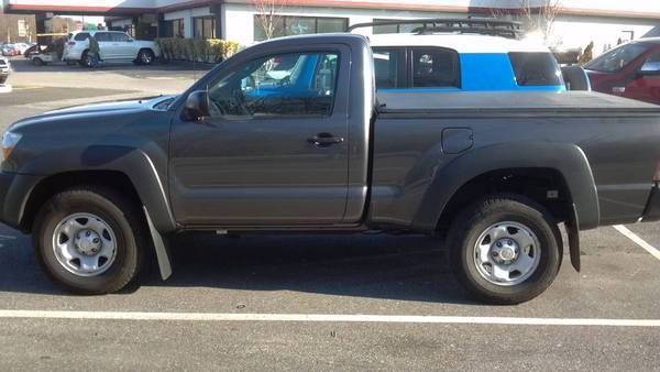

    Its done! Dropped my Standard Cab, 4cyl, 4wd, auto off at the dealer at 8:30 and it was done by 11:00. Truck definitely got a 1.5 to 2 inch lift in the rear out of it. Unfortunately I didn't measure the ride height before hand so I can't say exactly. Ride is a lot stiffer and it seems that road noise picked up a bit. Hard to say how much though because I didn't go from driving the non TSB truck straight to the TSB truck, I put 60 miles on the dealers 2012 Camry loaner in between which was so smooth it may have kicked my ride meter off a bit.
    So of course I get it home and the first thing I did was throw 800 lbs of crap in the back to bring to the dump. The truck definitely handled the load better, still not my old Chevy 2500HD, but not as lame as before the springs. With 800 lbs (tipped on the scales at the dump) the truck still had tail up rake and the springs were flat. Before a load of this kind would have had the nose up and the springs in an inverted arch so I guess the TSB is a win.
    Now however the shocks don't feel right. It seems that with the stiffer springs in the rear it needs stiffer shocks. Just feels funny maybe I'll get used to it or maybe I'll have to go with Bilstens. By the way whoever mentioned standard cabs not getting new shocks the TSB states that ALL 2009 to 2011 are supposed to be springs only, new shocks were only for older models.

    Ok after five days with the new springs, three loads from 300 to 800 pounds and 300 miles on the odo here is my assement of doing the spring TSB on the standard cab. It may not be a win. We get the same springs in the standard cab that they get in the double cab. Our truck is so much lighter and shorter it is too much spring for the size of the truck and the stock shock absorbers. I don't mind a stiff ride, I had a Chevy 2500HD and drive buses and semi's, the problem here is a jumpy ride. The truck now bounces around a bit and handles funny without weight in the bed. So now I have Bilstein 4600 shocks coming to fix the ride problems. If I just went with air bags I would have saved the nice ride and handling the stock truck had, would have picked up the load carrying ability when I needed it and spent the same amount of cash that I am spending on the Bilsteins. And the air bags would have been easier to install then the front and rear shocks. I am going to just install the rears first to see if that's enough.
