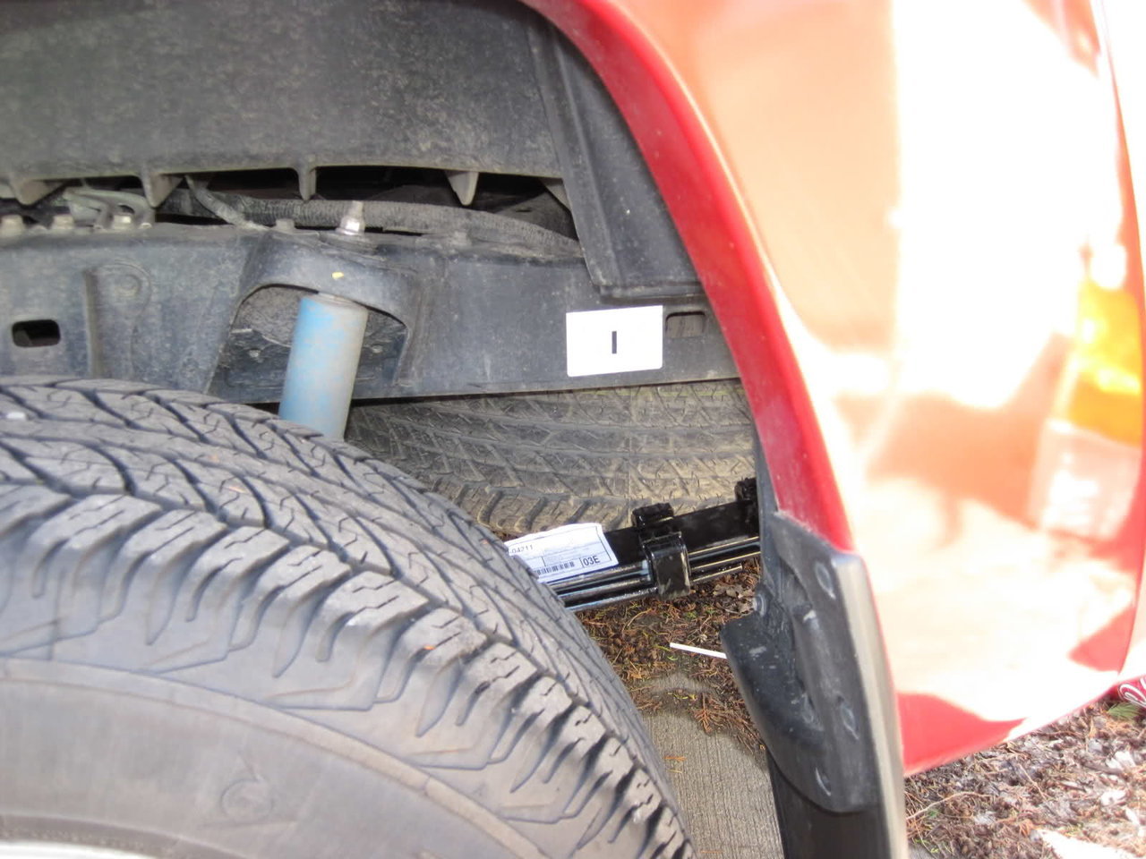

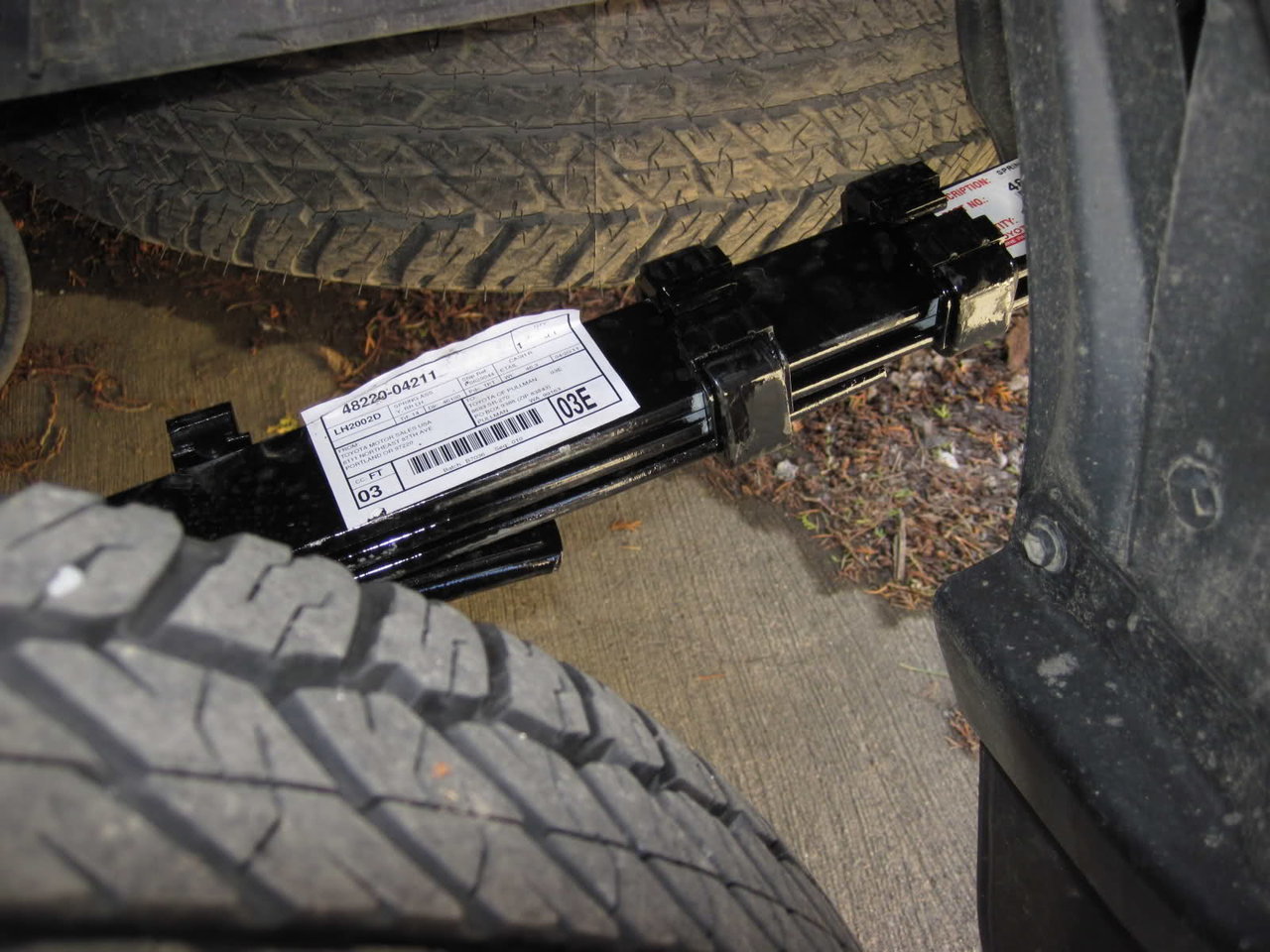

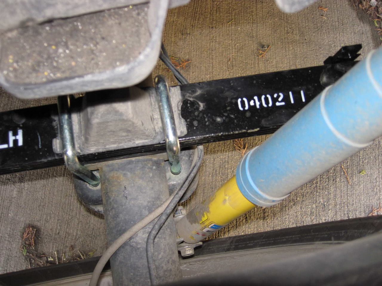

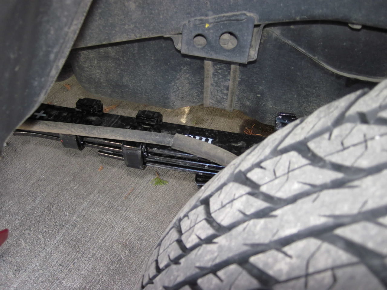

    These pictures are of the TSB for harsh ride done on a stock '11 DCLB Sport

    ^^ Ah-HA!! Your numbers are the same as mine, which are both different than what's on the TSB. This means absolutely nothing, though... :wink:

    Just count the number of leaves.The above photos show 4, but most likely you'll receive a truck that has 3. Way I understand it is that Toyota believes Americans want more of a comfortable ride.

    Congrats on the truck! The 3-leaf pack isn't a defect so much as a market customization, because as carcharias said, us Americans clearly just buy the truck for the ride, not to do anything useful with it [or so Toyota thinks] :rolleyes:. You can get the TSB done by convincing your dealer, namely that it is necessary. Mine was extremely easy to deal with, but YMMV.
    Best of luck and congrats again!

    Thanks for the info, guys. I've enlarged all of the photos above and can only count 3 leaves, unless the very short one on the bottom (which appears to be inverted) counts. Help me count, so I'll know what to look for when I get mine. (The truck is for my cabin in WV, so I expect to be doing a lot of hauling...it's not just an "in town" show truck).
    Also, I just looked at T-SB-0359-10 (rear spring harsh ride) and it says it is for 4x4 Tacomas with Access Cab or Double Cab. Mine is a regular cab. Sounds like it shouldn't be a problem for me, then. Does anyone know any different?

    No problem! Glad you enjoyed them. I am very happy with the new setup, because it does feel a bit stiffer and I like that. Plus it rides a little higher and feels great in doing so. My truck needed practically no work compared to many other trucks because of the fact that it is a TRD Sport '11, so very little changed for me. It rides more confidently, which I think is a plus. There is a difference definitely, but it was not like 'wow, I'm driving some completely different vehicle' difference.

    you go from a 3 leaf to a 4 leaf. gotta count the overload as well.
