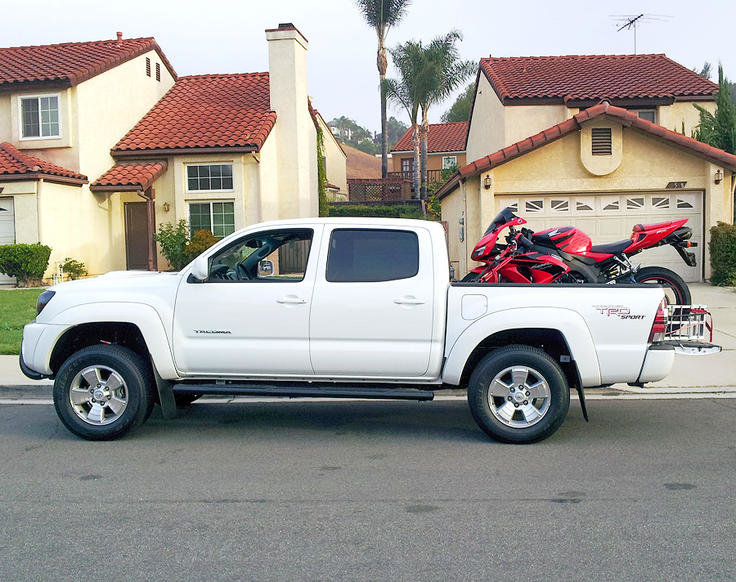

  15. Jul 24, 2012 at 11:45 AM
    #655
    Pinoy
    Pinoy Pinoy Member
    Jun 13, 2012
    #80604
    19
    Chino Hills, Ca
    2011 Pre-Runner Sport TRD
    Taken this Morning on my way to Puente Hills Toyota in the City of Industry
    After I remove some stuff on it like the pipe is a Carbon Fiber and some Fender Eliminator the bike Weight is around 380lbs
    with a 380lbs weight and no passenger the truck is sagging already pretty bad, I told the Service Manager that I normally haul 2 bike going to a track and with around 800 lbs of load the truck ride harsh and I'm hitting the bump stop and the payload is supposed to be 1,300lbs the other Service Manager told me I can fix it by adding a leaf and told him yeah, that's a way to correct it and fortunately they have a TSB for it and he says “huh” (my Truck is only 20 months old with 12,517 miles at the check in)
    I showed him the printed TSB and he replied with ooohhh, okay and he called a mechanic to have a ride with me with the bike on it to do a test ride
    After some roundabout with the mechanic they decided to order the parts and hopefully will be ready to be installed either Thursday or Friday
    Btw I believe another Sr. Mechanic Manager also spoke with me and I was told that he have the same truck and same problem and they need a to hear a Customer complain on what is the issue and what problem they are having before they perform any TSB and order parts
    Since this is a TSB not a Recall they will not notified anybody about the problem until they’re having the “Harsh Ride” when loaded otherwise they will never fix it cause some owner are not using the truck as it should be and treat it like a Car
