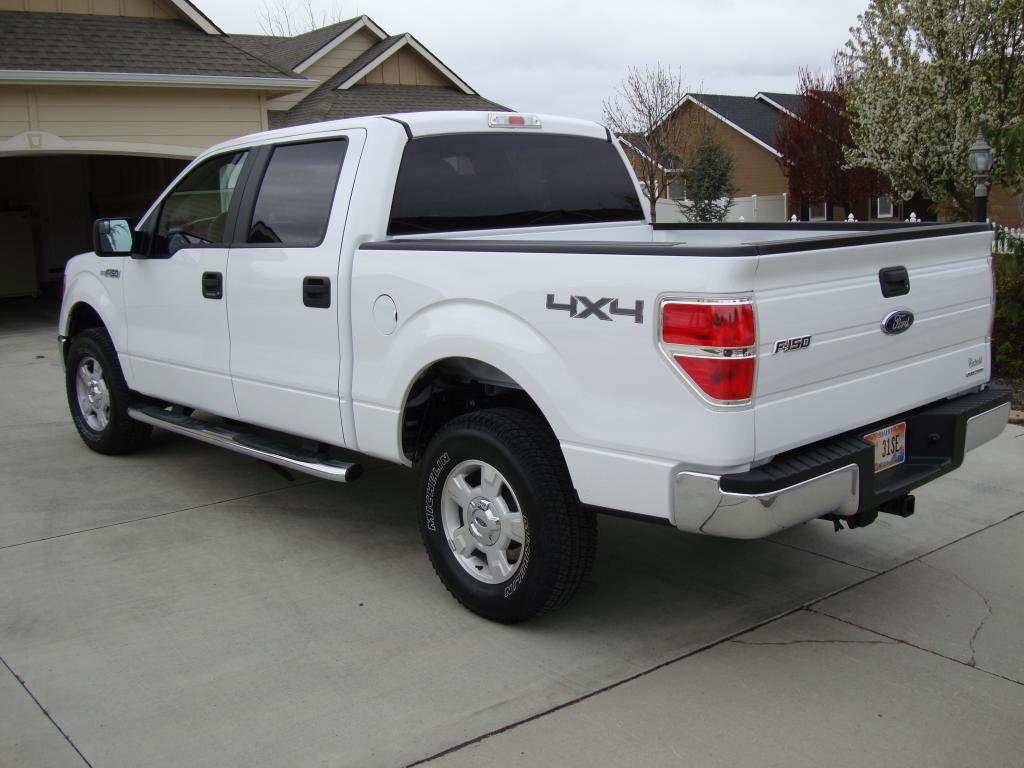

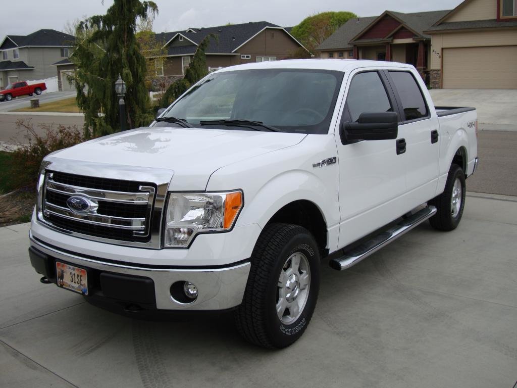

    After multiple visits and more than a year jacking with Toyota, I got the permanent fix for the driveline vibration.
    Never again.
    I couldn't be happier!
    Adios~ Amigos!
    5.0L V-8 XLT same gas mileage as Taco 4.0, go figure.

    is the vibration when you are accelerating kind of fast? i just purchased my tacoma a little over 2 weeks ago and i noticed a vibration right away, but it only happens when i take off fast.. if i accelerate at a normal speed there is no vibration

    Nice looking Ford. You will not find a truck that won't have an issue. As for the gas MPG's you will not see the same MPG's with a full size truck V8 as you would in a V6 Tacoma. Ford 4x4 5.0LT 14 city 19 HWY. Tacoma 4x4 4.0LT 16 city 21 HWY. My brother just bought a 2013 ford F150 XLT 4x4 5.0LT and we took both on a 208 mile trip in Missouri, mostly flat HWY he got 20.5 and I got 24 cruse set at 65MPH.
