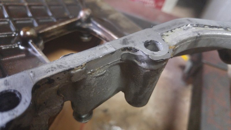

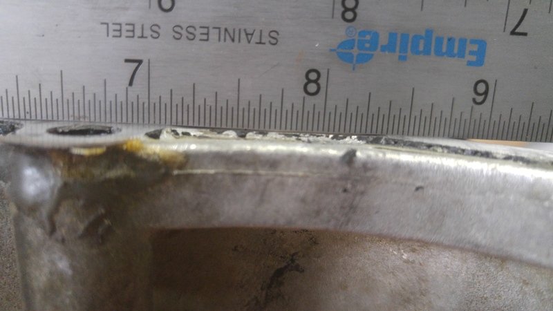

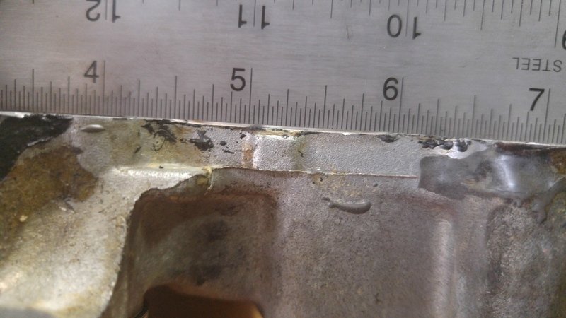

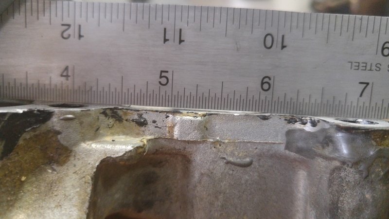

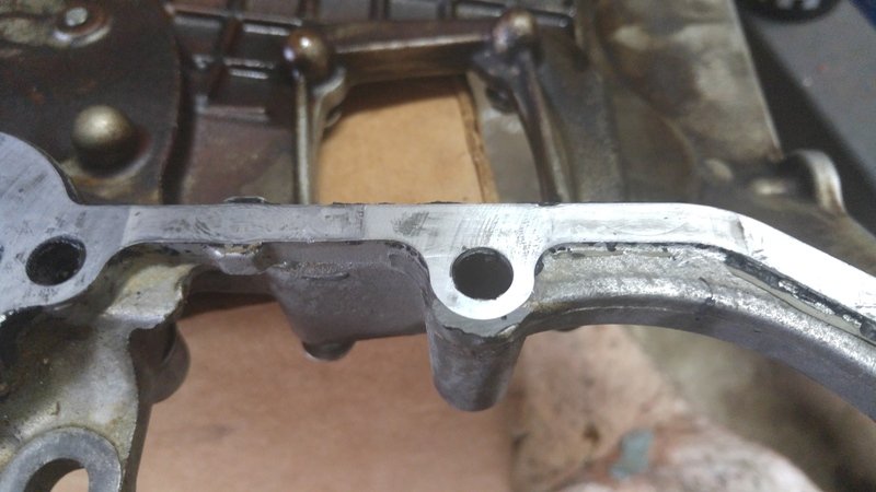

    For all of the owners with the leaking timing cover.
    Sorry for the delay in getting these pictures. I'll post them elsewhere as well. Not sure why I never took pictures prior to now, but at least now I have them and can share them.
    Here are the two machined locations, on the mating surface of the timing cover, in the location of where the power steering pump resides. As well as where the tsb fix is for.
    Here you can clearly see how the mating surface is not even. The first picture is of the gap closest to the top of the timing cover. The second and third pictures are the next slot a little lower.

    It's hard to see in the Pics - but this looks like a mfg defect. IT "looks" link they flat milled the casting gasket location - but did not take enough metal off to ensure that the plane is completely flat. (or, the casting was warped, or they where at the max allow to remove and ) anyway - this looks like a QC miss to me. If it was me I'd tried to get enough info to confirm this then re approach Toyota. I'd like to think that if this is so, Toyota would at least provide the part n/c. JMO

    What ever the reason that caused the two depressions, as pointed out in the pictures, it is the same across a broad range of year models. Which is one hell of a QC miss. I have 5 timing covers. All from different years. Including the earliest in '03-'04. All the same. It is some part of the manufacturing process. What is the root cause of the two uneven machined spots? That is the real question.

    Gotcha. As stated - I do not have the part in hand.... What I'd like to do, if possible, is lay a sheet of abrasive paper girt side up, on a surface plate, then kiss the surface with the part gasket surface. If it's off, it will show. Also possible to use this process to flatten out the casting gasket surface. So What does Toyota do ?? Replace the part with the same and hope the gasket can cover the error ???

    All that I am aware that they do is remove the old silicone and apply more.
    What I do, is remove a little material off of the power steering pump's upper bolt hole casting, with a file. Which presses between the timing cover and the head. That way it no longer presses the timing cover away from the head at that exact point which has the weakest adhesion. Removing just a little, to where the pump can just slide in, will cause the timing cover to be ever so slightly compressed. Furthermore, a bead of external silicone, will help prevent leaks as well. As long as it is a silicone which doesn't require being compressed between mating surfaces.

    A Couple thoughts... In a pinch and I do not have decent surface plate I've used the milled surface of a table saw.
    Also, The way I see it, There is some minor pressure on the back side of the gasket due to Piston blow by, etc. Should your PCV system/hoses/filters, etc. plug up - the pressure build up will not help the leak ...
