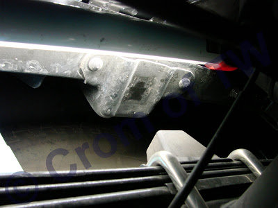

    #18
    Crom
    Crom Super-Deluxe Member
    Jun 22, 2009
    #18782
    9,619
    Nick
    San Diego, CA
    2009 4x4 DCSB Camp Supreme
    Millions
    My experience was essentially the same.
    Not to hard to show the dealer what's going on
