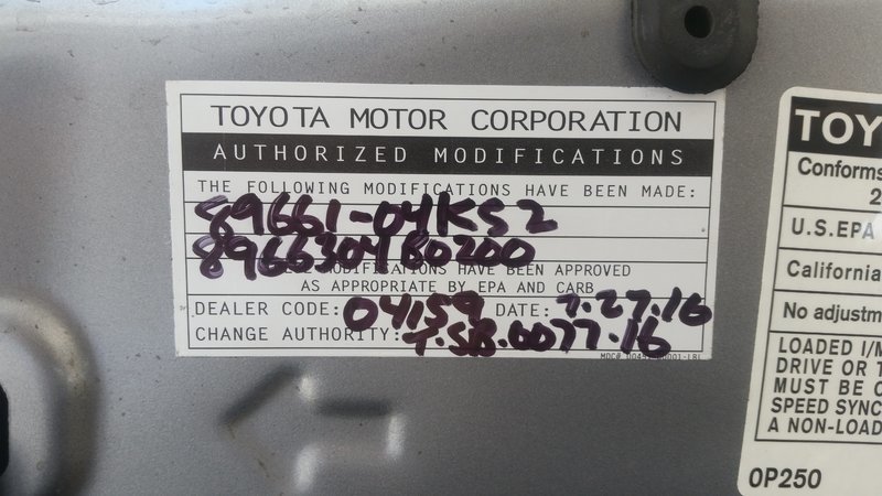

    So of course the service representative that helped me with my tsb update clocked out and went home when I came and picked up my truck. All I was left with was a sticker on the hood.. I'm always on my toes when it comes to dealers.
    I only have 2 codes on my sticker shouldn't I have 3 for the 3 issues that were on the tsb? Or am I worrying for no reason. They wouldnt only do the cruise control and hard 1st and 2nd shift without doing the p to r update correct? Does anyone have pictures of their stickers?
    Here is mine
    Let me know fellow TW

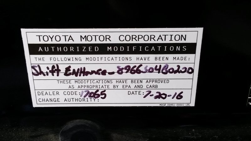

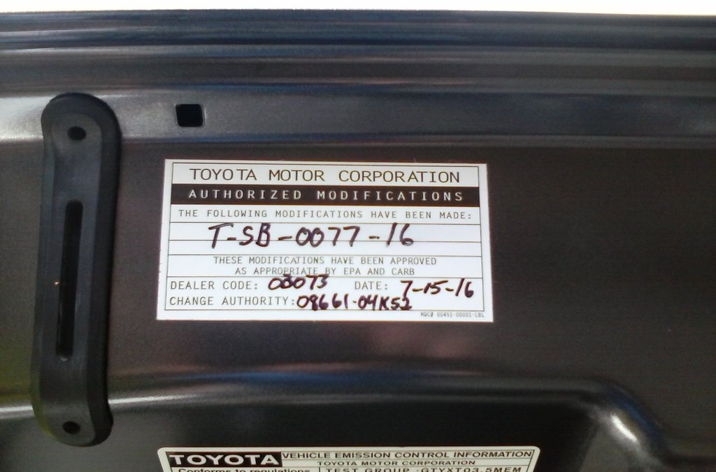

    I see what you're getting at...
    89611-04K52 is the new 'part' number.
    8966304B0200 is the Main ECM calibration ID, of which there are two; 896630401200 is the Sub ECM calibration ID.
    It should have the part number on Line 1 and the two calibration IDs on line 2.
    Mine's all screwed up, now that I look at it.20160719_152130_zpsnkavciaw_da1a346ee190eaa5ae487f47cd6155f46c2dcc37.jpg

    Cracked W/S
    Looks like they actually followed the directions in the tsb when they filled yours out. They just freestyled mine. Points for originality though.

    The following information should be on the authorized modification label:
    Replacement ECM Part Number: 89661-04K52
    New Calibration ID(s): 8966304B0200 (Main), 896650401200 (Sub, Trans)
    TSB Number: T-SB-0077-16 (USA) or T-TCI-4419 (Canada)
    Dealer Code and Date Completed as well
    There isn't really any way they could only do a part of the service bulletin I don't believe, unless they somehow updated only the main or sub calibrations without doing the other. It would seem unlikely.
    What is much more likely (and even more likely now that I've seen what others have posted) is that they just didn't fill everything out on the label.
