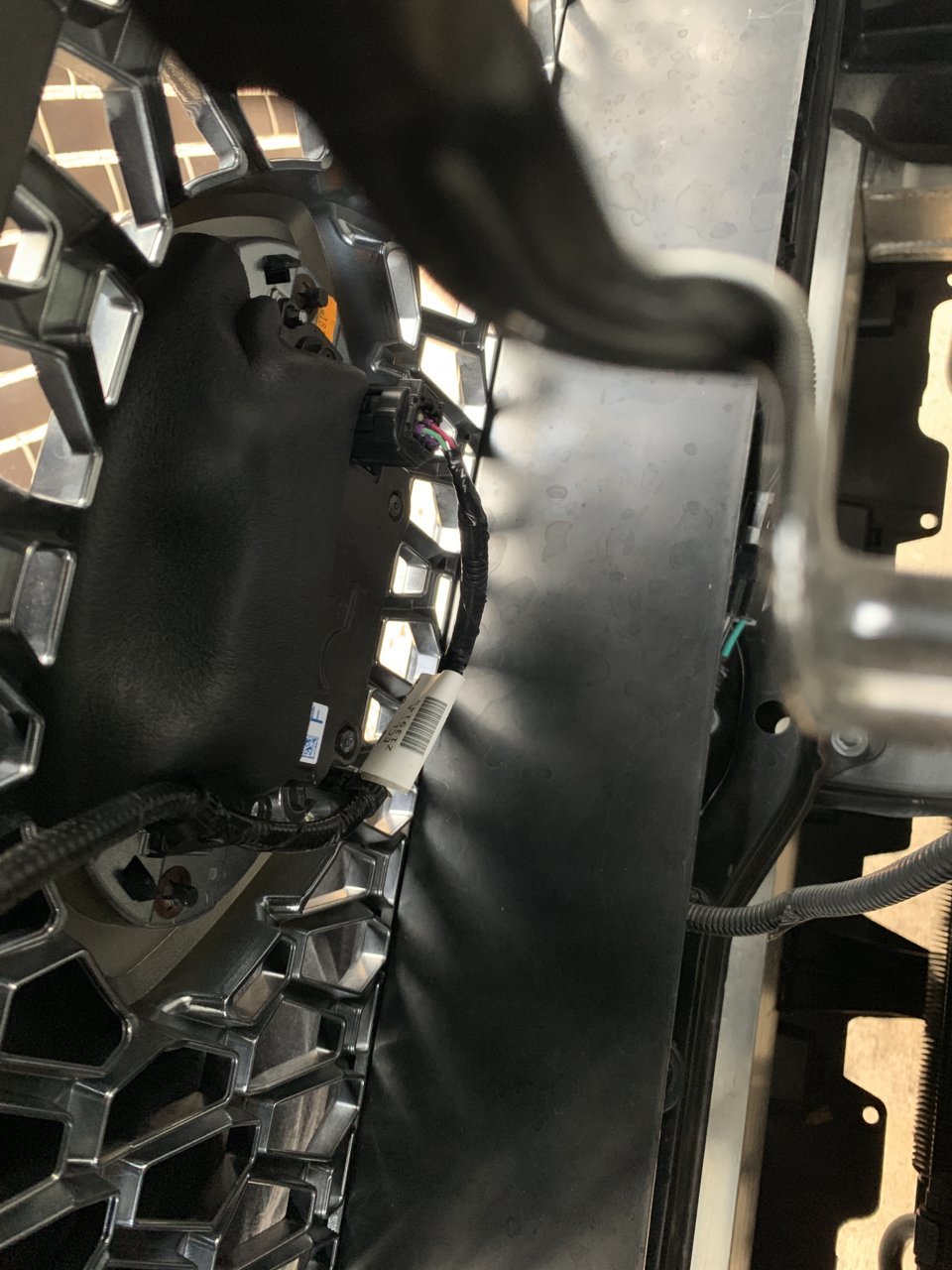

  14. May 7, 2019 at 9:16 PM
    Fattypack
    Fattypack Well-Known Member
    Feb 15, 2019
    #283187
    102
    Waipahu
    2018 Cement Grey TRDORDCLB 4x4
    I just got my truck back they updated the millimeter wave system, and put a cushion on the sensor to protect it from the elements. I guess water/debris gets in between the sensor and grill.
