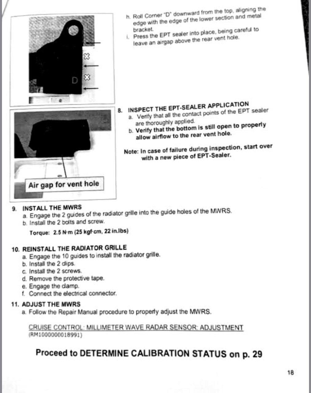

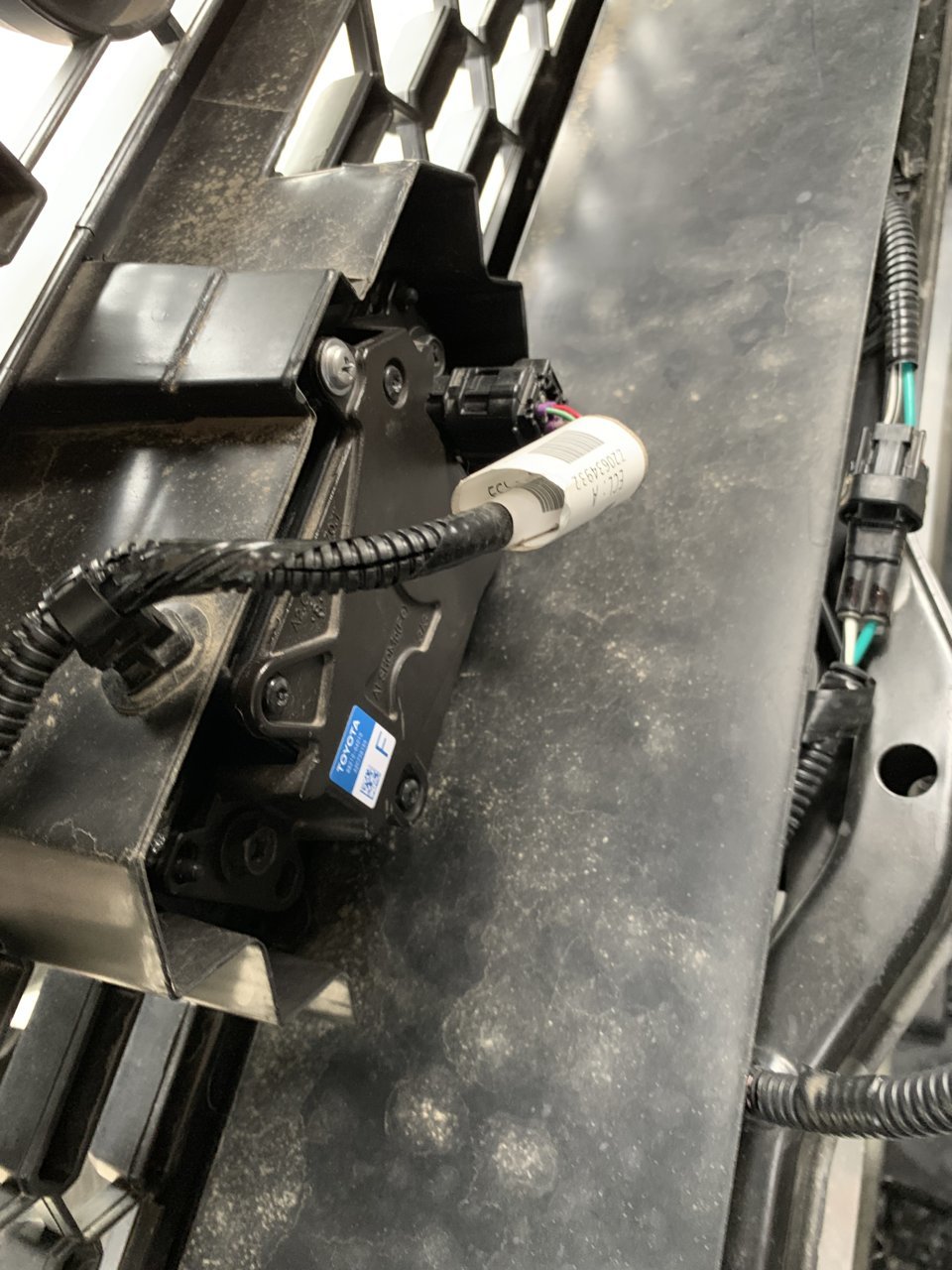

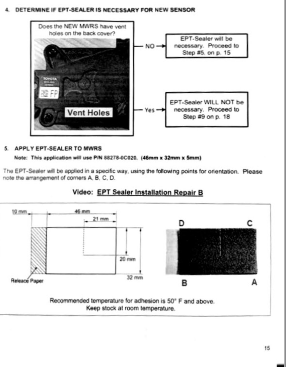

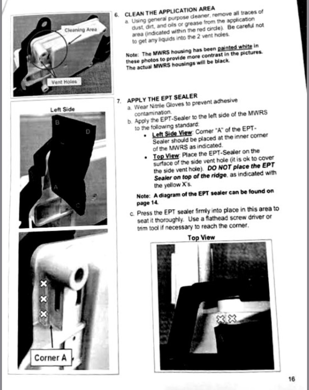

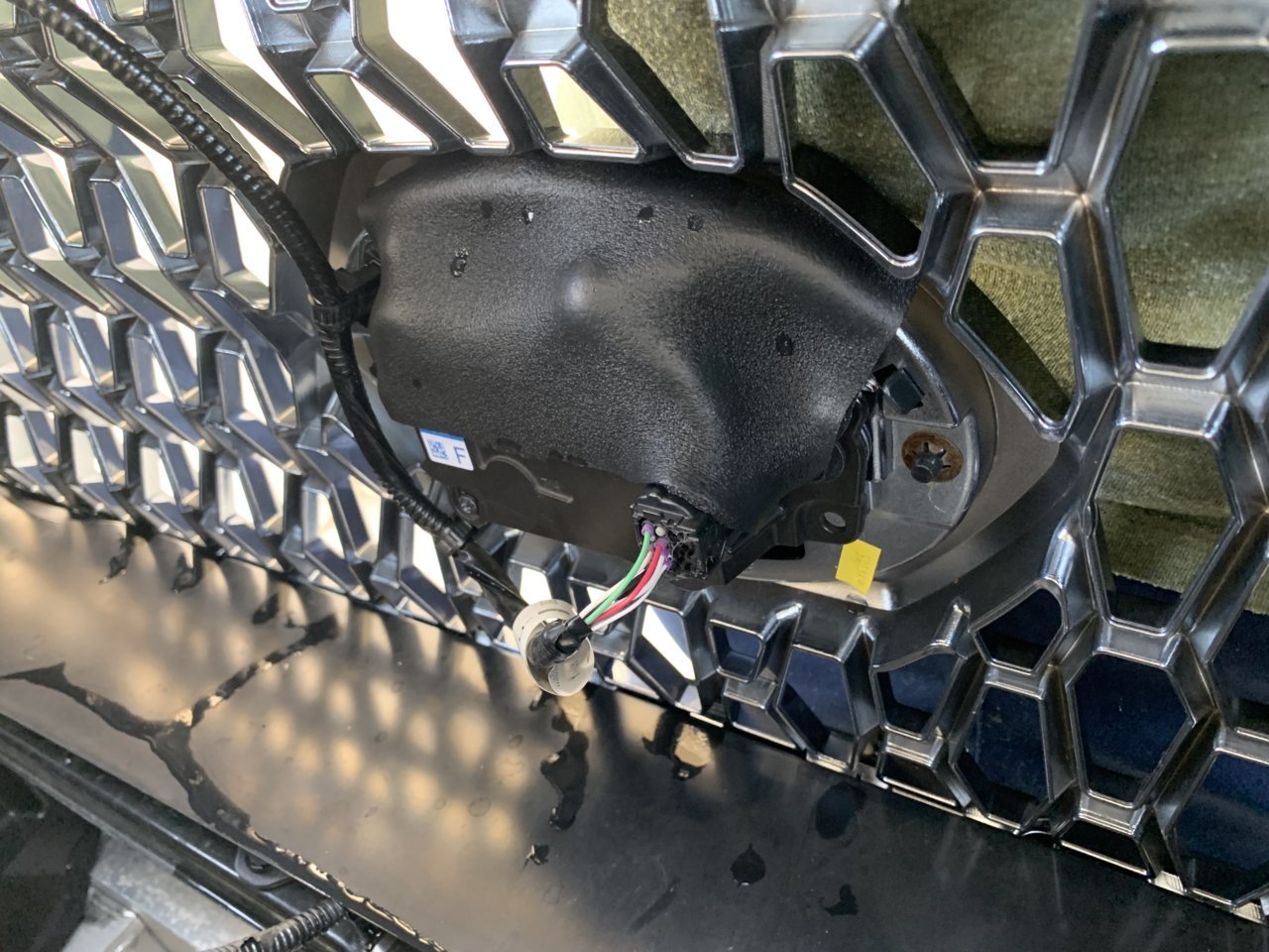

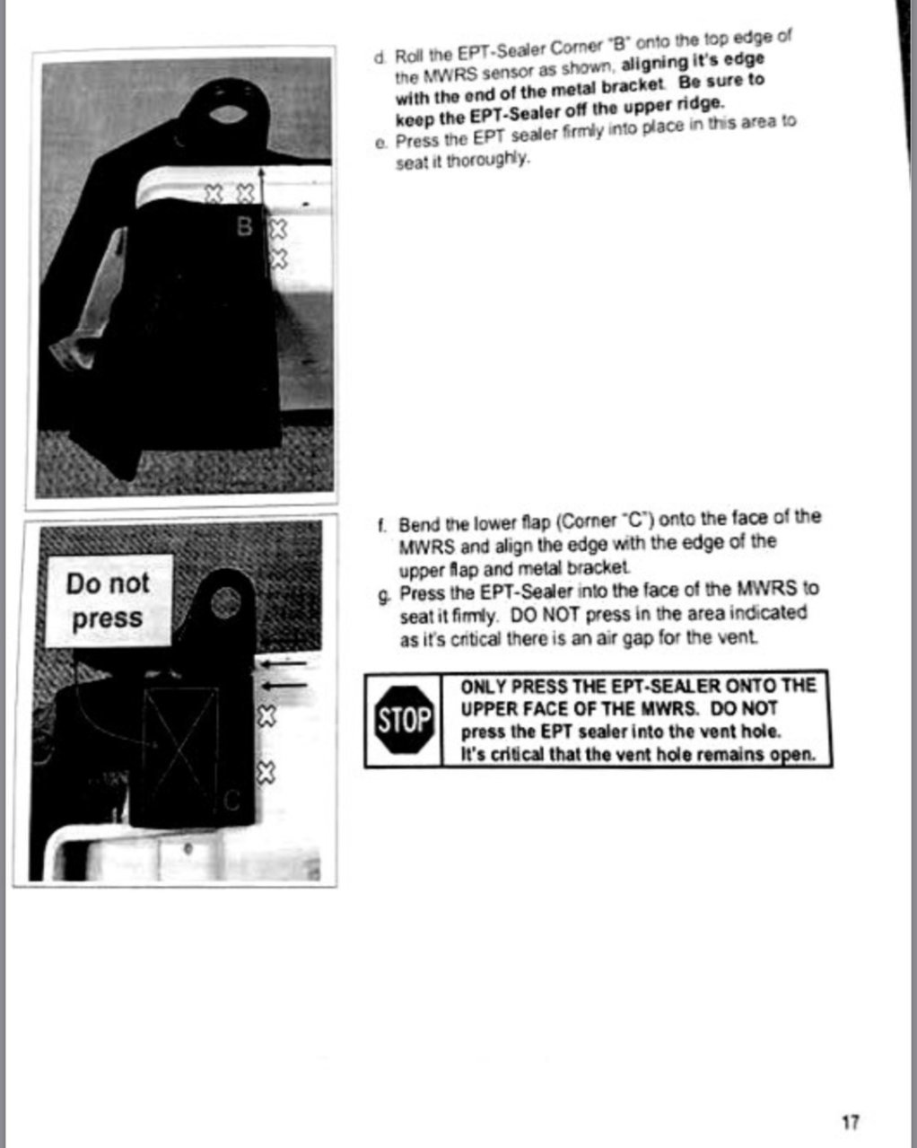

    So here’s my take on the recall. I use radar cruise control on my truck everyday. I won’t stop using it, and I also don’t want to automatically be at fault if it erroneously brakes and causes a collision. The “fix” might seem trivial, being that it’s essential a foam poncho, but TSS sensors were being affected by moisture to the point they were faulty/disabled.
    I let Toyota do the fix because now it’s documented and I can still use radar cruise and not have to worry if something goes wrong.
    One of my biggest reasons for waiting for the 2018 was the TSS. It makes driving long distances a breeze.
    I’ve attached pictures of the fix below. Sorry for the water droplets, I had just washed the car. Huh, I guess the poncho does work.

    '21 4R
    The actual procedures were posted on these forums in one of the many paged threads about this issue.
    Boils down to parking on a perfectly level surface, and putting a metal plate (triangle I believe) a specific height above the level ground, directly in the centerline of the vehicle a very specific distance in front of the grill. Then running the scantool (I wanna call it techstream, can't remember) calibration.
    Edit: also of course, there's a clear zone of anything around in front of the car.
    Edit2: except the metal calibration plate
