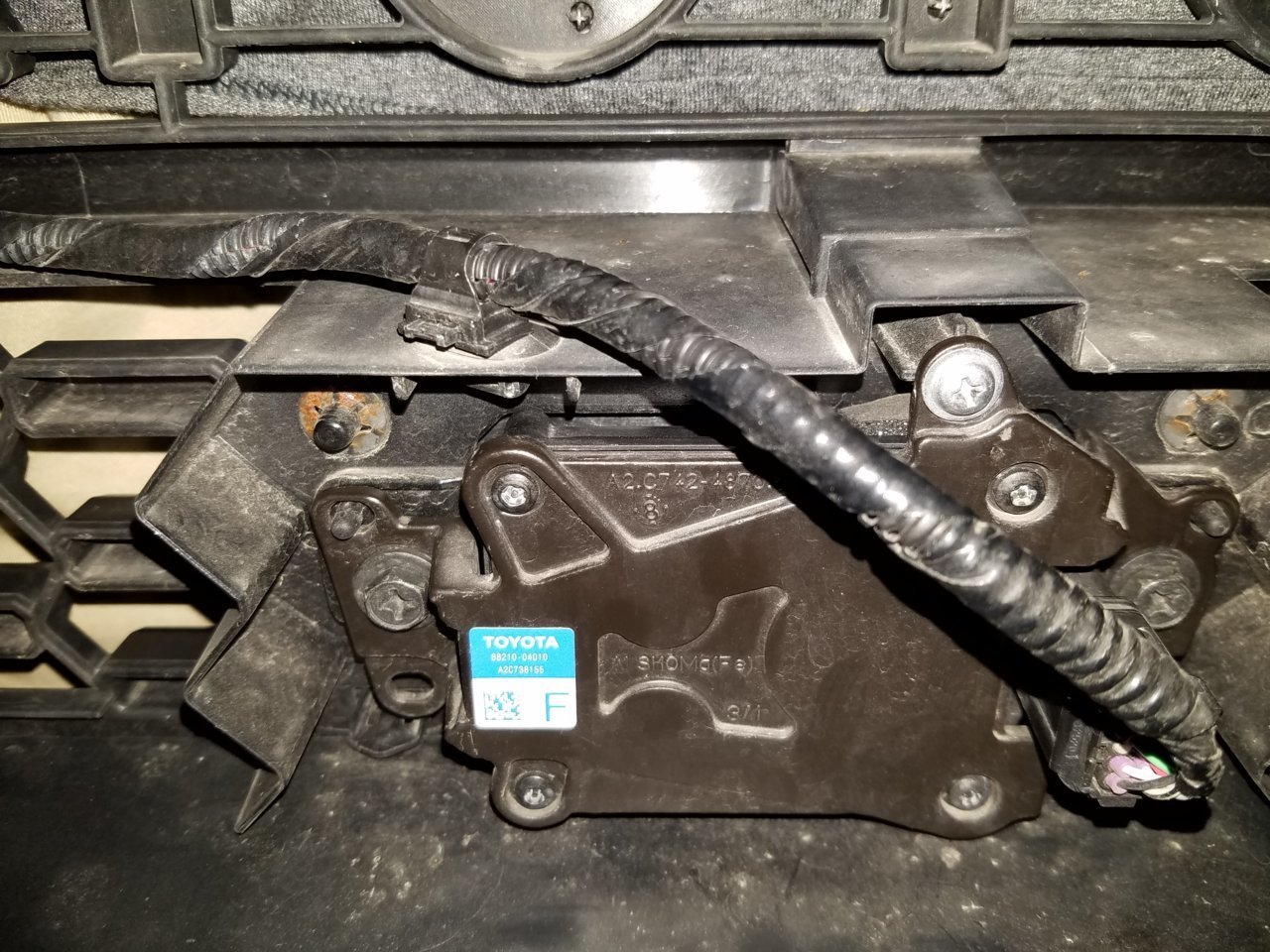

    I have a Toyota Pro grill, garnish and wiring harness. I went in for "Phase 1" of the recall last Friday where they inspected my truck. At first they said the recall only applied to trucks "with the round Toyota emblem". I told them to take another look and handed them my recall notice. They took the truck back to the shop and found the documentation regarding "unauthorized modifications" and presented me with the waiver to sign. They told me that they had to order the part and would call me when they came in. I received the call that the parts were in and took my truck to the dealer for "Phase 2" of the recall today. When I got the truck back, the paperwork said "Installed 88278-0C020, which from what I can tell, is the correct seal for the Pro grills. However, I don't see any evidence of the seal.TSS.jpg
    Is this what it looks like for others who have had the recall done with the Pro grill?

    The seal (which is just some foam pad) for the pro grilles goes between the sensor and grille. I can see it in your photo just below the top screw.

    OK - Thanks. From what I saw in Post #208, it looked like my sensor didn't have the vent holes and required the foam to be wrapped around somehow. Kind of hard to see in the scanned document.
    Update: I went out and looked at it more closely - there is definitely foam wrapped around near the upper screw. Thanks, KY-Rob

    I believe for people with the pro grill they actually seal outside the grill. The piece you have to take off to change out the grill.
