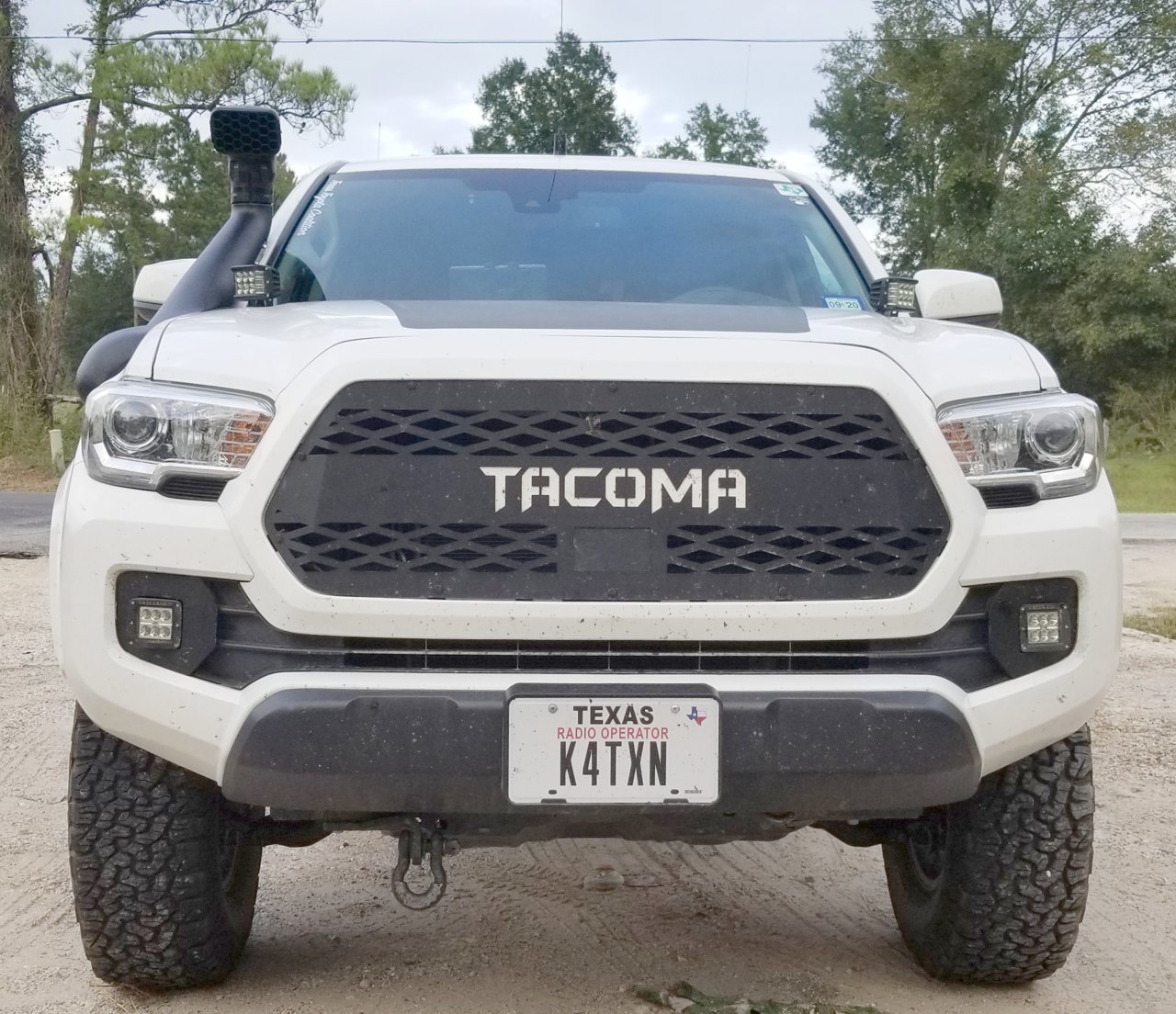

    My dealership did mine in July, after the tech took some measurements. Without signing anything.
    2015 DCSB SR5 4X4
    Empyre Offroad Grill (TSS ready)
    3" OME lift from Headstrong Offroad
    The original OEM grill mounted the sensor high in the grill. The Empyre offroad mounts it low. With the lift, it put it within spec, as the technician measured it. Got the TSB applied as is. No special agreement signed.
    The sensor is below the "CO". Please don't mind the bug spatter!
