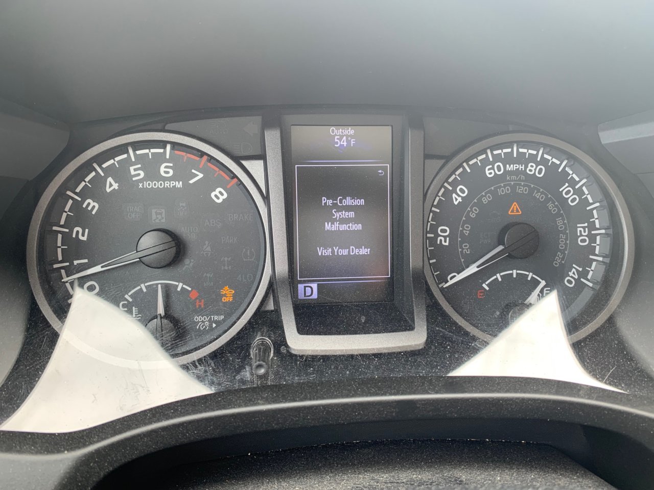

    I think the pro sensor went in with the pro grill originally because it is mounted in a slightly different location than the OR sensor. I asked if we could
    just use the OR sensor instead but he was sure that was going to be the same problem, with the truck's computer thinking there is a malfunction when it
    can't be calibrated because it's in the wrong spot corresponding to the pro grill. OR sensor will work with OR stock grill of course, but I'm happy with my
    PRO grill after it worked fine for like 15 months until this shit happened because of the recall.

    I would have them get a OffRoad/Sport radar sensor off the lot & try it out. I'm confident your problems will go away.
    I have a Pro grille with the original Sport sensor & a piece of Kydex plastic in front of the sensor to protect it. I don't have the shinny garnish cover just the 2016/2017 grille insert & I have tested thoroughly that everything is functioning properly.
    Dealership service depts are not paid to think outside the box. They are basically told what to do. It sounds like they are willing to work with you so see if they will atleast try to pull a sensor off the lot. If everything works have them get you one. For $700 out of your pocket I think it's the least they could do to make things right & driveable.

    Had my 10k service the other day and the dealer said they could not perform the radar sensor re calibration because I had a Pro grill. Oh well. The TSS works fine and never gives me errors.

    I think many of us can vouch for the off road sensor working just fine with the pro grill. I wonder if that sensor change isn't part of your problem.

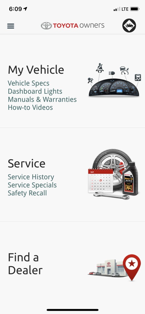

    Feeling really late to the party, but what is the recall and how do I find out if it applies to my truck?
    (2019 DCLB TRD OR, had it since ~Feb.)

    Get the Toyota owners app and you can see if it affects your vehicle. Go to the service section and choose “Safety Recall”.
