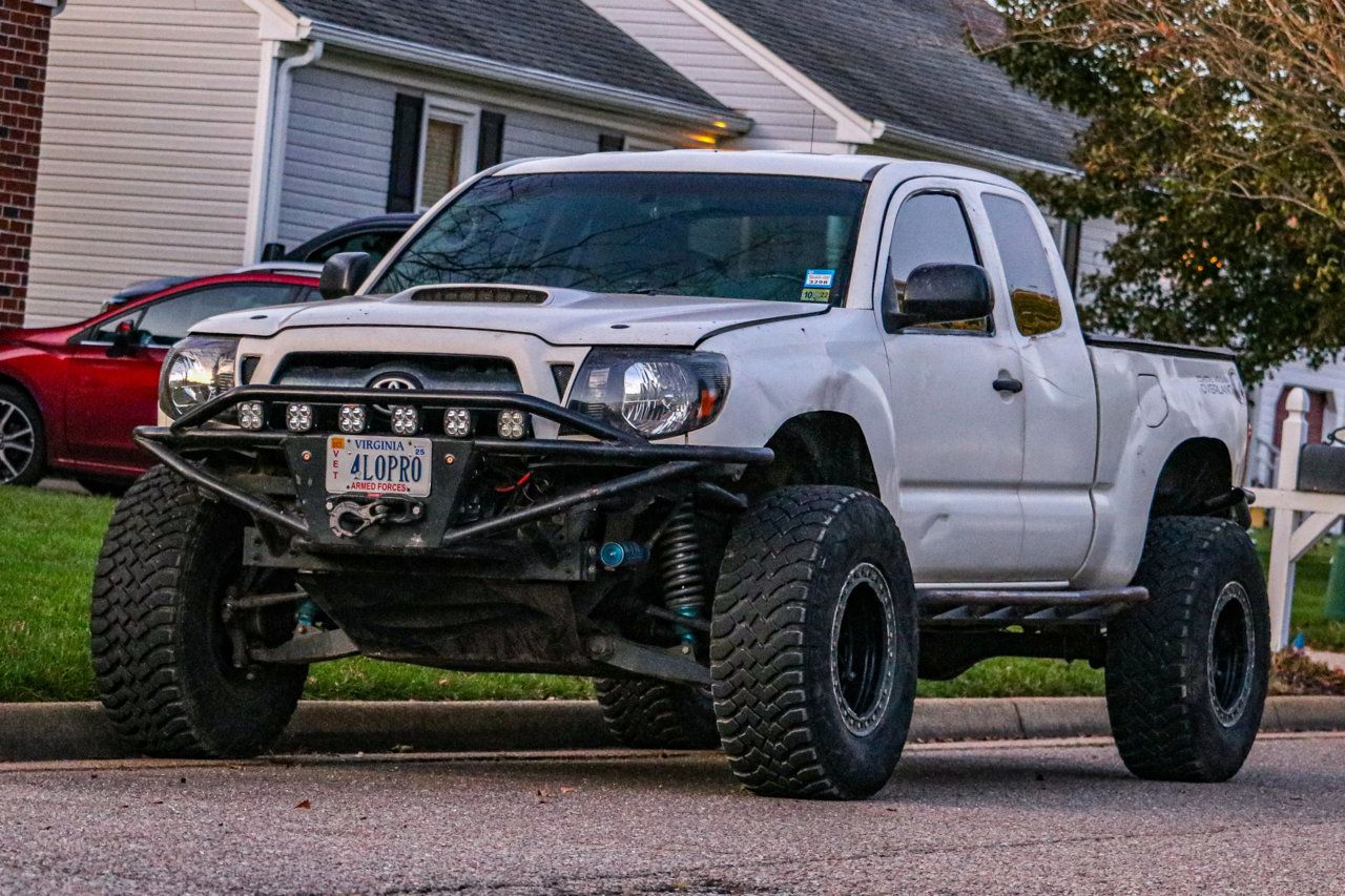

    @EatSleepTacos 's bumper is a great example of what I'm going for.

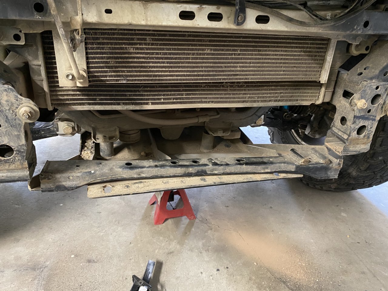

    Not really, I tried that. It’s rectangular and it was gonna interfere with the radiator. Some 2” square tube was perfect.
    You can kinda see here how the outer parts of the crossmember are much larger than the rest for some reason.

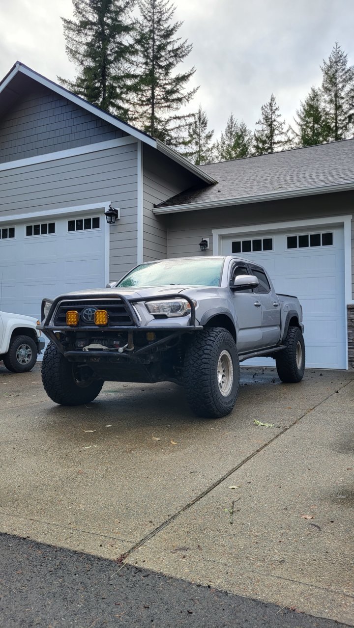

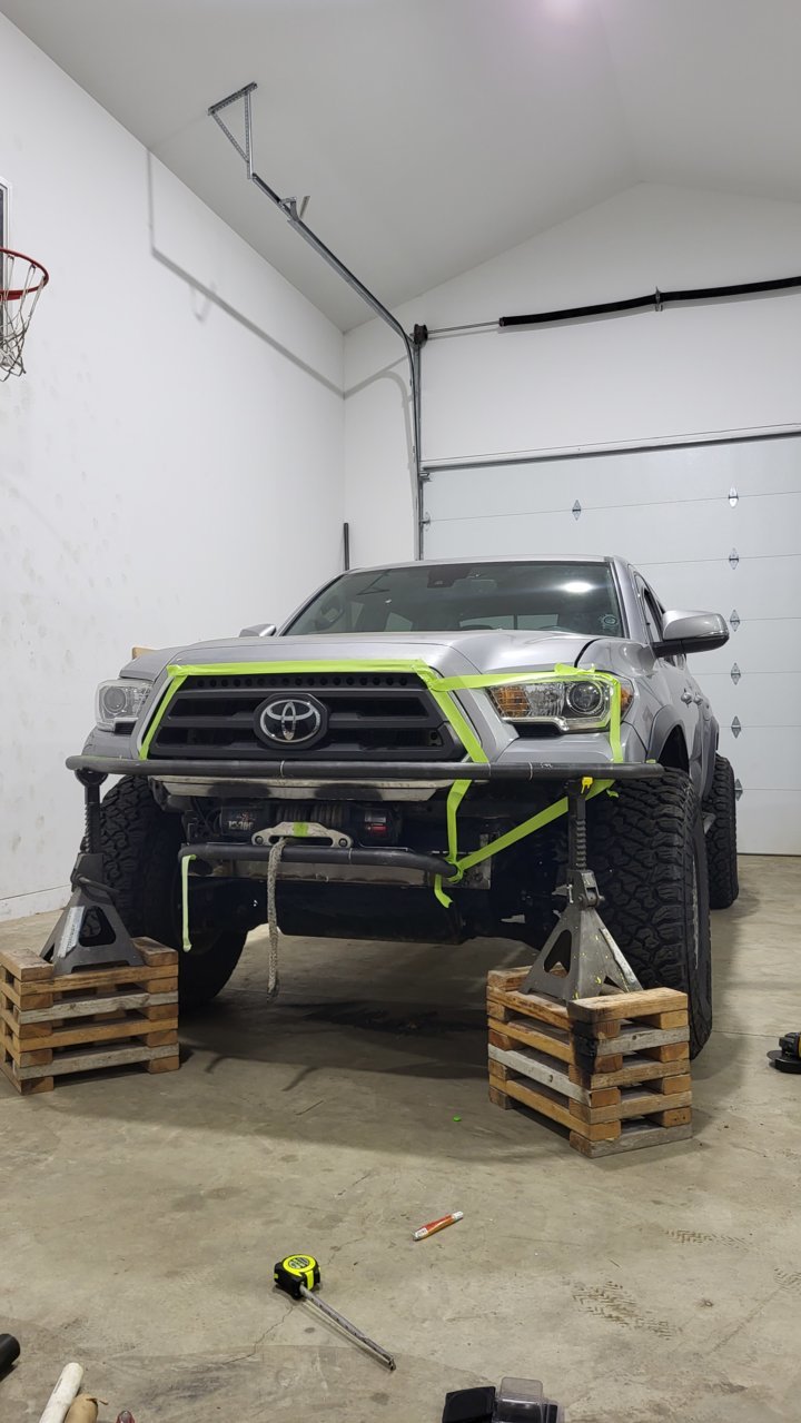

    Heres my front bumper I just made.
    Grille/under headlight chopped up about 2.5" higher than the normal bumper cut.
    Winch feet are same height as the top of the frame, could've tucked the winch higher but didnt want much more leverage while winching. Used a Habor Freight winch tray as a starting point.
    Fairlead is tucked in from the tube, didnt want the fairlead/winch hook sticking out like a sore thumb like my old bumper. Too catchy on things.
    Crossmember chop, frame sleeved and plated, mounts welded solid, something like 13 bolts total holding it on in 3 different planes.
    Bottom tube under winch is angled up to have a half decent angle leading into the skid.

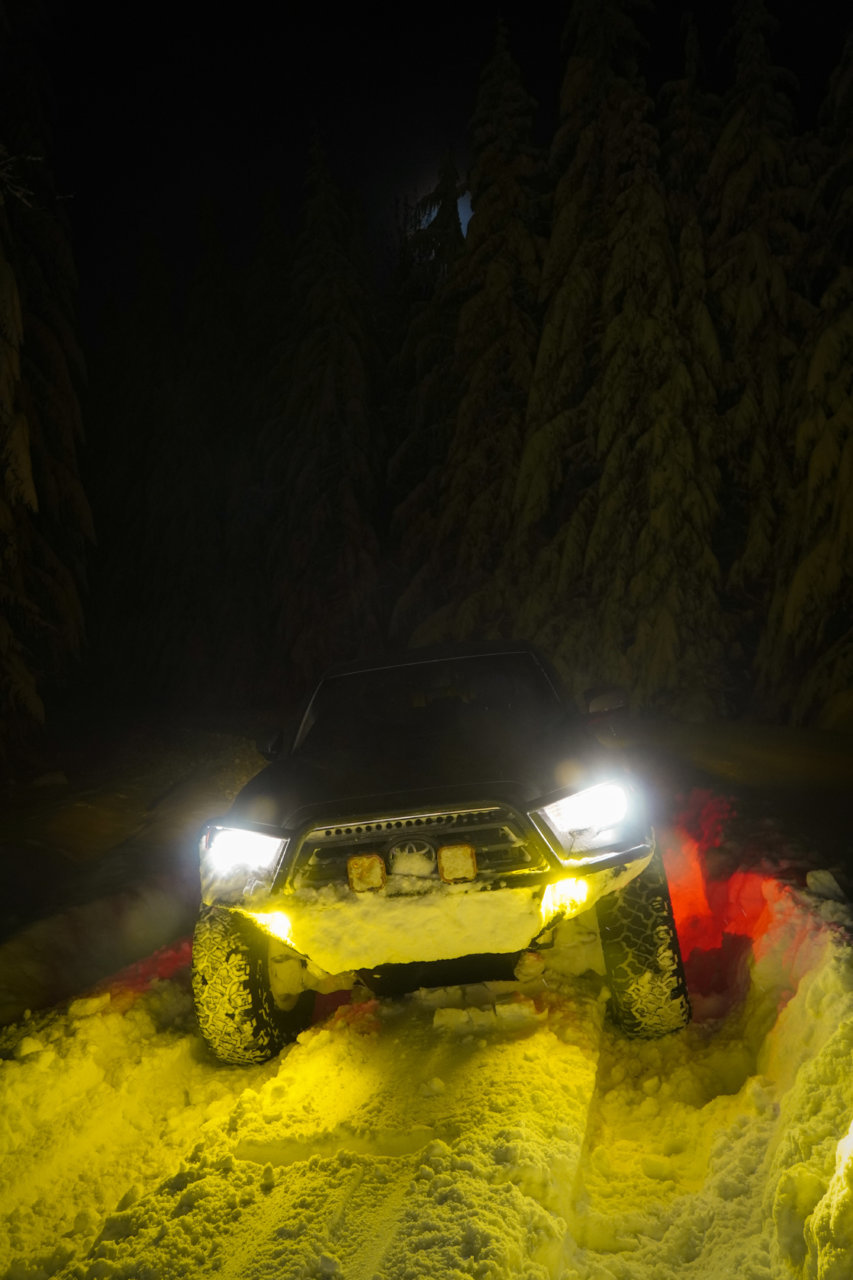

    Going to skid under the winch with plate, and plate the front center section with thin aluminum plate to keep snow from packing the winch to useless, forzen block of ice. (Ask me how I found out).

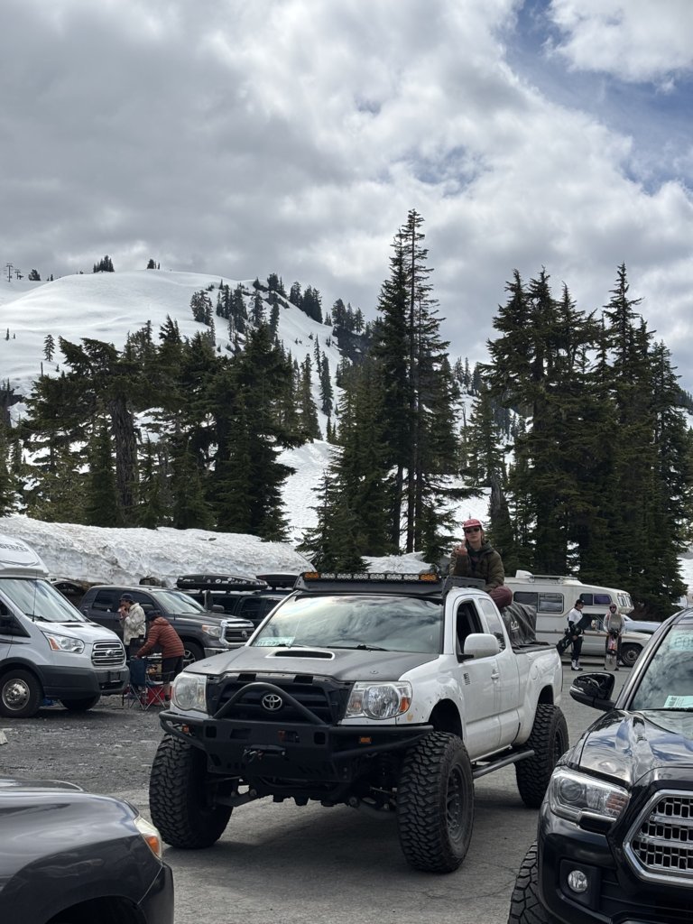

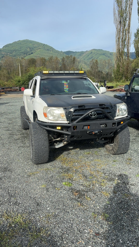

    Figured I’d update this incase people come a lookin, just got around to my bumper.

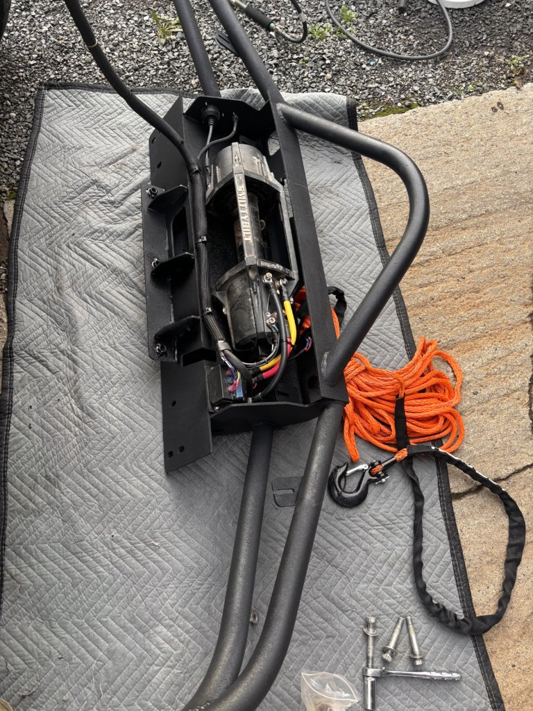

    Did you build this bumper? Or buy one? If ya bought it what is it? I like this style..
  16. May 29, 2025 at 2:57 PM
    #16
    Forrest30419
    Forrest30419 [OP] Member
    Jan 6, 2022
    #386510
    13
    Forrest
    Bellingham WA
    White 2006 TRD sport ACLB 4.0 6speed MT
    Geared 4.56, air locked, 35s, Icon/TC mid travel,
    IMG_3638.jpg IMG_0316.jpg Both, it’s a costal off-road high clearance plate bumper I modified a good bit then made the tube sections myself. The cross member is cut out and moved up and I plated my frame horns. I also put a battery tender plug winch remote plug and winch wireless switch on it.
    she looks a lot better with an alignment and fresh rubber too
