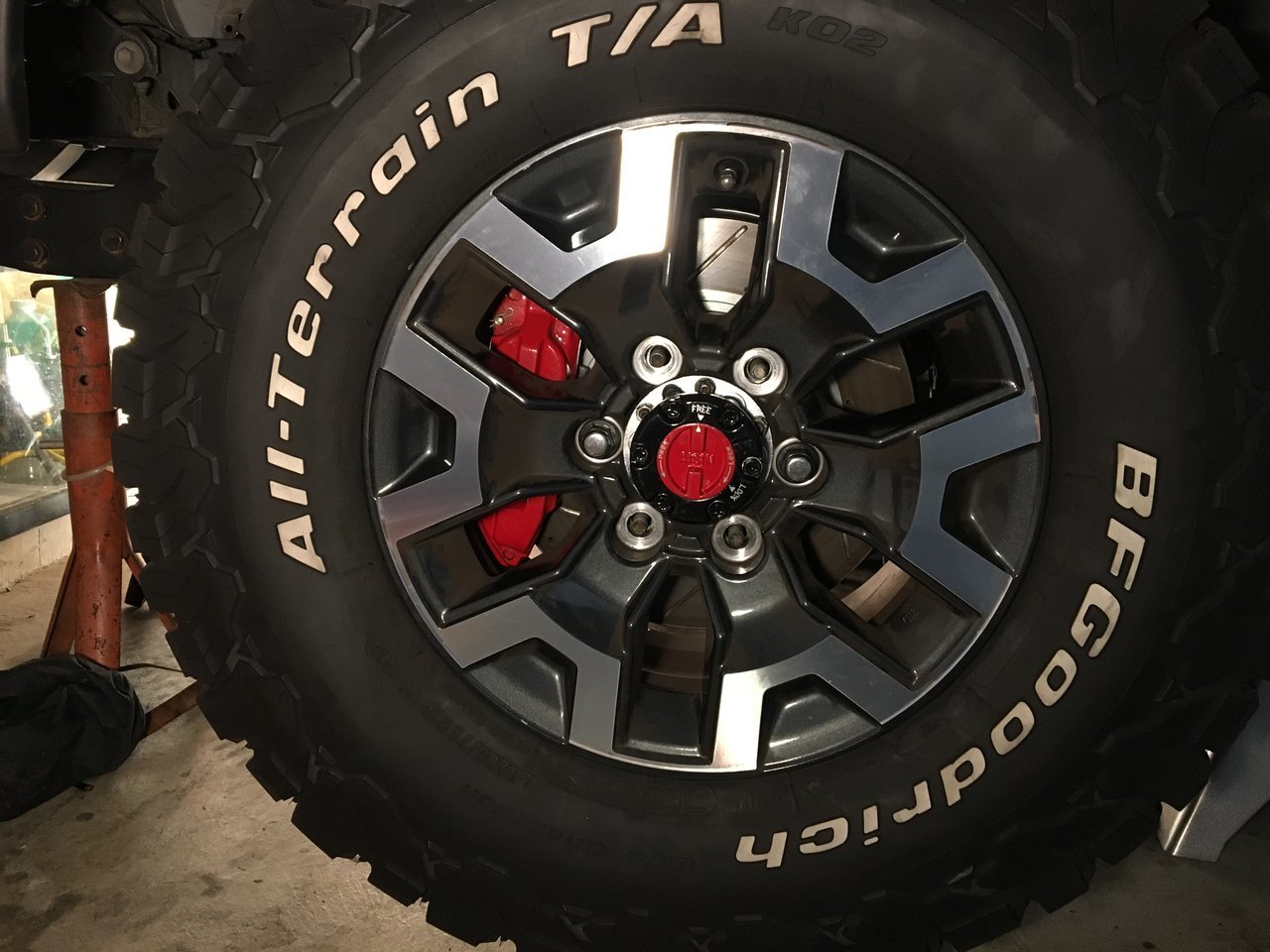

    You don't want the S13WE they're a lot smaller than the 13WL.
    I bought Toyota 3rd Gen TRD Off-Road Wheels to fit. They fit the 13WL and my AISIN Manual Hubs no problem. No spacers required.
    I have rubbing at full lock but that's because I run a larger tire (LT265/75R16) than the stock 3rd gen tire which has an aspect ratio of 70 on the stock suspension and height. There is slight rubbing on the UCA and 1.25/75 spacers make the rubbing worse. You don't notice it unless you're making very tight turns. If you ran the stock size tire you most likely won't encounter rubbing.

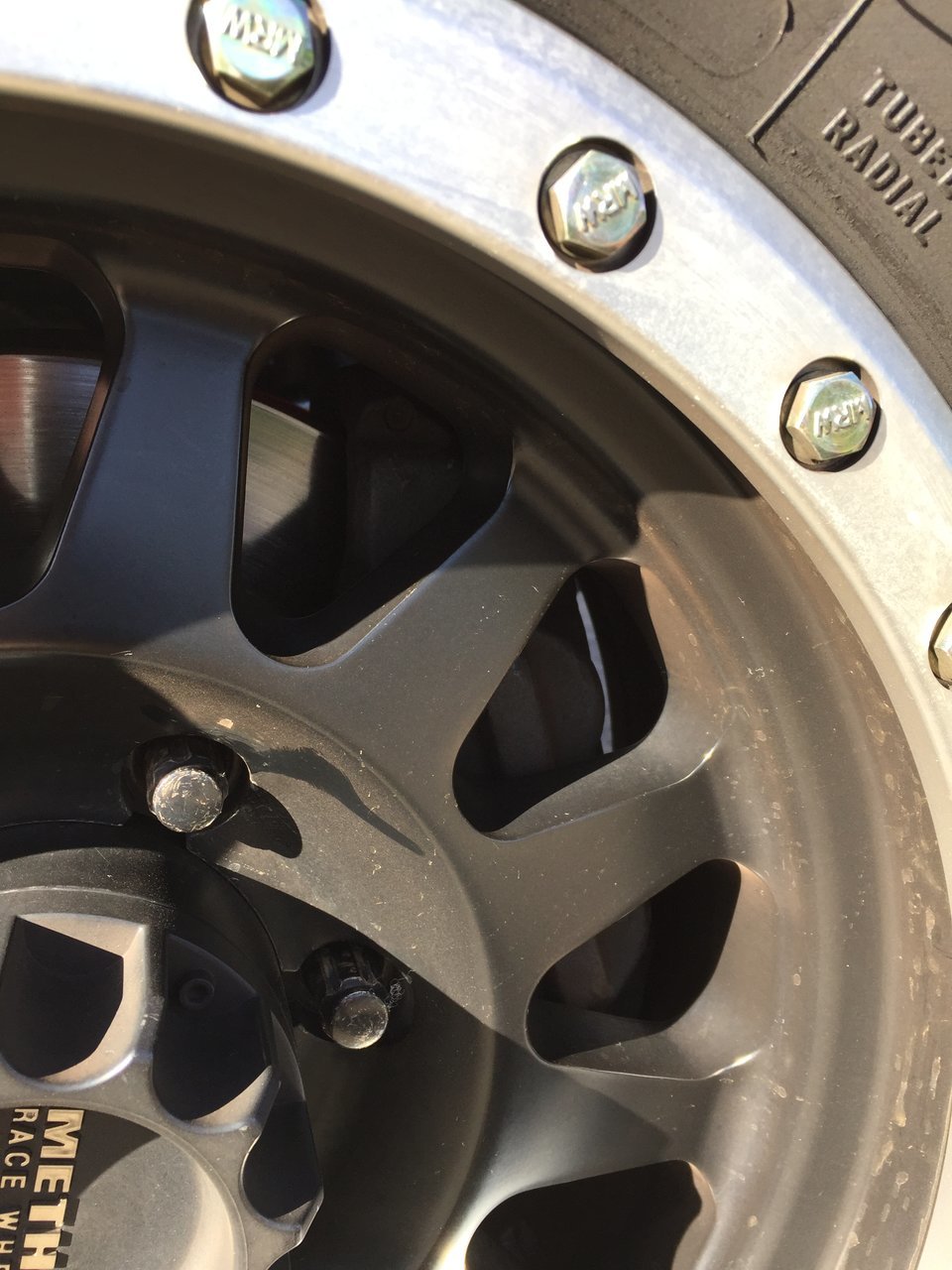

    I have Method double standards that are 16x8 with 0 offset and 4.5" BS. With the OEM Tundra 13WL Calipers off of an 06 Toyota Tundra. And they don't rub at all. Great stopping power like mentioned above.

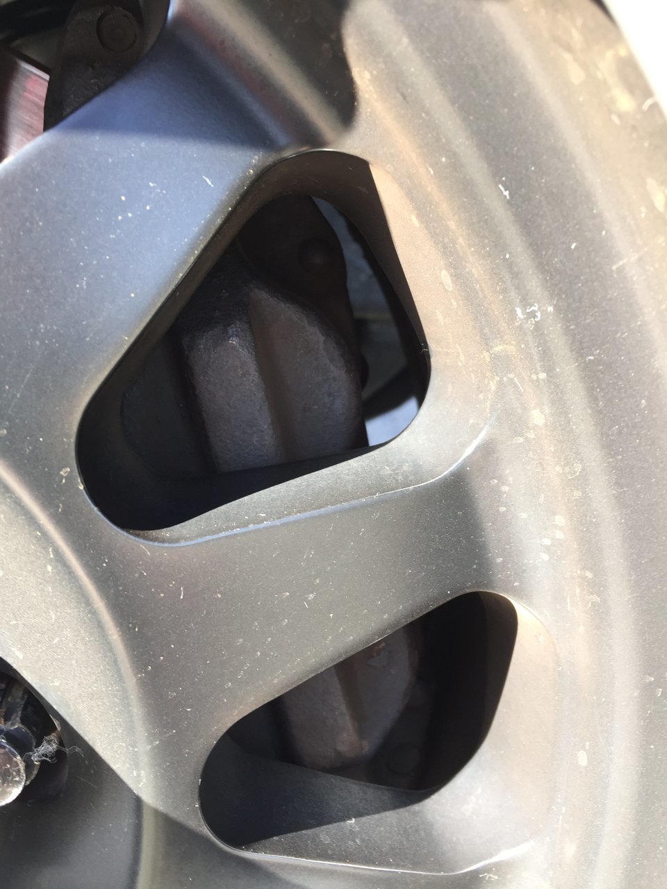

    I'm running stock 16x7 snowflake wheel with 13wl's

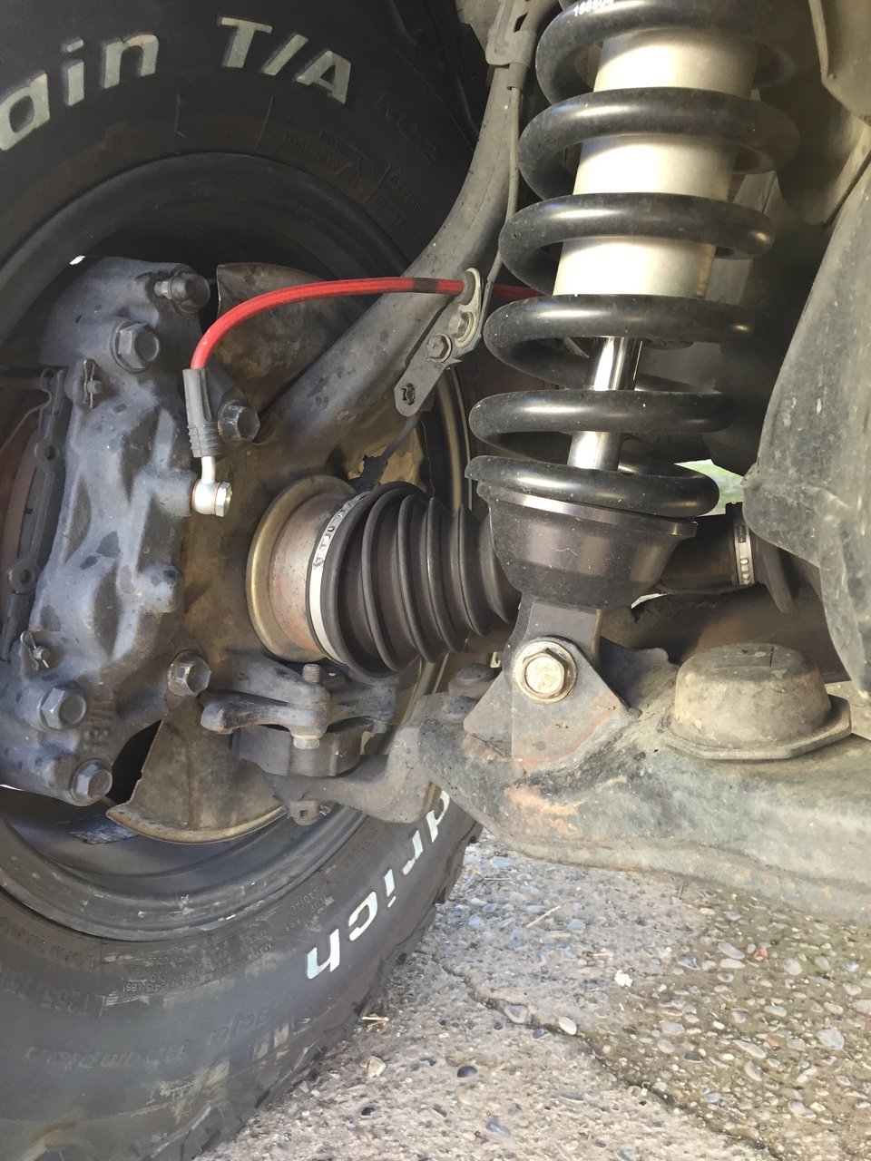

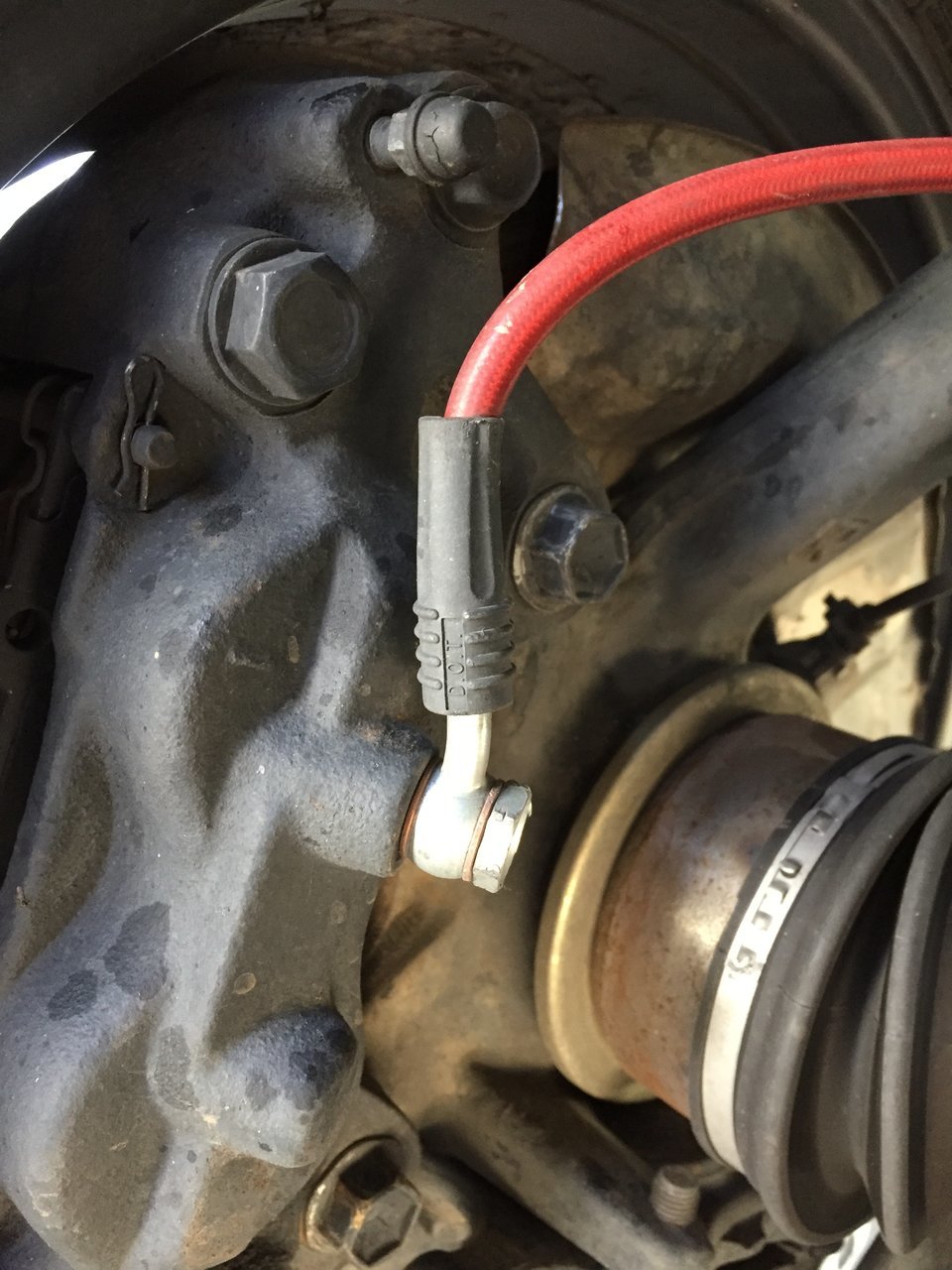

    So does a 16" rim with your tires fit in the spare tire location? Or is it too big??
    You think I would need spacers with the stock tires that came on these rims 265/70R16,
    Can you post a photo of the back of the caliber with the hoses?

    I haven't tried putting a spare on yet I still have the original 15" steelie under there.
    But 1st gens had the option of using a 16" wheel so I assume it will fit.
    Let me find a pic.
