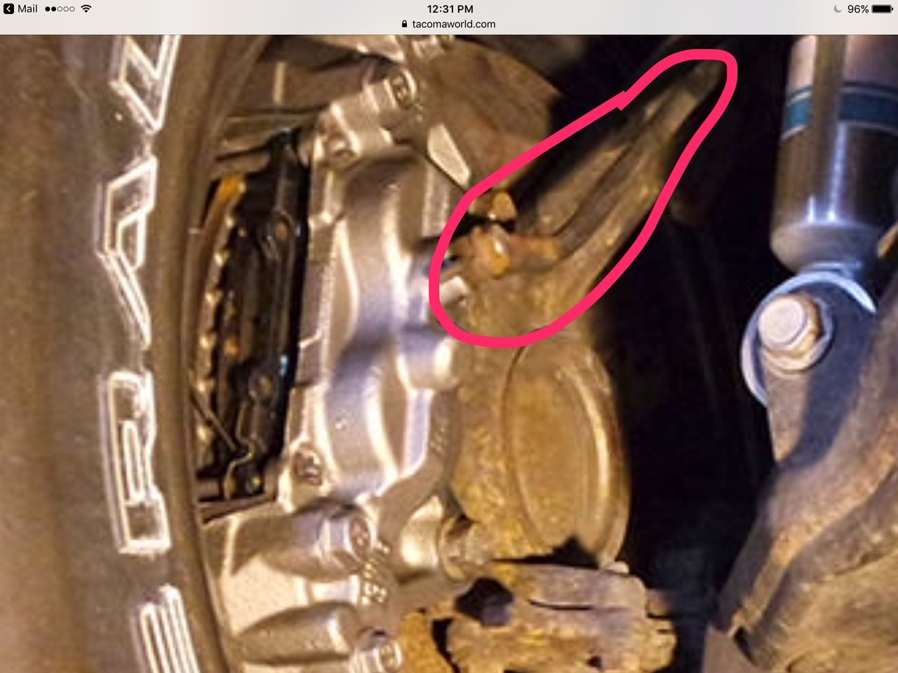

    yeah or you could get wheelers stainless lines for 1st gen tacomas. You still by the sounds of it have to modify the bolt.

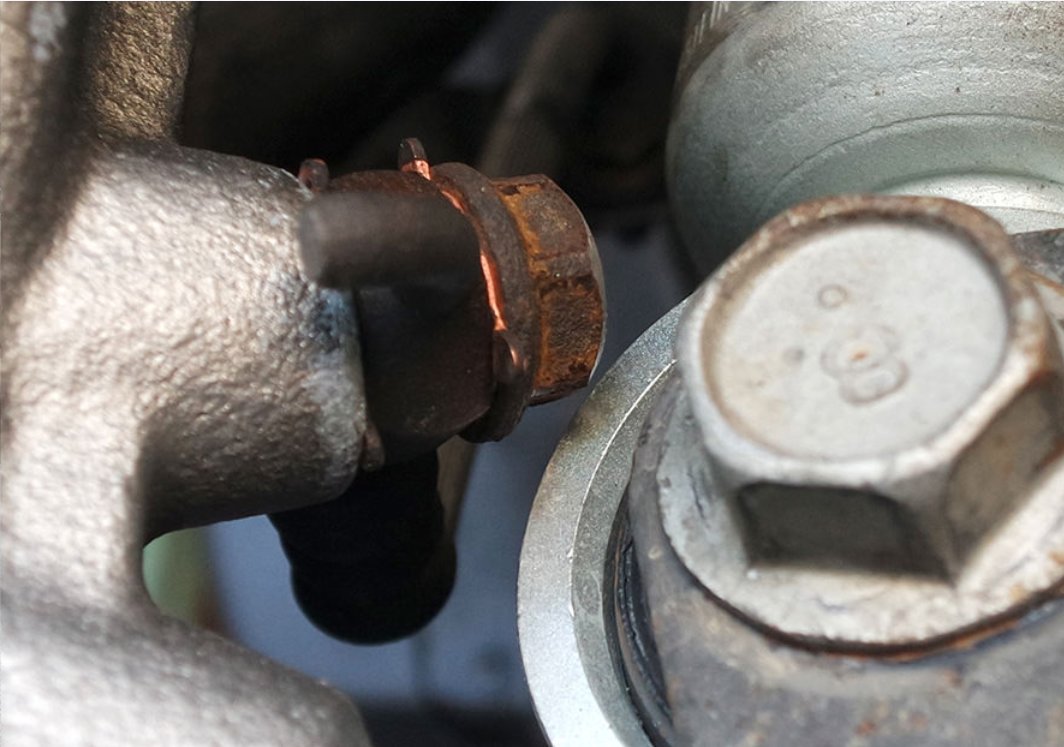

    Yeah, looks like he did. You can see even in this picture that he's got the stock 1st gen banjo on there.
    ...here's the first gen brake line, next to a Wheeler's line, where you can see that weird indexing "beak" visible above.

    Yes stock line and bolt. I was fully aware people are buying Wheeler lines when doing the Tundra mod and I originally intended to go that way. This pair of calipers came up locally for too good of a price for me to pass up so I picked them up after seeing the minimal differences between it and the 13WL, I do have a mill so I figured if they didn't work I'd just mill my own holes.
    Stock 1st gen line worked just fine, I could have milled off the "hook ends" but I figured just get it on there and monitor to decide if I'll need aftermarket lines or not. I'm the kind of person who prefers doing modifications myself and turning the Banjo bolt took less than 2 minutes on my lathe. Everything worked well with no leaks so I moved onto modifying my UCA.
    Maybe when next brake fluid flush ill take the lines off and get rid of the "hooks".

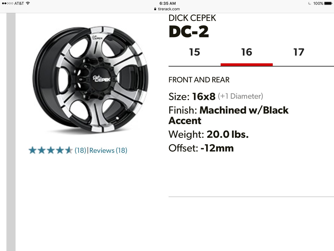

    Anyone running or know if Dick Cepek 16" rims will work using tundra calipers, brakes?
    Back space is 4"

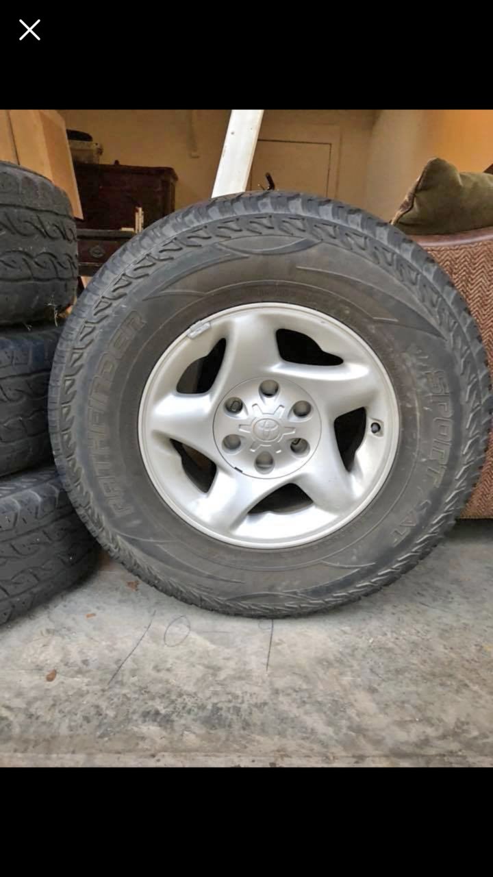

    So just to clarify...is this the wheel referred to as the “snow flake” wheel, and it does clear the 13WL calipers? FF380A1C-4AED-4004-B00B-BCB5D1B5B471.jpg

    Yes and Yes. Look at the center cap to answer your question as to why they’re called Snowflake wheels.

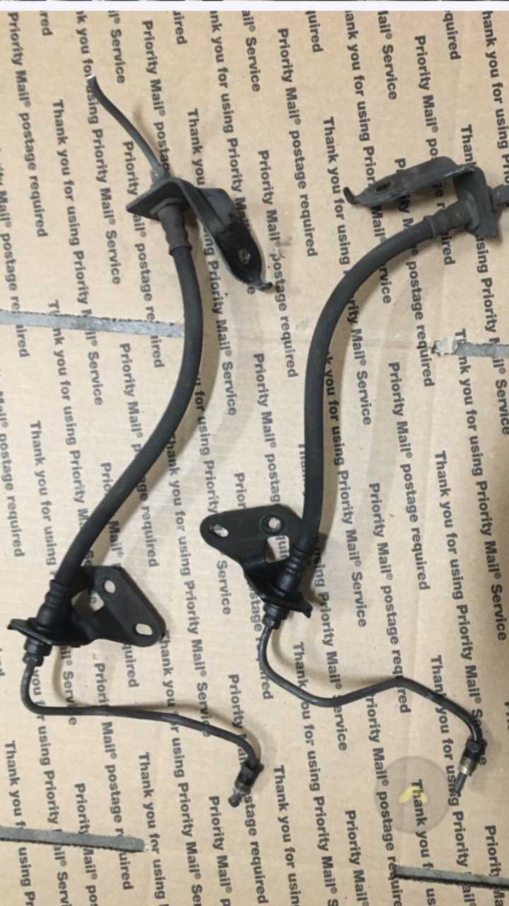

    Make sure you get the entire brake lines too. Up to the frame where the 'C' clip is.

    Yes.
    Funny you used that picture, because I took it. :rofl:
  19. Aug 14, 2018 at 9:04 PM
