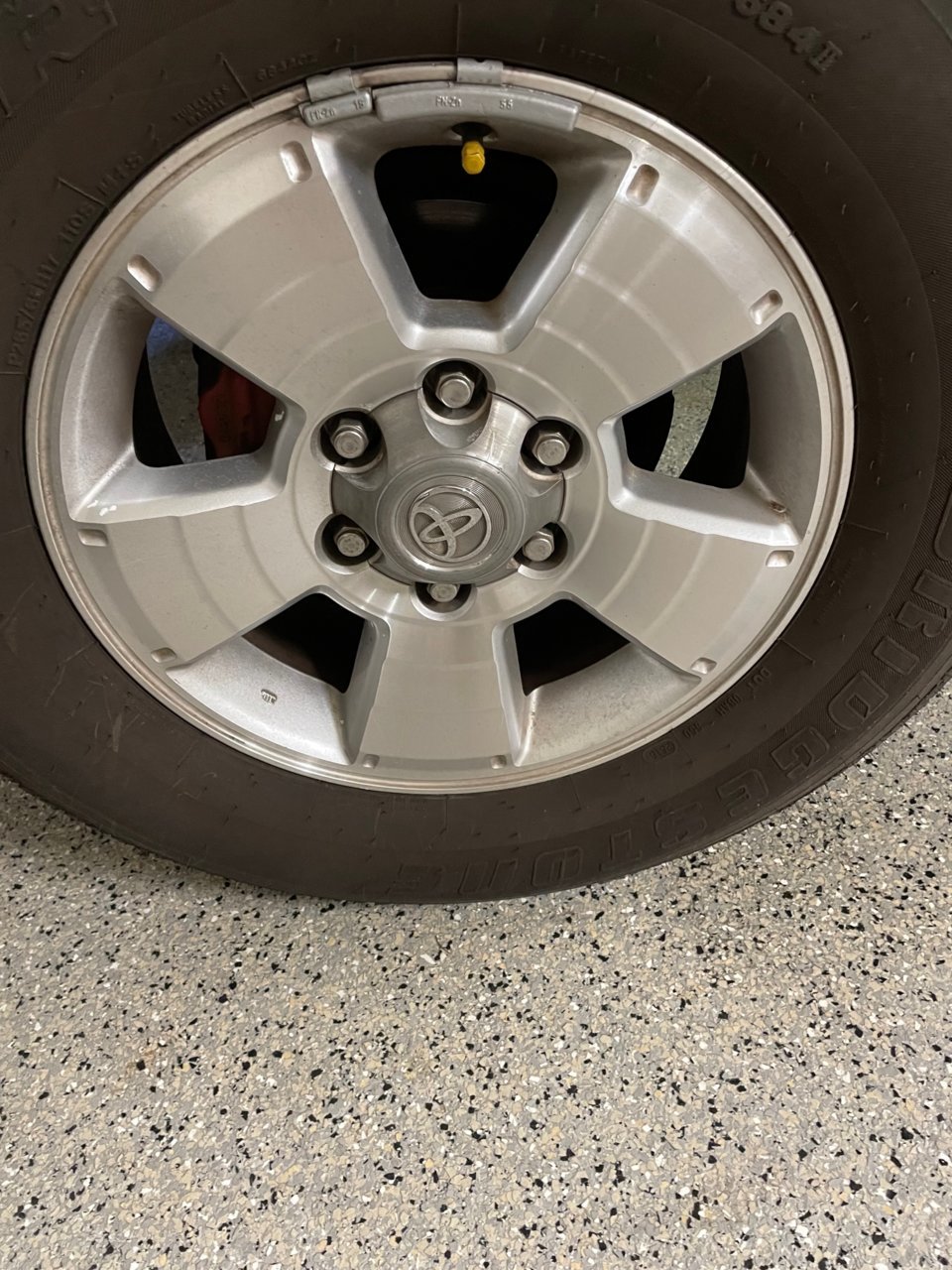

    Hi,
    I checked through the list of wheels that'd fit the 13WL and I didn't see these. I picked these up right after I bought my 95 4x4 and I'm pretty sure these were standard on the TRD Tacomas in the late 90's early 2000's. They're 17's. Anyone running he 13WL's with them ? TIA
    Thanks!

    Those will be fine since they are 17s. 16s are the place where you can run into trouble, which is why the list focuses on them (assuming you mean this list: https://adventuretaco.com/which-wheels-fit-the-tundra-brake-upgrade-on-a-tacoma/).
    Perhaps I should add them just for completeness, since they are a relatively common Toyota wheel.
    The one thing you may run into with those wheels is that they have more backspacing that stock 1st gen Tacoma wheels, so you may find that you need to run a spacer in order to push your tire off of the upper control arm (depending on the tire size/width). Note: Tundra brakes won't affect that at all, it's just worth noting.

    Those would be 2nd Gen TRD OR wheels I believe. Would’ve been 2005 onwards.

    Thanks both of you for the info !

    TRD Sport* :D
    OR are 16s

    Yep that’s what it is haha thanks
