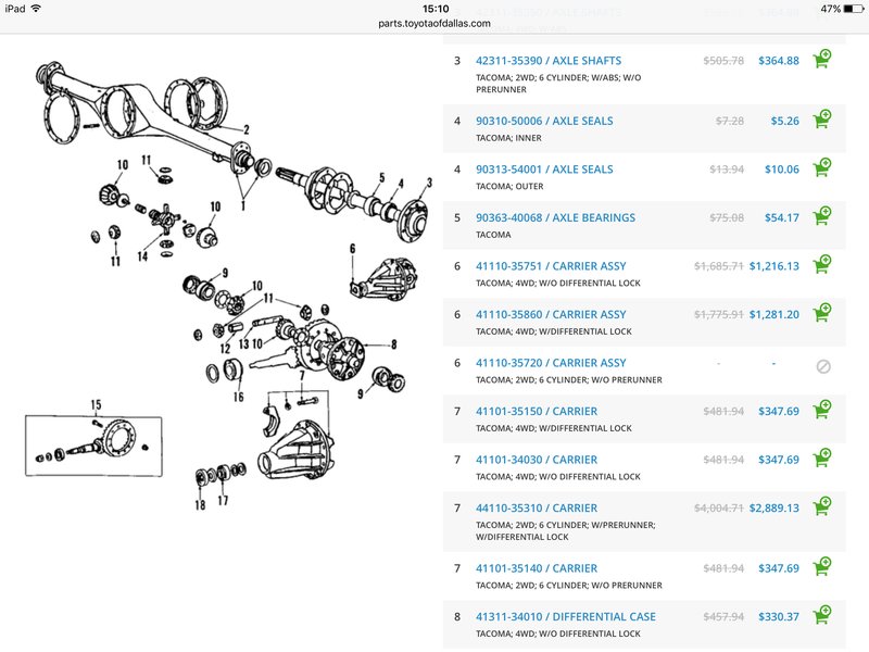

    Yeah. I don't know why I usually refer to it as an axle bearing. Probably because the axle runs through it and it just makes more sense to me.
    The parts sites have a couple different diagrams but they either call it a "bearing" or an "axle bearing" from what I've seen. It's part #5 in this diagram.
