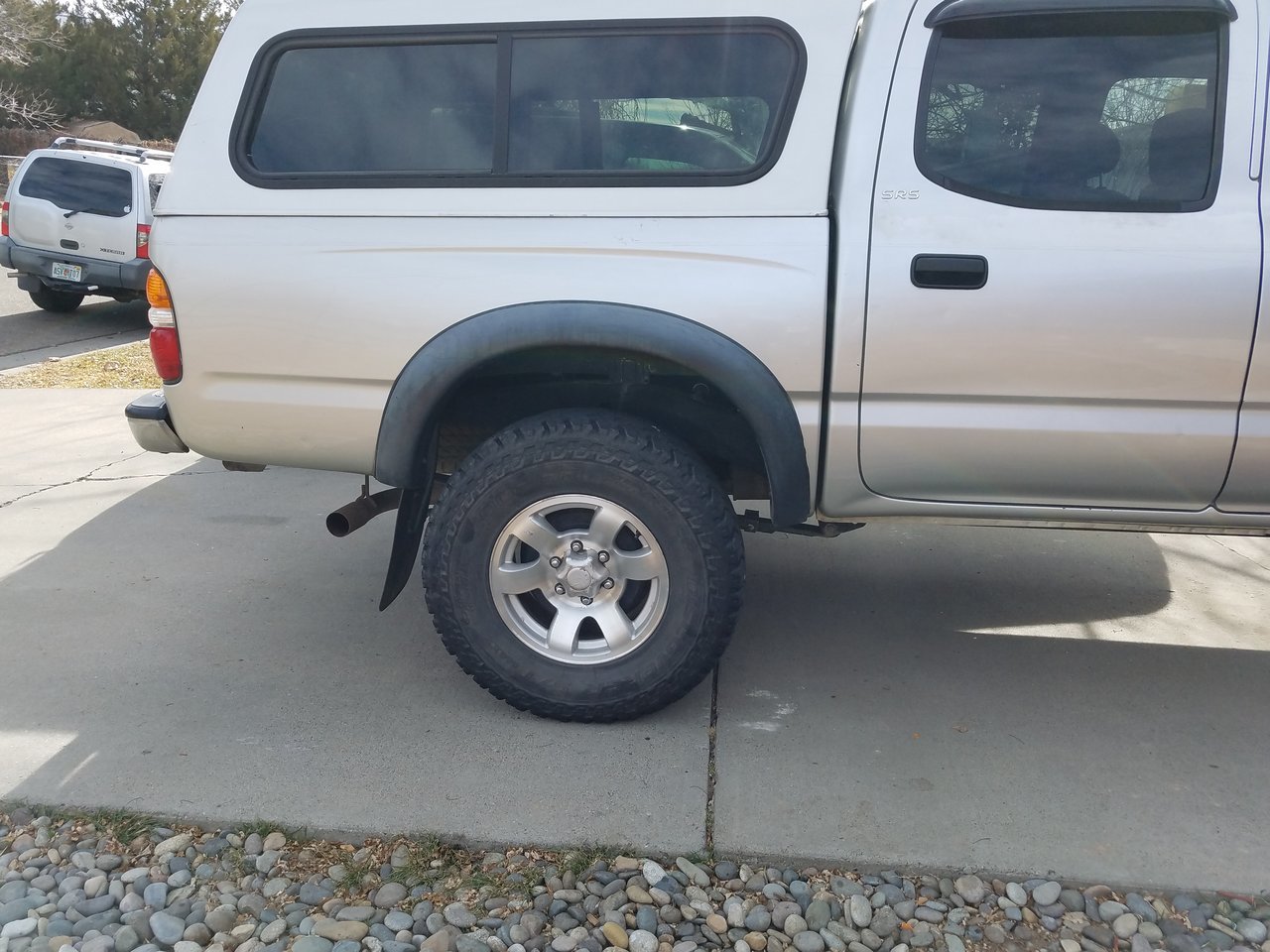

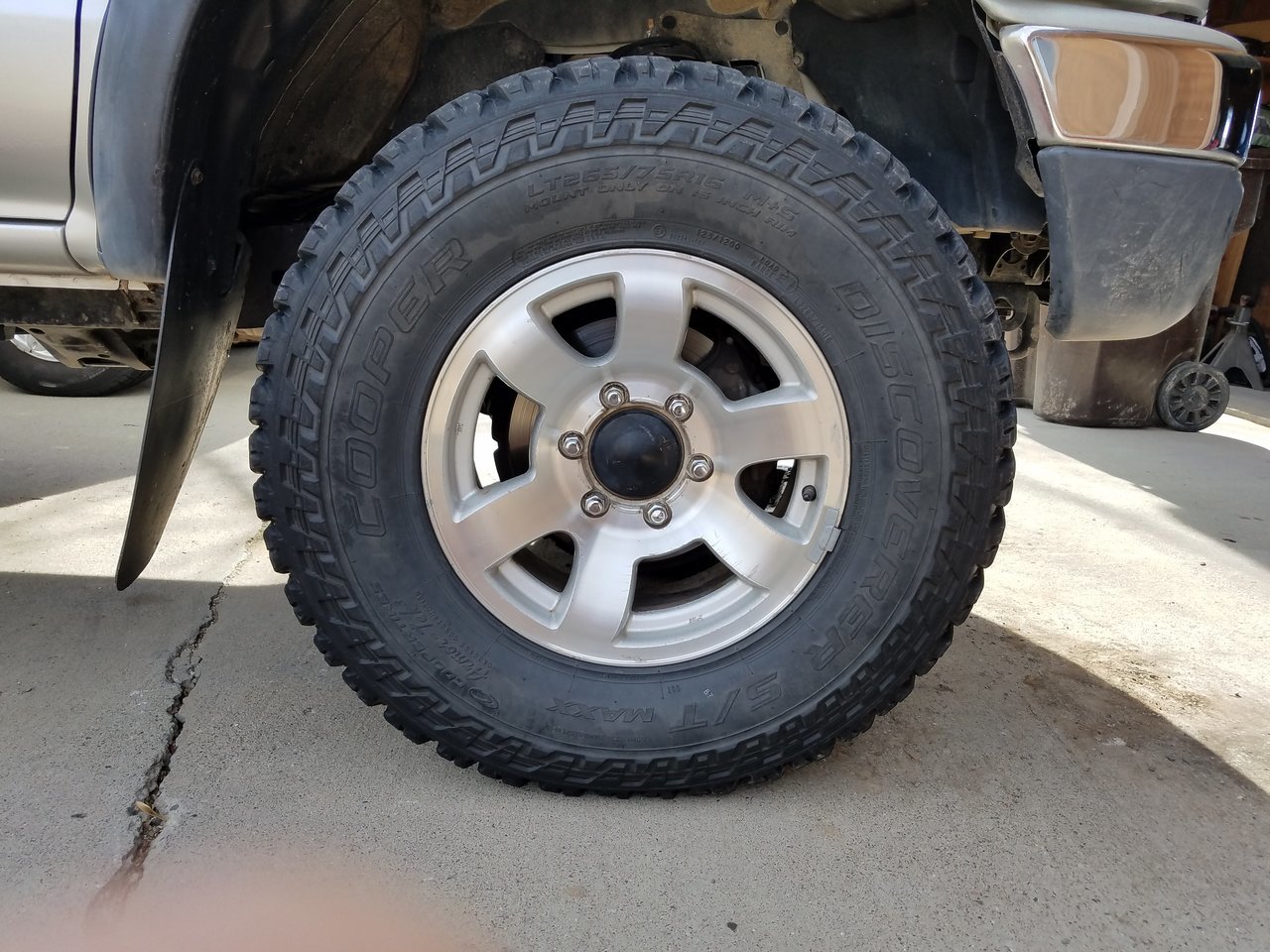

    Hey everyone. Long time lurker decided to finally register. Anyways I've been around Toyotas for a long time. I currently have an 01 DC 4x4. It's been a while since i've been in this platform and I've had this truck for about 8 months. Anyhow I am going to do the 231mm tundra brakes (which i've done on a previous 3rd gen 4runner) so I'm clear there. I have searched and searched and I cannot find any info on my wheels. My truck came with what I believe are stock wheels but I cannot find any pics anywhere confirming. They had Toyota center caps and appear to be a stock wheel. So my question is does anyone have any info on these and know whether or not they will clear calipers without spacers? I'm not afraid to grind the calipers down some to clear. Just want to keep this truck simple and not a fan of spacers. Any help would be greatly appreciated. Thanks, Robert

    Have you seen this wheels before? I have seen some that are similar on the 3rd gen 4runners but I cannot seem to find any specs on this exact wheel other than it is a 16x7.

    Those wheels may be toyota wheels but they certainly were not stock for the '01 Tacoma models

    Yeah that's what I thought.
